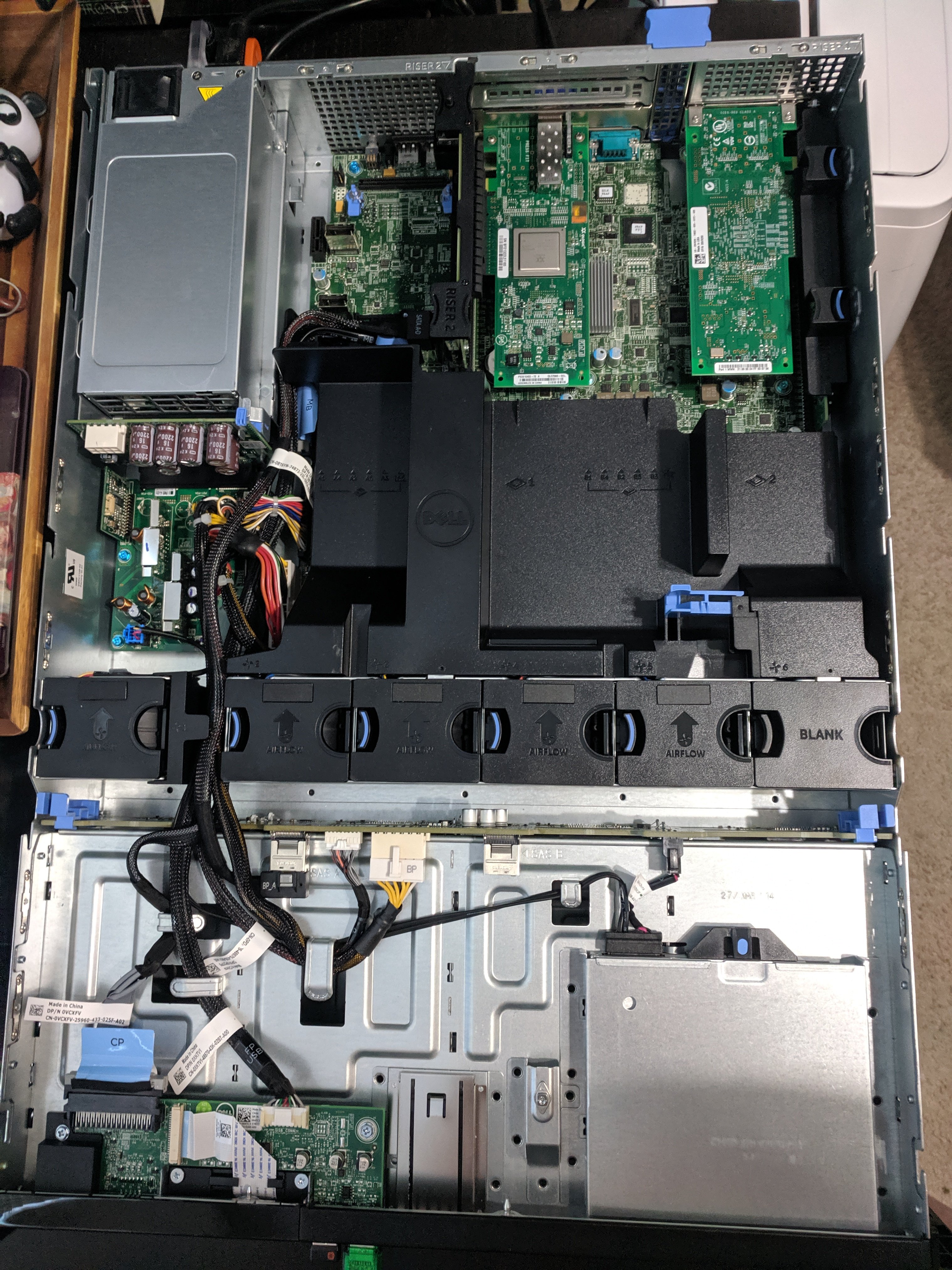

I am new to unraid. Just booted to the OS for the first time tonight. I recently acquired a Dell r520 from a 'friend' and had a few questions running unraid.
1. The perc was removed from the server. I have the bios set to run ahci (not raid mode). Can I just add nas drives to the caddys --> the backplane then configure those in unraid OR do I need to buy myself a raid controller? I am familiar with how unraid works and the fact that you DO NOT need a raid controller. My question is whether I need the perc for this to even work.
2. Cache Drive: My plan is to remove the DVD ROM and add a caddy with an SSD for this. Does this seem like the right plan?
3. Any suggestions for running unraid on this server?
Thanks,
X

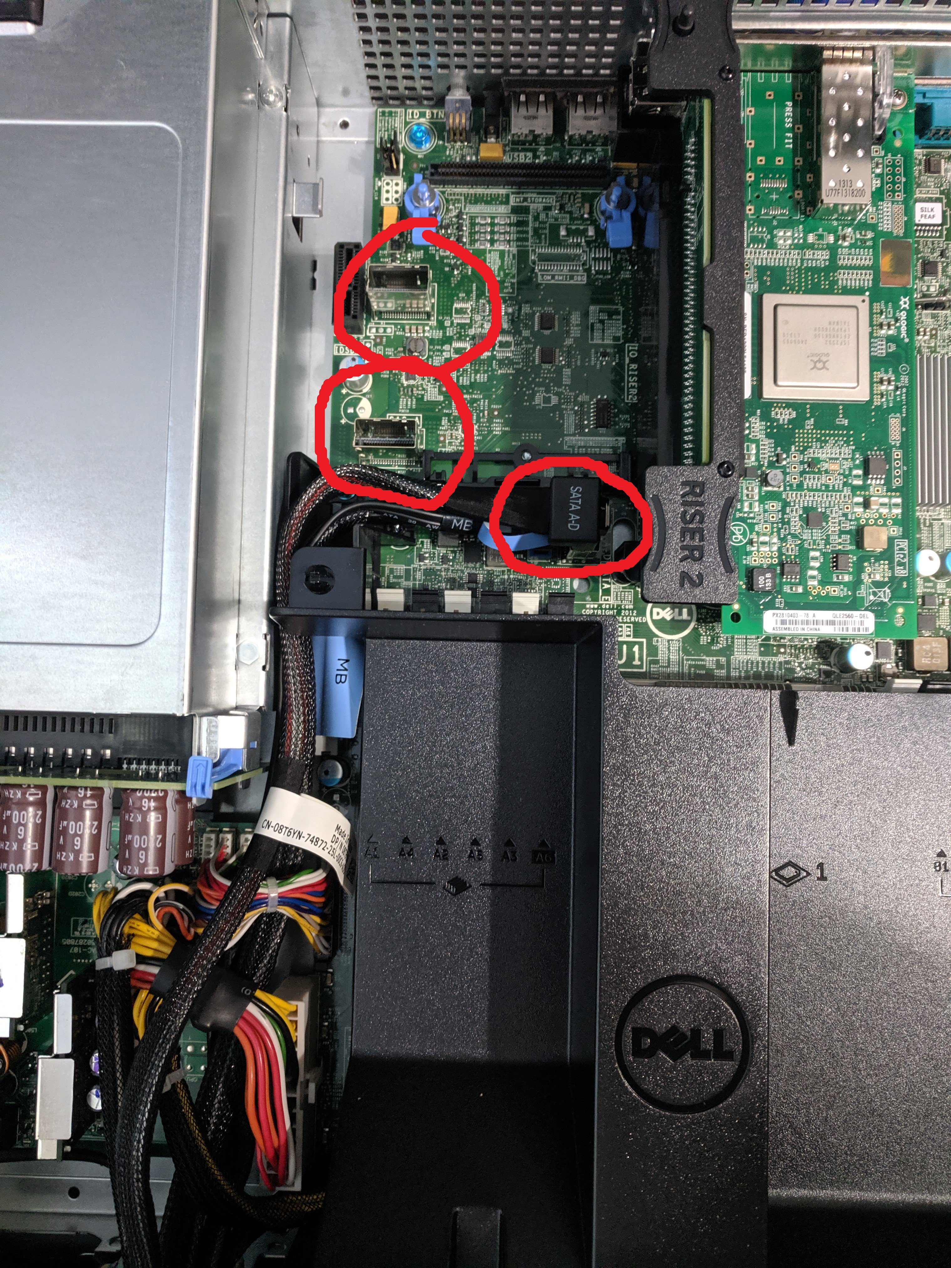

Appreciate it. I have googled a bit and the search on the forums is not the greatest. I had some questions because the way the board is configured did not make sense. The backplane plugs straight into what appears to be a sata a-d plug on the motherboard. My assumption is that disk 0,1,2,3 can run without a perc in the sata a-d slot, while 4,5,6,7 will need some sort of controller.
There are also 2 SAS plugs for SAS-A and SAS-B on the backplane that go straight to the motherboard. Can I run these as regular sata and bypass the need for a perc?

1. You can run 4 drives from the backplane to the SATA/8087 port on the Mobo. Swap the optical for an SSD and run it fine with no additions.
2. Caddy swap works fine. Auto detects in #1 above.

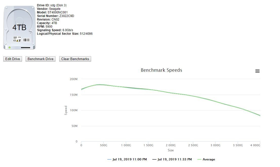

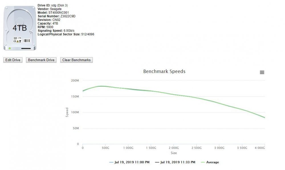

3. After flashing my perc h310 to IT mode. I ran a comparison with the s110 onboard non-raid passthrough then after the flash ran it again on the IT mode h310. For some reason I expected them to differ but in fact they were nearly identical.
