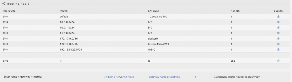

@bonienl here's the screenshot:
At the beginning I thought that the default route should handle the request and send a reponse. Because the target is not in the same network it would send the reply to the router.

The route you added should not be necessary, the default route should take care of this.
I expected to see br1 and not br3. Can you post the full diagnostics (see Tools -> Diagnostics).
