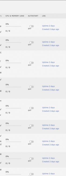

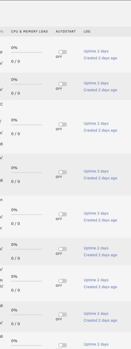

Then another thing I noticed is that the auto start is off and they are drawing zero cpu even though those were all auto start on

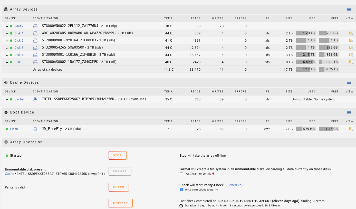

So I got home and then after a reboot the cache drive is saying Unmountable, my Appdata share is totally gone now, I dont know what to do!! Now I have all my dockers and data missing!   The Cache drive still says formatted XFS, so I dont know what could have gone wrong, please help!

Attached diagnostics, cache drive unmountable now

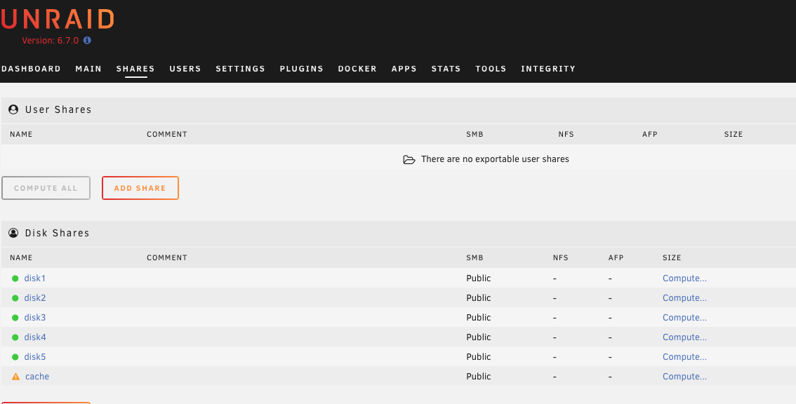

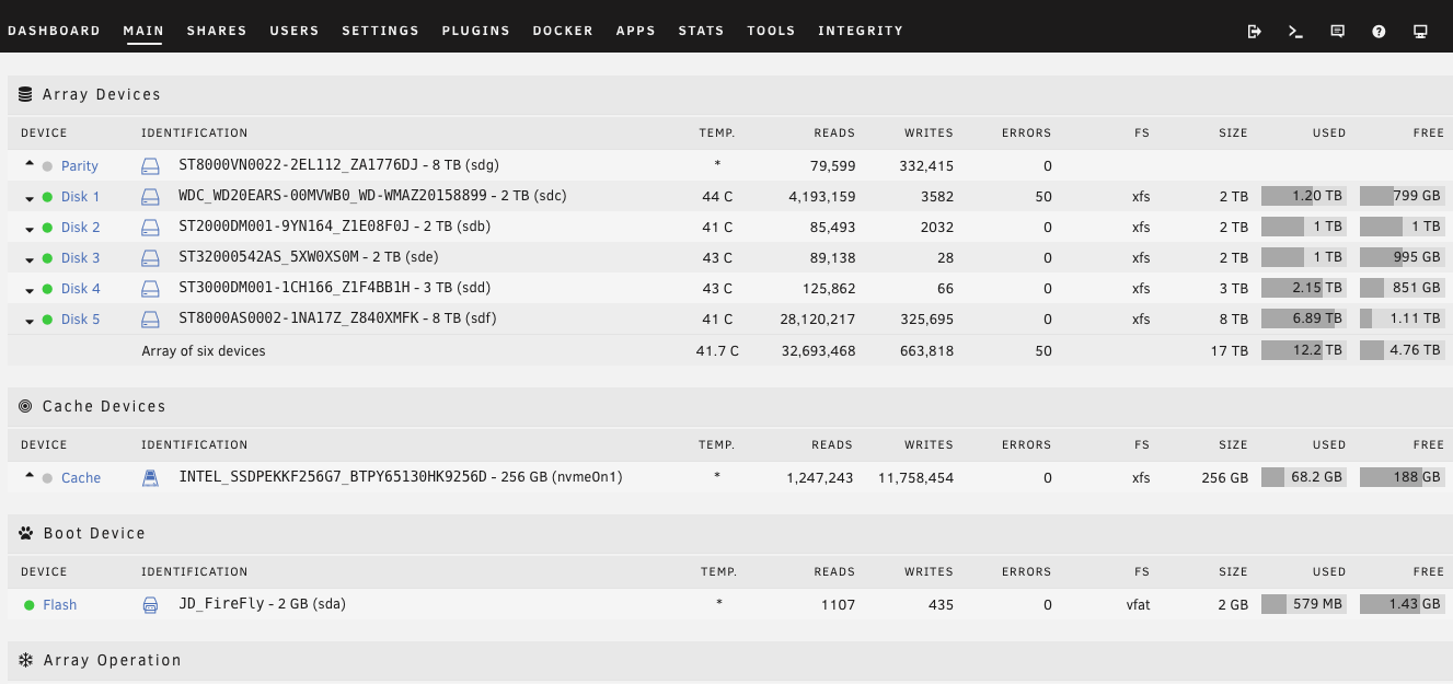

So Apparently its giving me the Log 100% again...
And all shares seem to be missing as well as Cache Drive is in Sleep/Standby which I had never seen before

649106116_ScreenShot2019-06-13at8_30_42PM.thumb.png.dbff344622d119ecaad4b1495d4d40f5.pngAfter Reboot it now says unmountable, No File System... My Appdata Share is missing also!!

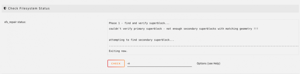

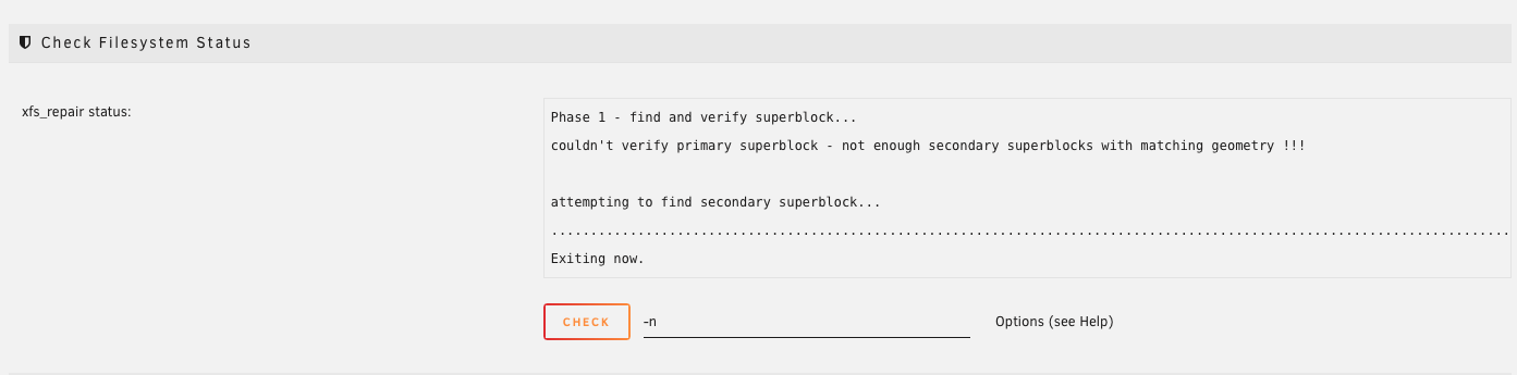

I ran a Check FileSystem Status and got this:
Phase 1 - find and verify superblock...
couldn't verify primary superblock - not enough secondary superblocks with matching geometry !!!
attempting to find secondary superblock...
......(too Many)....   Sorry, could not find valid secondary superblock
Exiting now
Cache filesystem is corrupt, so is disk5's, if you're getting corruption out of the blue you might want to run memtest to check your RAM.

Not unless xfs_repair can fix the filesystem, but looking at the output you're likely running an incorrect command, without specifying the partition, it should be:
xfs_repair -v /dev/nvme0n1p1

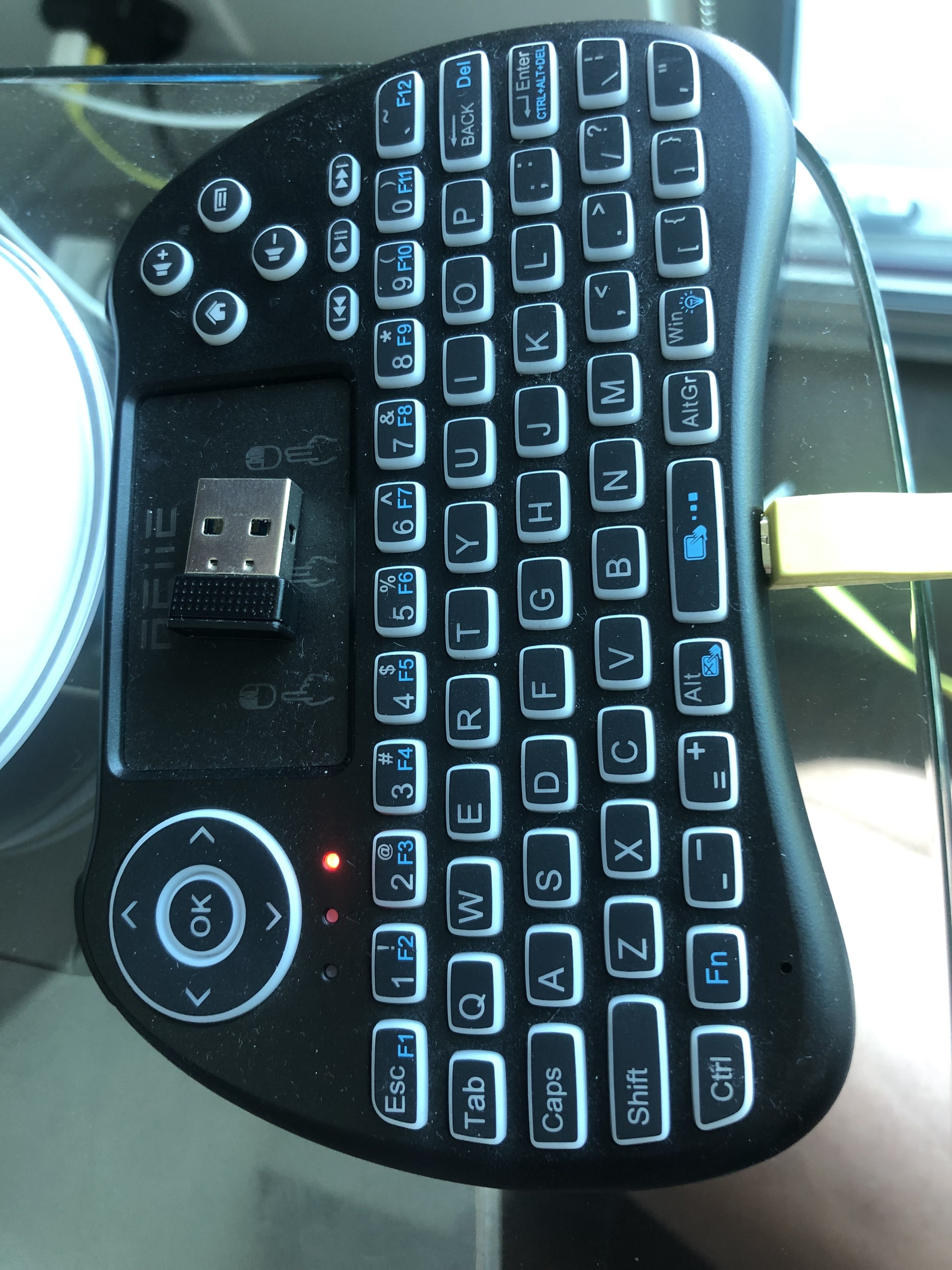

MemTest:  Is there a way I can run memtest within unraid, or without a physical keyboard?  I dont have a physical keyboard here at the moment to be able to plug Unraid to a monitor and check that.
Cache Drive: The FileSystem Check I did was the one from the Unraid GUI with option -n, anything else to try there, or should I go Command Line for it?

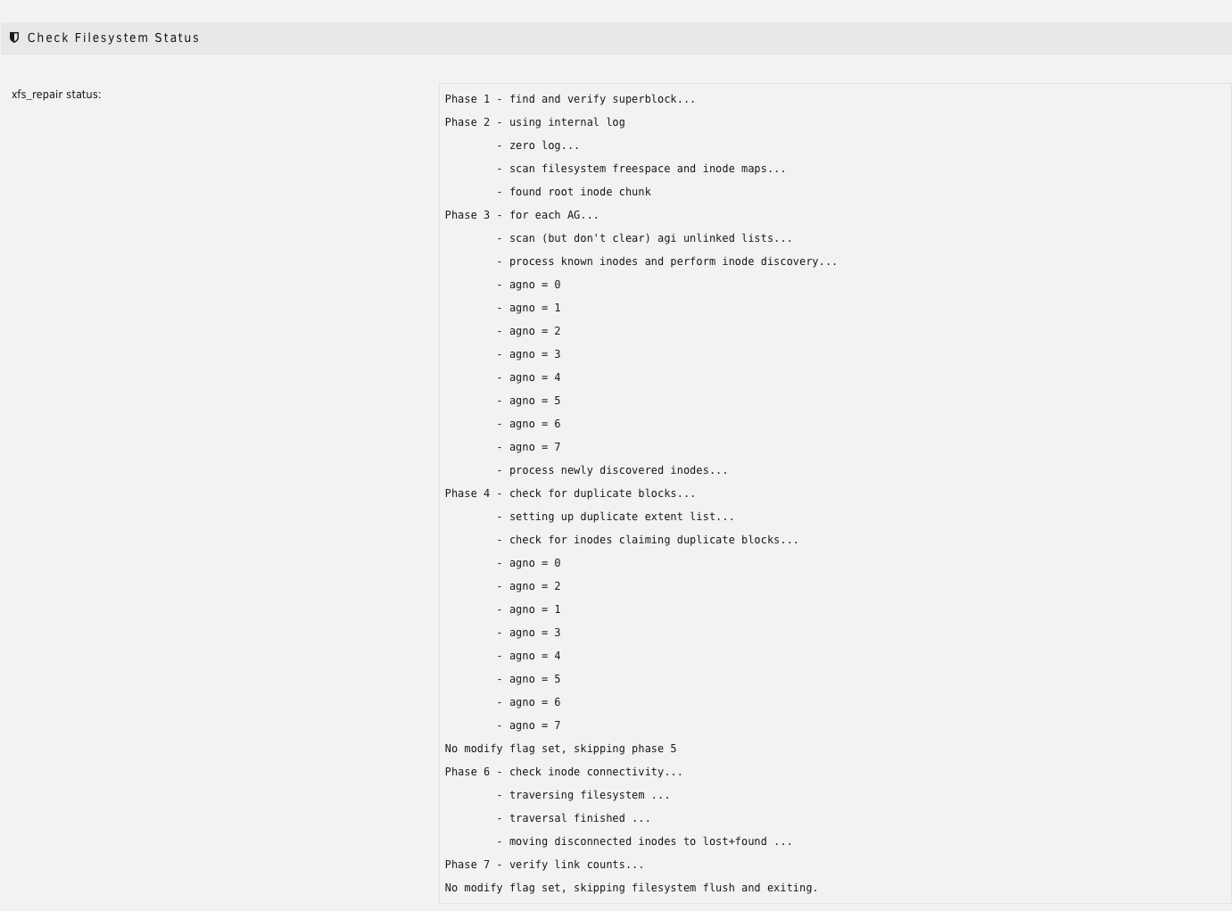

Disk 5:
Ran FileSystem Check since it was already mounted as Maintenance Mode:
421357666_ScreenShot2019-06-14at10_46_37AM.thumb.png.1d6a52d49fd9caaa7bb767cc9463318d.png
Not common for the superblock to be damaged, you can try again after updating xfsprogs but the result will be likely the same.

Disk 5:
Run without -n or nothing will be fixed.

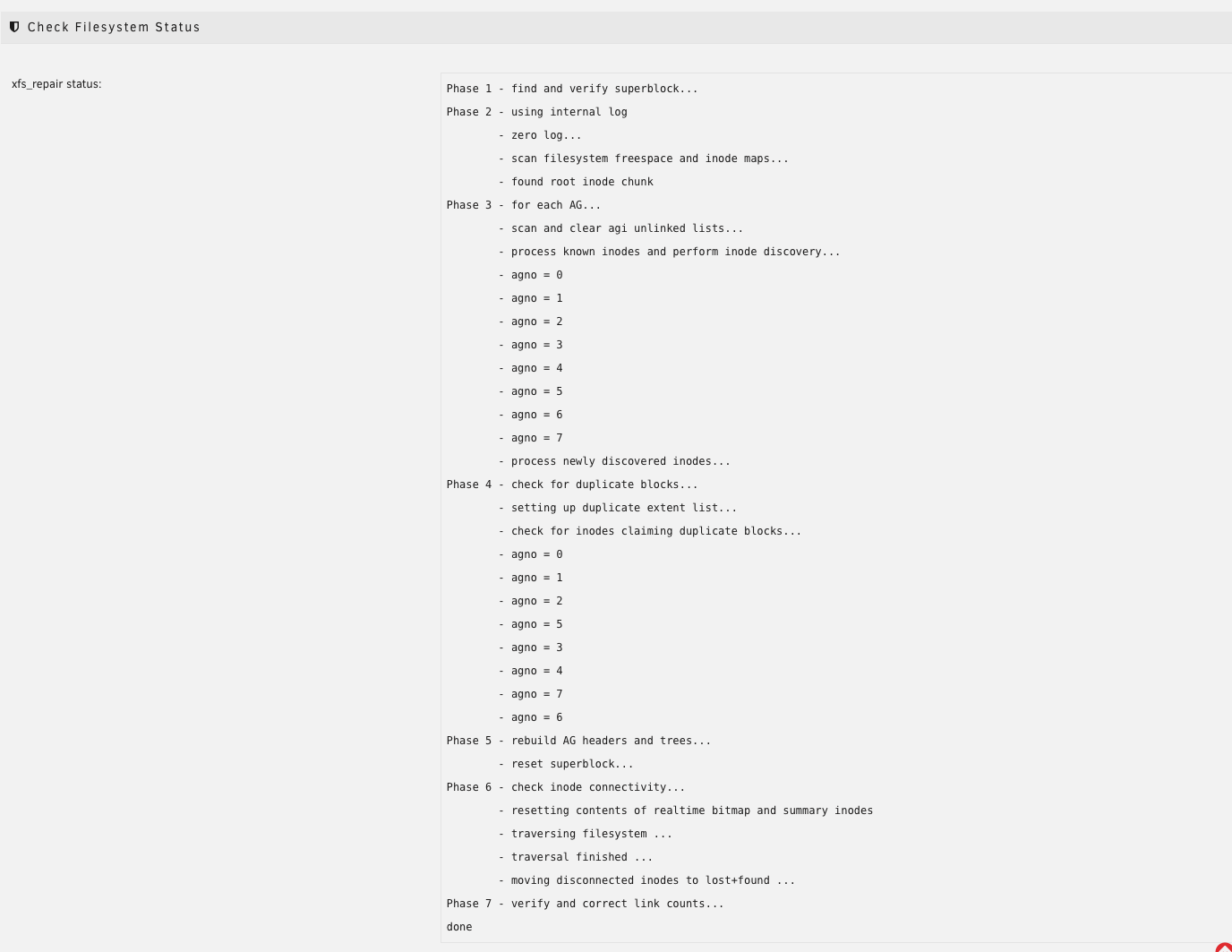

Here are the results on Disk5 without -n: (I had done this 2 days ago also when I had the docker issues with the btrfs cache drive, and after it fixed them I had not seen any errors)

So Disk5 was corrupt in the results above?  I guess I just did not see any errors.

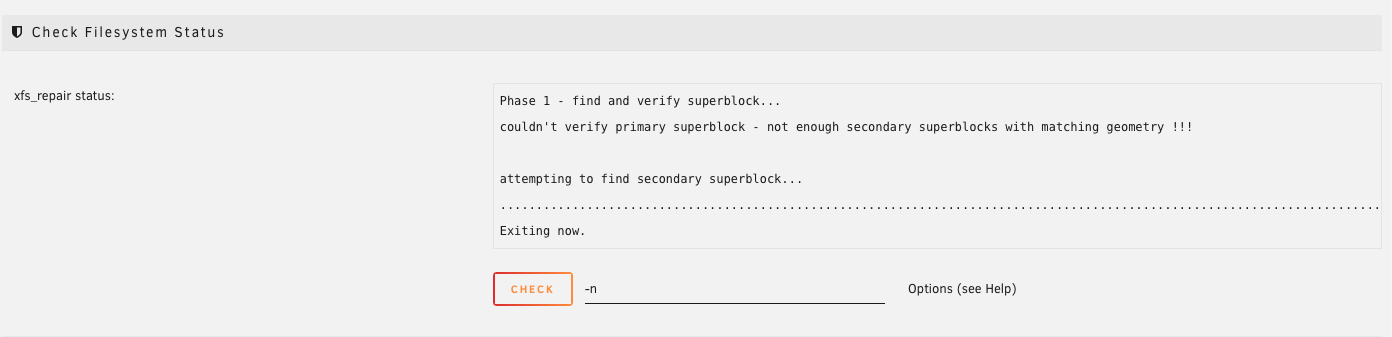

Cache Drive:  Same Results after xfsprogs update running Filesystem Check, so there is nothing to do here?  Should I preclear the drive?  just hit format and try to restore backup?
Unless you check the exit code it's not always easy to see with just the output, but there's no point in running with -n, this way if there were errors they were fixed.
Nothing I can think of, only option would be to ask for help on the xfs mailing list, other than that format and restore.

Do you know if this will work as a Keyboard on my Unraid Server?  The USB Dongle and this RF Keyboard I have for some android box? IMG_0819.thumb.jpg.a7c08e5f415f70f28407bda7110f0ecb.jpg

As for the keyboard not idea, you can try it before rebooting, and no, the flash drive can't cause filesystem corruption on data/cache devices.

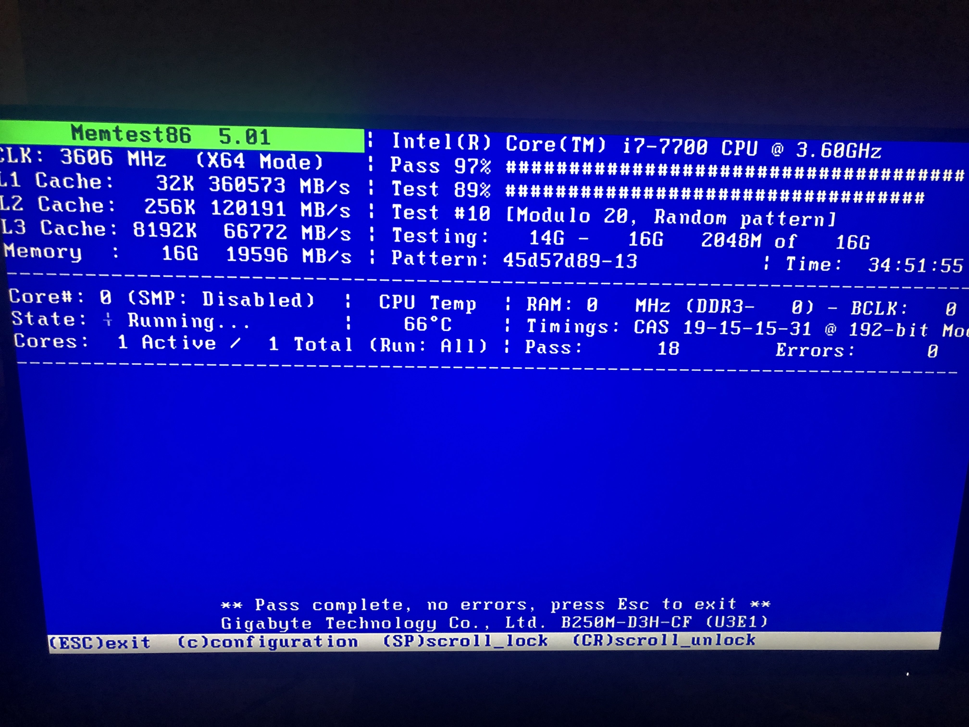

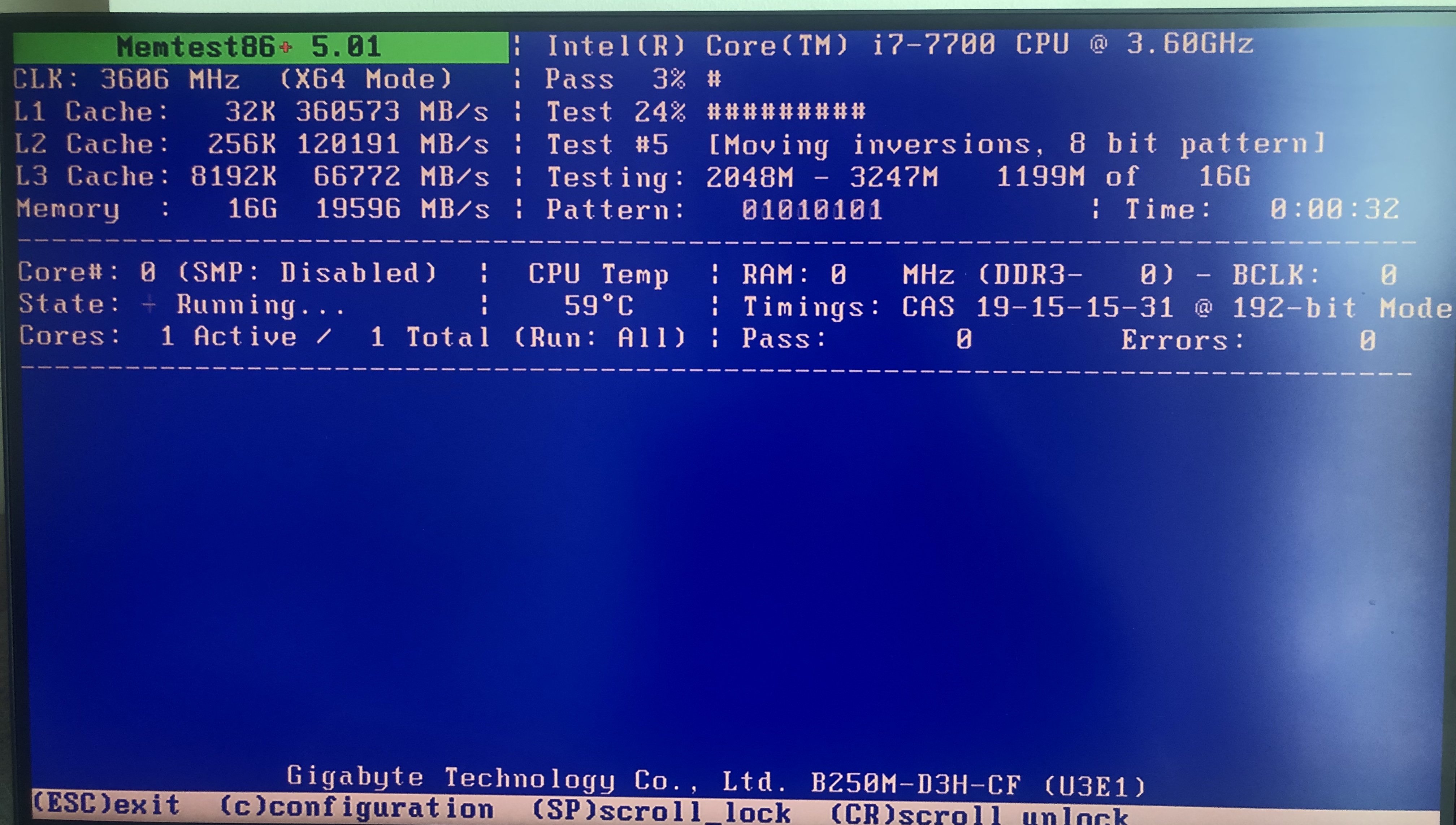

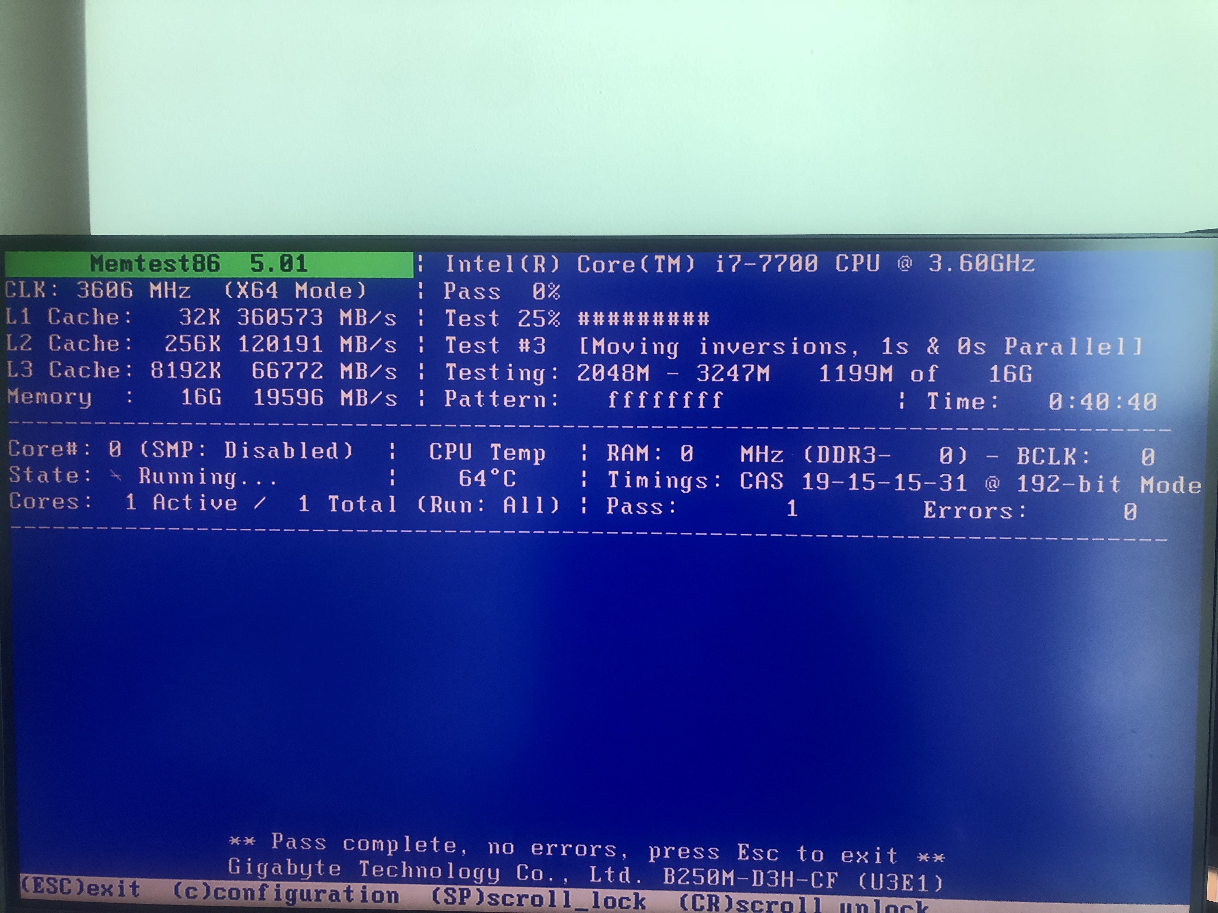

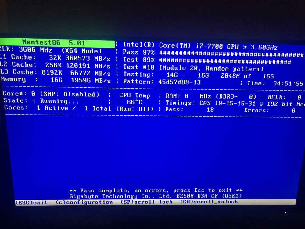

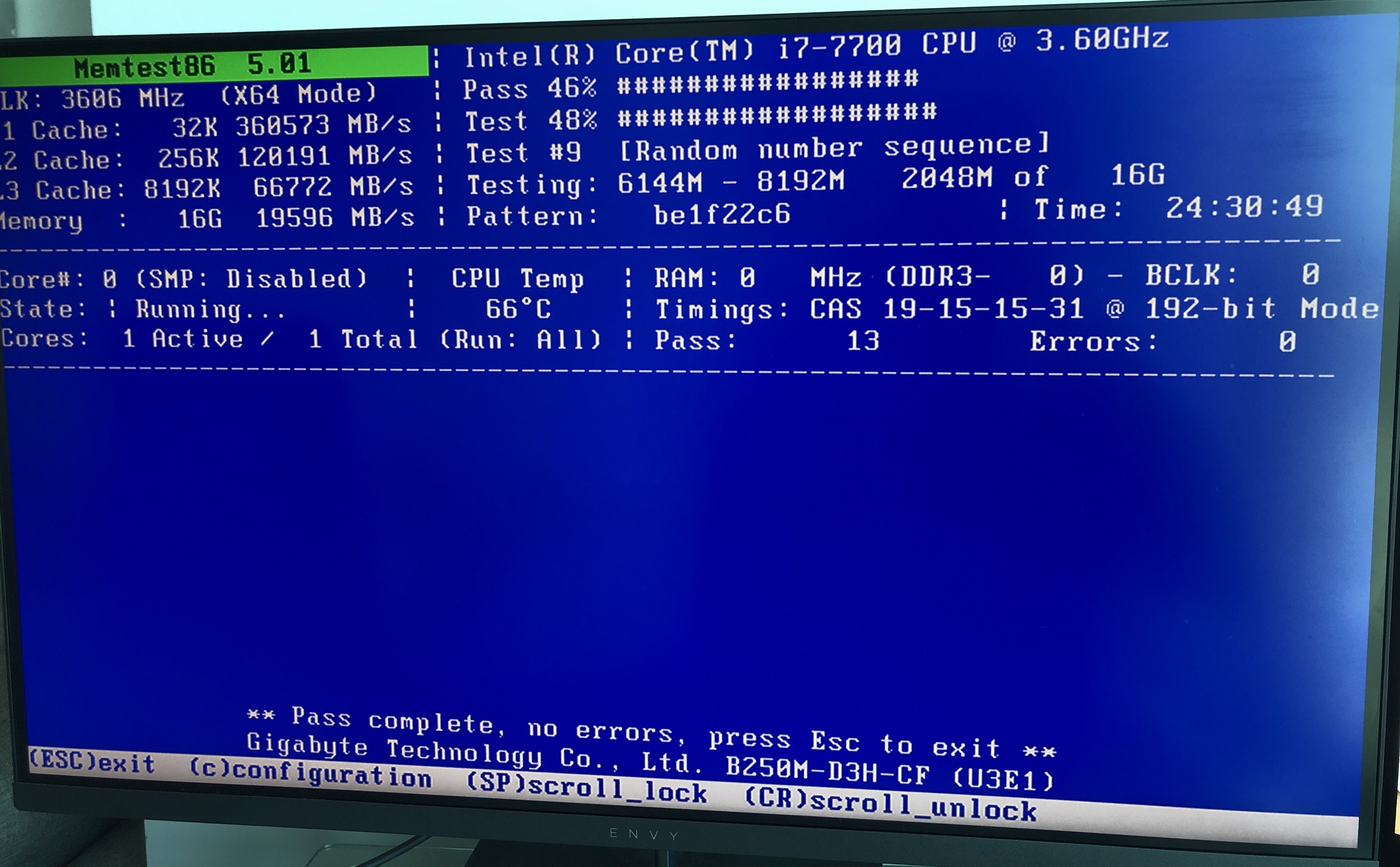

Heck yea, it worked.  Any specific Mem test I should be doing?  It just started conducting it as soon as I selected the Memtest, there was a prompt for failsafe or something like that but I guess I was too slow then it just started running.

So far 50% no RAM errors, will post results when it finishes.  If I need to do a specific test please let me know and I will run it after it is done, or not sure if it logs a file to post it once Unraid boots back up?

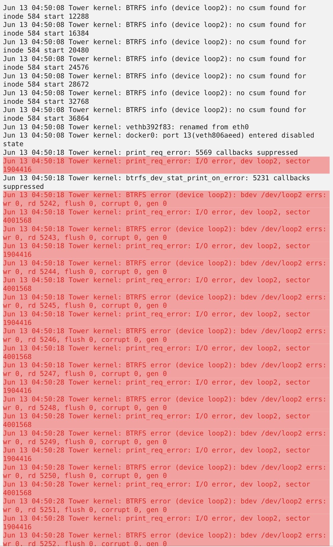

On that log that said Tower Kernel: BTRFS error (device loop2)...  That threw me off because I had no BTRFS drives at that point anymore.  My entire system was XFS, all drives in array and Cache drive were all XFS, so I was not sure why in the log it would show BTRFS.
The docker.img and libvirt.img files are disk images that are internally formatted as BTRFS.   This happens regardless of the type of file system being used to store these files.  It is these disk image files that you see being mounted as loop devices and thus references to BTRFS with regard to them.

So far after first pass everything seems good on the Ram side of things.   Could it be anything else?
memtest should run for at least 24 hours, but yes, there could be other reasons, though RAM would be the most common.
Hit the 24 Hr mark with 0 errors so far.  Should I let it keep running?  Or is there something else to test, or attempt?
I am at almost 36hrs with no Ram Erros, should I let it keep going to 48 or more, or is it good now to look elsewhere or try and see if my appdata can be restored elsehwere since Filesystem check did not work on this? IMG_0848.thumb.JPG.590697813bed671562ccbd32c52240eb.JPG
ram should be fine, I'd run badblocks on the drives.   Write test is best, but it destroys the data on the drive... probably best to do that though and restore your data from backups.
Have you collected smart data on the drives?
I have not collected smart data.  Should I do that for all the drives or just the Cache?
Im sorry, Im not familiar with badblocks, but I would be glad to run it if I can get pointed in the right direction.
Run it on Cache drive to write over data then restore the appdata from a backup?
