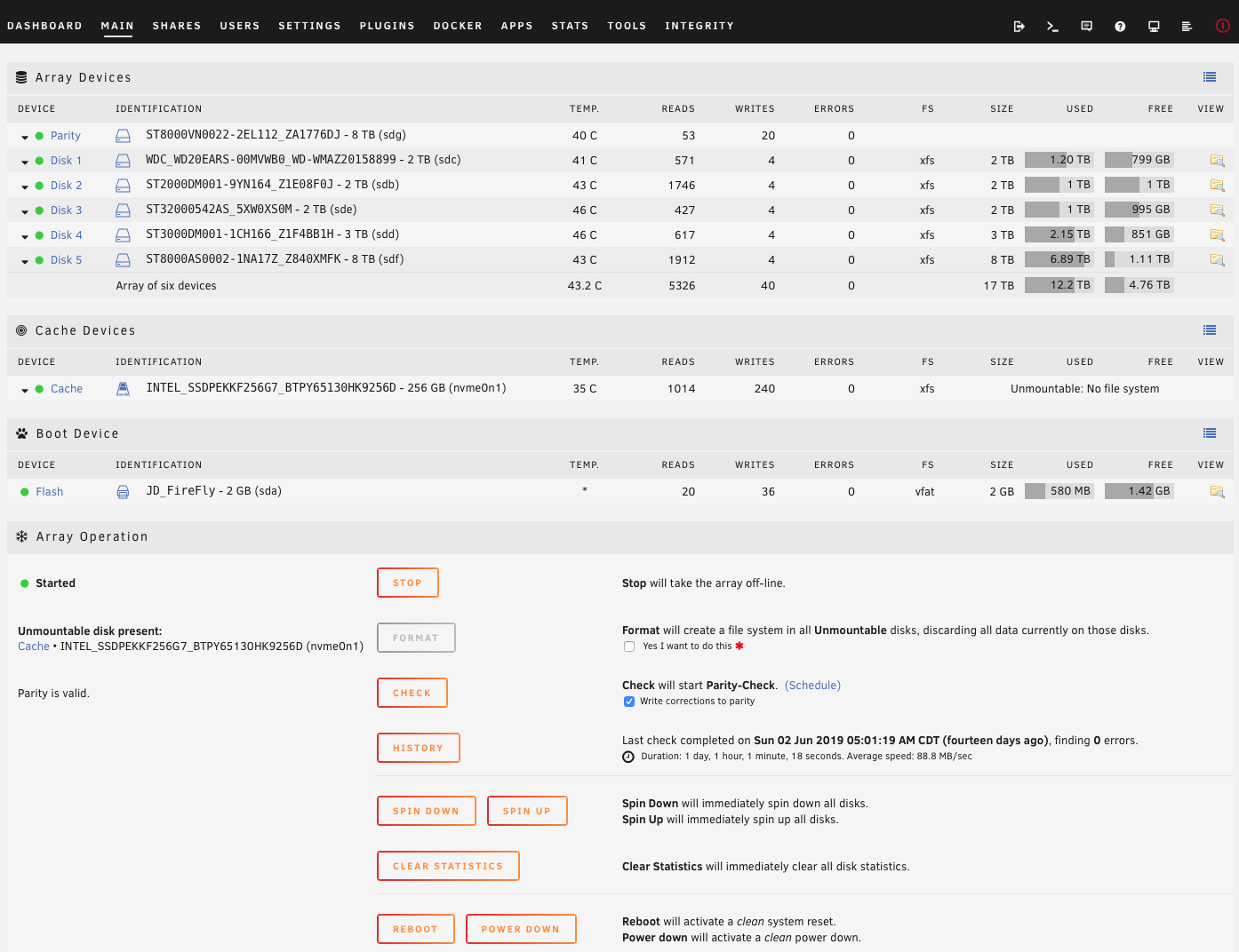

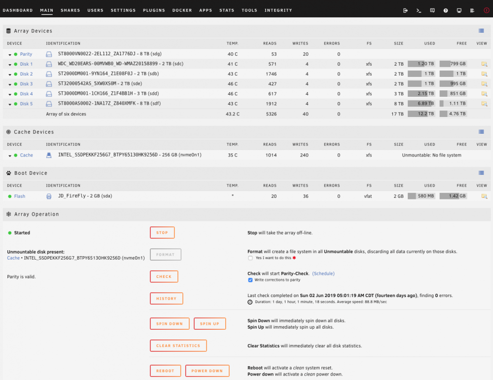

Please Help, Dockers Stopped Abruptly, Cache now says "Unmountable No File System". AppData Share Gone :(
I do have a single cache drive, SSD.
What happened is after years of operating without issue, I had dockers stop, I believe because of the BTRFS kernel issue with balance space.  So after that, I formatted XFS and restored cache drive to how it was, it was working perfectly once more for 2days, and all of a sudden it just croaked.  Dockers stopped, after a reboot the cache said unmountable and filesystem check could not do anything.  Which is why I was asked to run a memtest.
So that is where I am, nothing points at that cache drive being bad just yet, but somehow after being xfs for 2 days it just kinda quit and I seem to have lost all my appdata share
So if anything I think I would only be doing this to the SSD Cache drive, which right now is unmountable anyways so it seems my data on that drive is lost to begin with.
Or were you referring to some other drives in the array?
disk 5 was in question, so at the least run fsck on it...
You're running a single cache with no redundancy and no backups?  so, yeah, it's not a matter of IF you will lose data, just WHEN... that when might be right now.  You can run badblocks on an SSD, but honestly that's not a perfect test because of th way ssd's work... you should run fsck on it too.   I'd probably go grab whatever tool the manufacturer of the drive provides to test it, the only annoying thing is that might be some stupid windows utility...  My gut feeling is your ssd is dying.
also, you didn't answer when you last trim'd the ssd.
ps, there is a plugin that will schedule a backup of your appdata to your array, you could use should at least do that in the future.
I do have the plugin that backs up appdata to array, I just hope to god it's intact.   Thats my only backup of my cache drive, but setup for that reason, so I am just praying that to work.  So you think the SSD may be the one crapping out, of all drives I expected that one to go last.
I did not do any SSD Trimming I dont think.  Is that something I should be doing regularly?

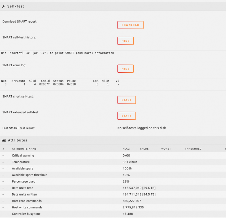

With array on, when I click the smart test nothing happens. tower-smart-20190616-0134.zip

RAM should be fine, use the array normally and grab and post diagnostics if there are any further issues.

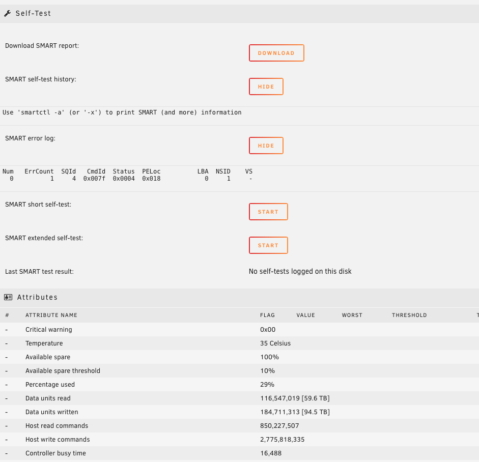

Ok will do that. Should I worry that when I click the smart test buttons on the cache ssd that nothing happens?
No, that's normal, NVMe devices don't support SMART tests, since it's useless for flash devices.
that's not true.  Some SSD's do and some don't.  He has an Intel 600p which supports some of the tests.  Obviously things like amount of time it's been spun up is silly on an ssd, but keeping track of lifetime stats like data written/read is important and useful.
so going by your pics in previous posts, you are 2/3 through the lifetime written max the ssd is rated for, but over at Tomshardware they had the 600p crap out around 105TB (you are at 94.5TB in the pic)... so it might be that its getting too beat up.
references -
Intel Ark - https://ark.intel.com/content/www/us/en/ark/products/94921/intel-ssd-600p-series-256gb-m-2-80mm-pcie-3-0-x4-3d1-tlc.html
Toms hardware - https://www.tomshardware.com/reviews/intel-ssd-600p-nvme-endurance-testing,4826.html
Good you were trimming occasionally, it helps a bit with wear leveling and maintaining performance.  Weekly or monthly is fine though with your usage, daily just adds extra stress to the drive, I'd probably put it back to weekly.  Another thing that is hard on nvme is the temperature, alot of people put a heatsink on them since they are only a few dollars and can make things last longer.
On the plus side it has a 5 year warranty and it hasn't been sold that long, so worst case you gotta RMA the drive.
If I were in your shoes (I might be some day since I have two 660p's in mine as cache), I'd probably try to run the intel toolbox on the drive since it has Intel's diagnostics.  I've never run it on an nvme, so I'm unsure of the results, but it seems prudent.  The only annoying thing is they only release it for Windows... i have no windows machines, you might not either... makes it irritating, but not impossible.
https://www.intel.com/content/www/us/en/support/articles/000005800/memory-and-storage.html

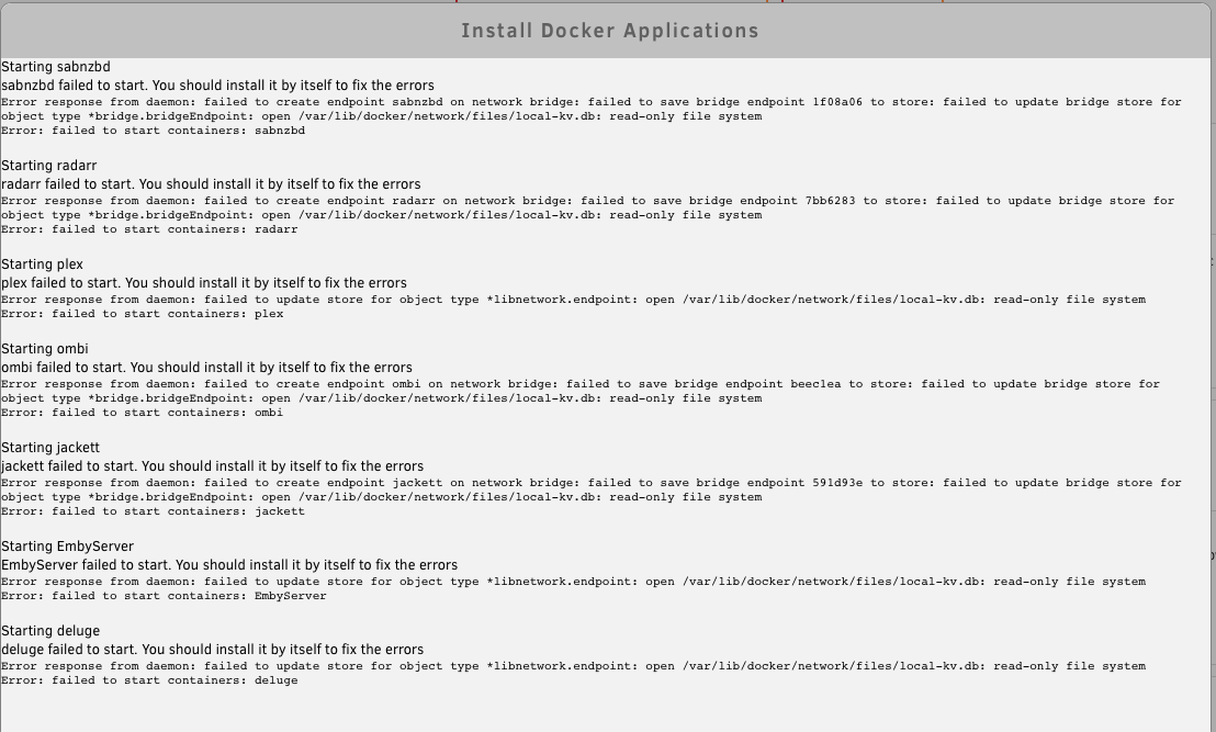

So I restored my appdata and reinstalled from previous apps but encountered the following issues:
I got at first this error on installing all apps for some of them:
785143902_ScreenShot2019-06-16at12_14_55PM.thumb.png.ca8468b075da4132fad63a30986d3f76.png
Then whenever I tried to start those apps it gave a server error:
Then after I stopped the apps that successfully started and tried to start again, it gives a 403 error:

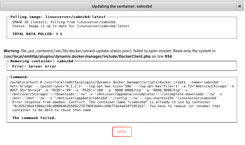

When I try to manually update one this is what I get:
Ok, so now its a real  issue.

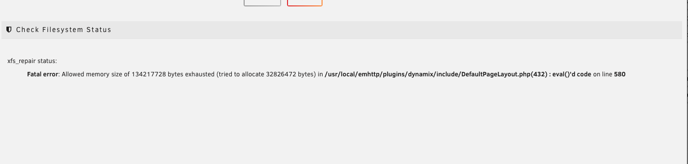

Ok, so I attempted XFS again, and after restoring my appdata I tried to do an XFS Check and got this error
864362567_ScreenShot2019-06-16at1_49_34PM.thumb.png.22b144d4a2f435d611bb9151178a2236.png
Attached is diagnostics:

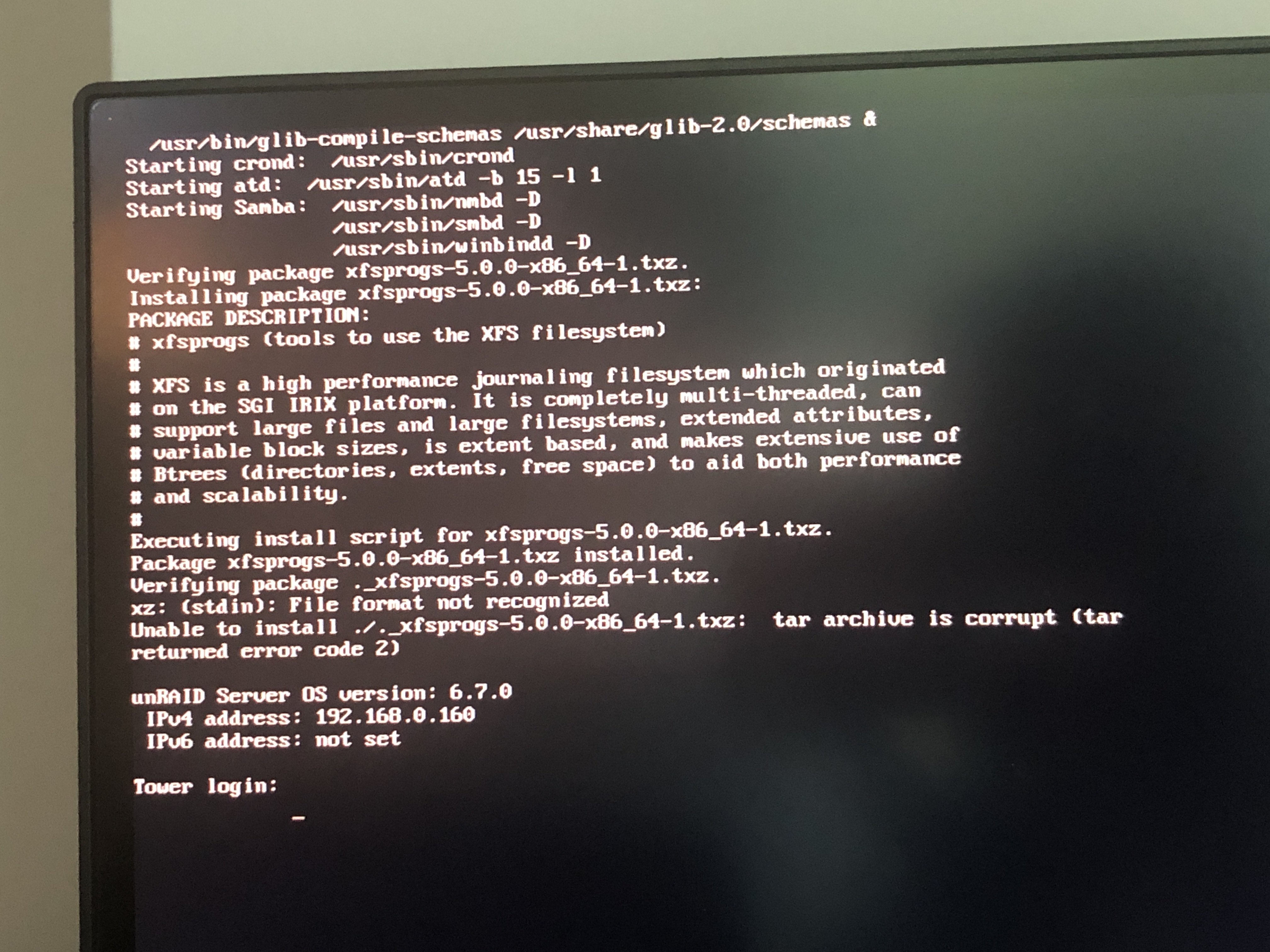

Doesn't look good.  Not sure where you're updating xfsprogs, but if there's a file within /boot/extra for it, you can delete it.
Yes, someone asked me to download and put a file in boot/extra for xfsprogs 5.0 so I did that.   I noticed it was a file that started in ._ so it's likely the Apple extension or something so I deleted that extra file, but I left the other in /boot/extra
