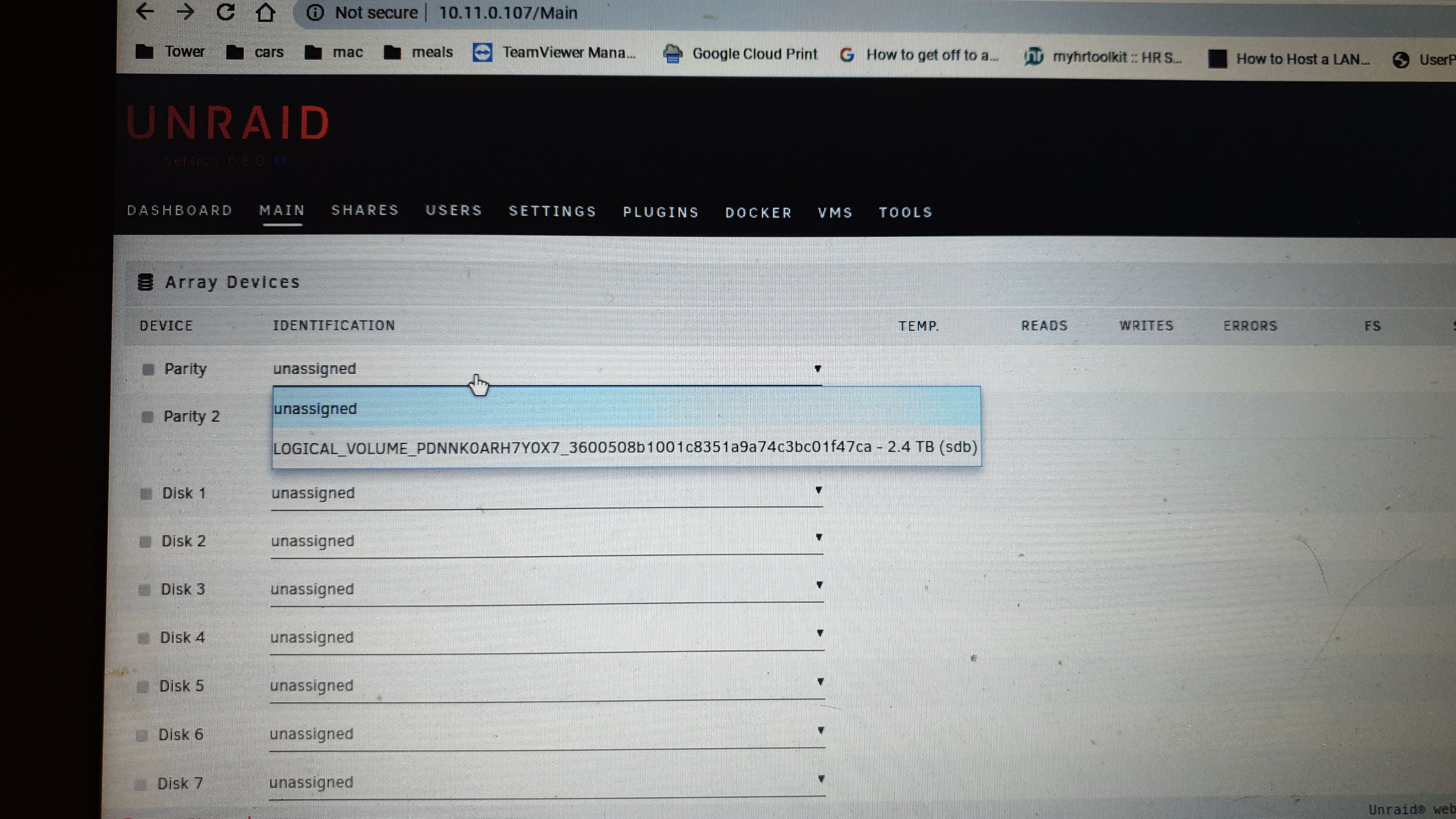

I have took the h240 out. rebooted into the bios and disabled the onboard raid controller.
Shut down and put the h240 back in.
Rebooted into unraid and I can only see one drive. But the drive is made up of 4 600GB drives 2.4TB. see picture.
Think I am getting half way
