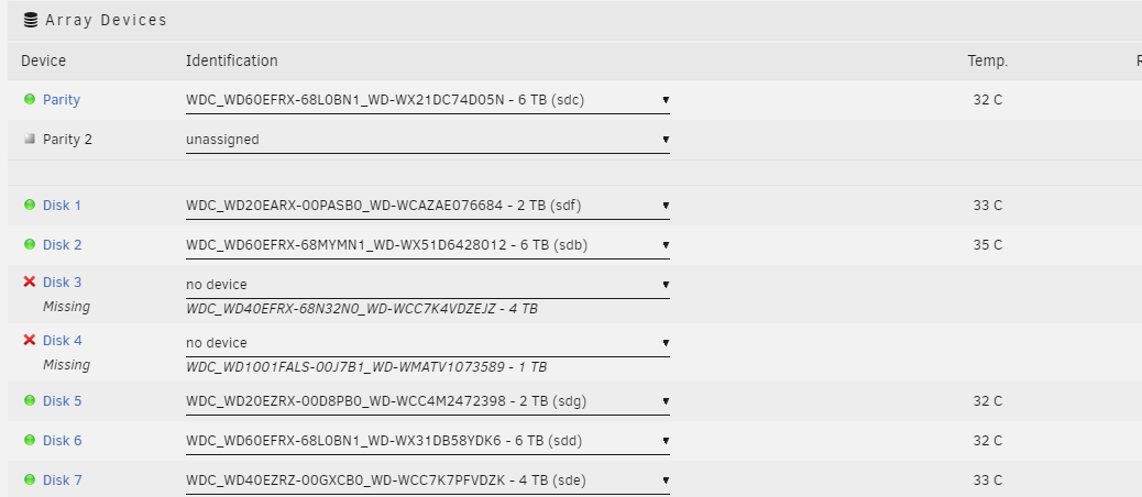

This morning I've sorted the subnets out, I can get to //tower, and I'm greeted with this:
Panic sets in.
My idea was to start it without the disks, turn it off and add them back in, but I can't since 2 are down...but I can't due to the warning:
'Too many wrong and/or missing disks!'

You need to check/swap connections for the missing disks, check if they are detected in the bios, very unlike two disks would die at the same time.
A new config would allow you to start the array but by losing the data on both missing disks.

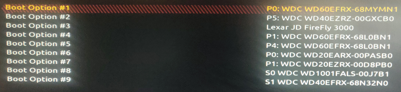

So I've had a look in the bios, the full ID string isn't there, but thankfully the 2 'failed' ones are pretty obviously different IDs,
Boot option 8 and 9 which might be on a PCIe SATA card.

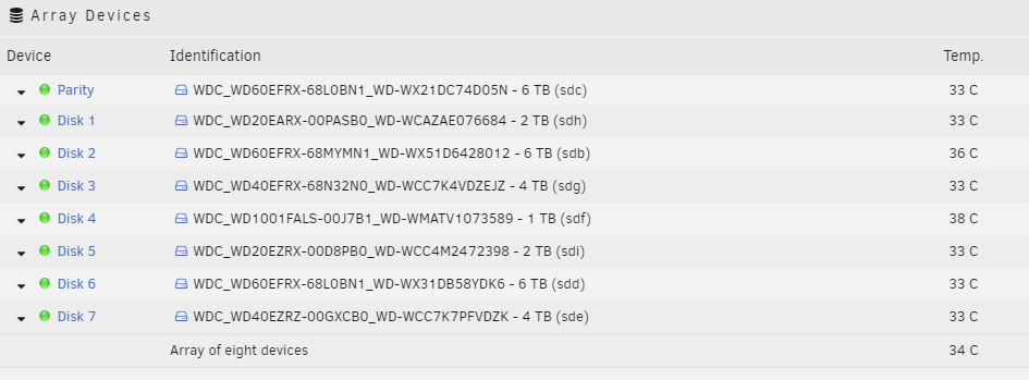

And as if by magic:
I'll change it to solved, I'm starting to think the sata card might be a bit screwy

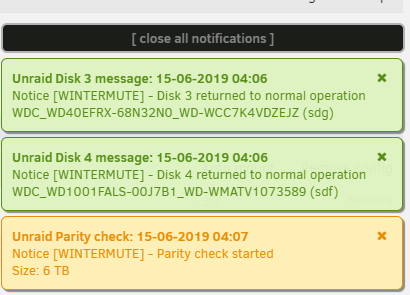

The first just dropped while watching something streaming from it, and then after looking at the notes I spun down and it lost the second. A bunch of restarts, removing and adding drives until it could see them both again and it's fixed.
I'm certain after a restart/power hiccup it 'loses' the sata card so I'll look to replace that in the near future!
