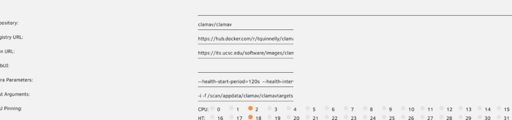

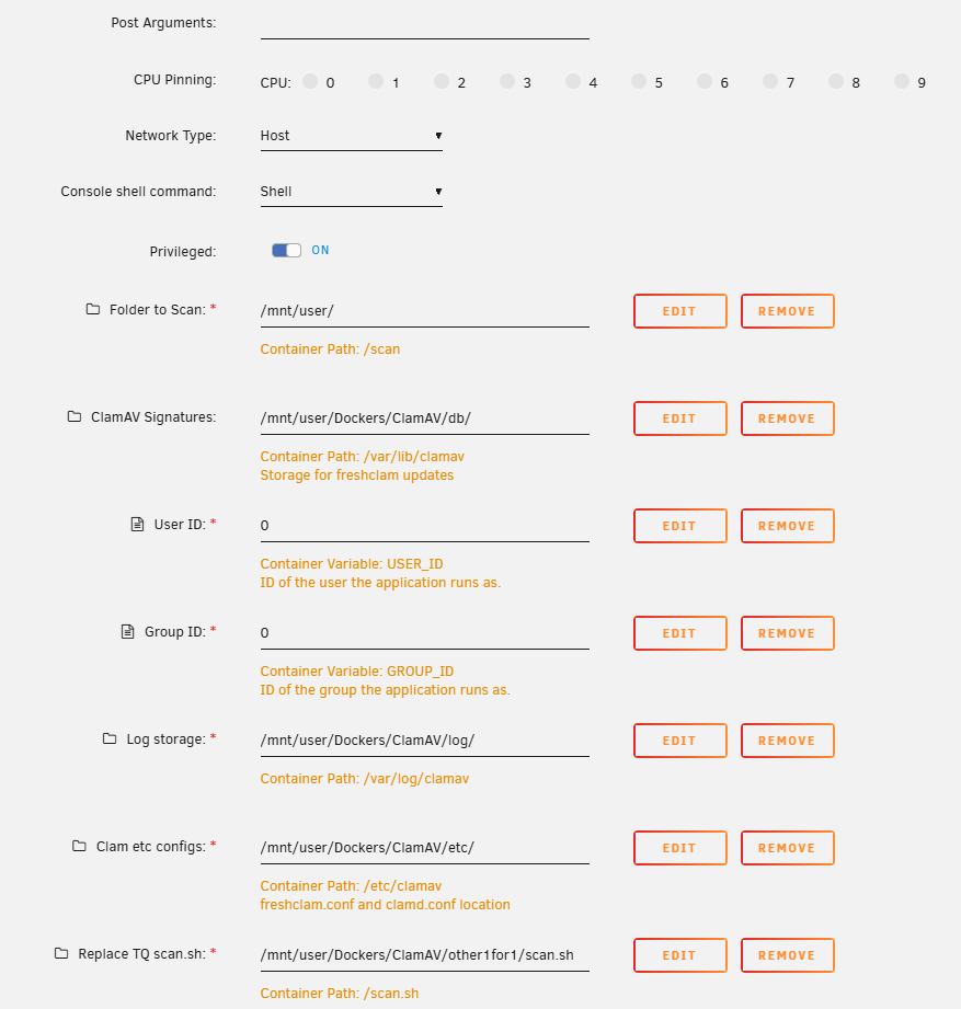

3 hours ago, doogle said:
What do you mean by post args section?
I made a spot in the template for these:
Thanx. I'll have to remember to click the advanced view slider. Wish it would just stay on but I guess not.
That worked great.. you da man!

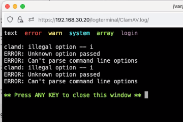

On 3/4/2024 at 9:10 AM, ijuarez said:
I recently deployed @Masterwishx script and have it setup correctly. however when it starts at the designated time it scan the shares but it takes less than a minute and its down and I know it should take longer than that.
Below are the scanning results, i am not sure where to get the actual log of clamav starting and giving me the info on what it scanned
Any help to figure out why i am doing wrong would be appreciated.
clamavmaplog.txt 370 B · 1 download
clamavtargets.txt 92 B · 0 downloads
this is what I get in the clamav docker logs
no sure how to fix that
You're not using my container.
Yep works much better with the correct container
thanks

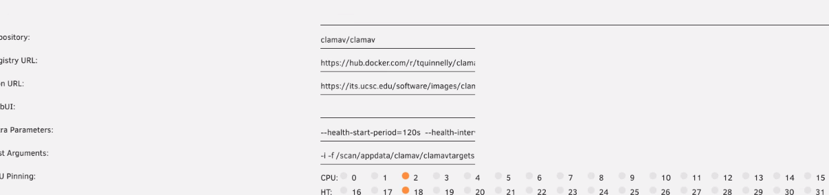

How can I exclude files or folders?
Have the Script a excluded file/Option?
For false positive founds.
https://linux.die.net/man/1/clamscan
edit docker template
advance view under options for
add option and path form docker point of view path should be
(by default unraid /mnt/user is dockers /scan)
--exclude=REGEX, --exclude-dir=REGEX
Don't scan file/directory names matching regular expression. These options can be used multiple times.
add option --exclude-dir=/scan/(directory you want to not scan.) or single file...
Edited by bmartino1

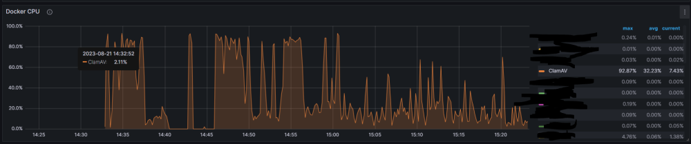

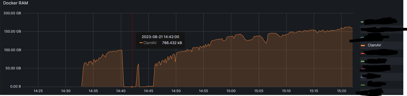

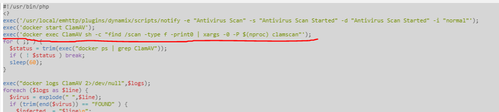

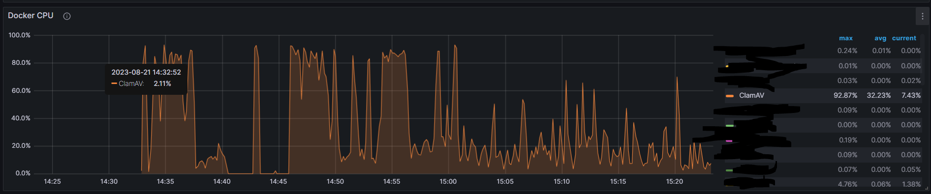

On 8/21/2023 at 1:24 AM, IronBeardKnight said:
For those of you that have setup the script to go with the ClamAV container but have noticed little to no activity coming from it when running  "Docker Stats" this may be the fix to your issue.
I don't believe that the container is setup to do a scan on startup so you may have to trigger it by adding this line to the scripts as seen below in the screen shot.
I have also figured out how to get multithreading working although be warned when using multi you may want to schedual it for when your not using your server as it can be quite CPU and RAM hungry.
Some thoughts for you before you proceed with multithreaded scans are to put a memory limit on your docker through extra parameters.
Multi Thread:
exec('docker exec ClamAV sh -c "find /scan -type f -print0 | xargs -0 -P $(nproc) clamscan"');
Single Thread:
exec('docker exec ClamAV sh -c "clamscan"');
While diagnosing why my instance of ClamAV decided to not scan anymore I came across script edit and immediately needed to try it out. Ended up having to diagnose why my script kept exiting xargs for reason of "terminating by signal 9".
I have no experience with xargs, so queue up reading montage. With a better understanding of how to use xargs to do things, I'm left with this question....
 Isn't this "multithread hack" just running clamscan redundantly over the same files on all threads/cores?
Someone correct me if I'm wrong, but honestly I don't want to scan the same book 16 times - I want to be able to scan multiple things at a time to speed up my scans. 140TB worth of Gutenburg content and ISOs is a lot to scan through, especially multiple times at the same time 😵‍💫

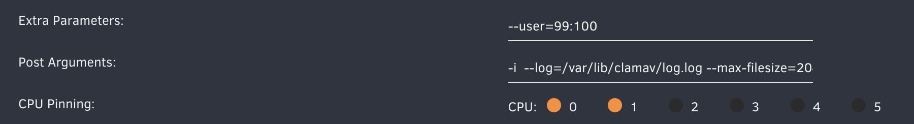

On my Github page, I've called this out.
docker run -d --name=ClamAV \
  --cpuset-cpus='0,1' \
  -v /path/to/scan:/scan:ro \
  -v /path/to/sig:/var/lib/clamav:rw \
  tquinnelly/clamav-alpine -i --log=/var/lib/clamav/log.log --max-filesize=2048M

I suppose I was confused at the wording differences between clamdscan and clamscan. When reading manpages of clamscan, there's no mention of multithread support whereas clamdscan mentions multithread support. When I brought up xargs issues, I was referring to the startup userscript line edit post made by @IronBeardKnight back in 2023. With my new understanding of xargs, I see that this line edit:
essential attempts to spin up clamscan instances times the number of cores available.
@TQ I see in your example you've pinned two cores, but that doesn't necessarily mean a given application is multithreaded. cpuset-cpus just tells docker to run the container on the specified cores. That said, I have played with the template to optimize what I'm going for. I believe I've set up my template and startup userscript about as good as I can get it.
I understand clamav better now doing considerably more reading.  Thank you TQ for your hard work! Thank you again as well bmartino for directing me in the right place to understand clamav better
Yes, I meant to call out the lack of multi-thread but the need for CPU pinning in the event that you have a large scan set and not a lot of cores. ClamAV will take what it can get, so limiting it to a sane set of defaults helps.
Thanks for the kind words.
