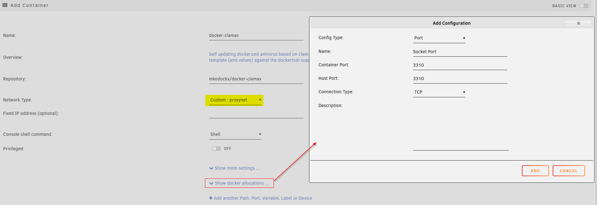

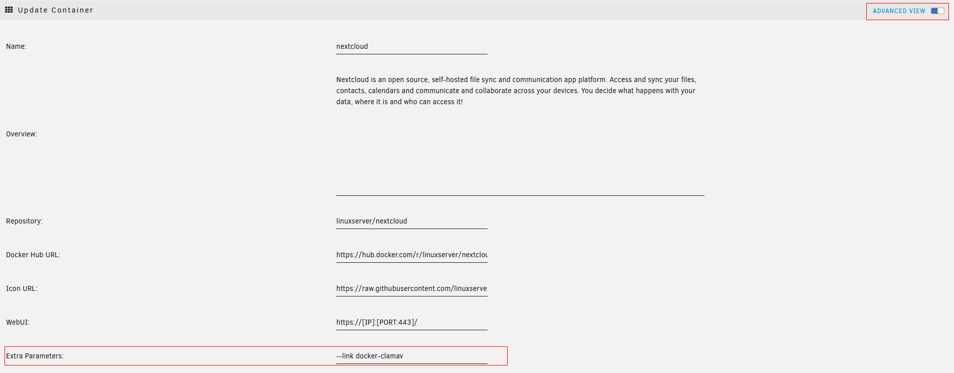

On 9/13/2020 at 6:18 AM, marlouiegene18 said:
Has anyone figured this out for Nextcloud use? I'll be using Nextcloud to work with my students. I just want to get infected and others get infected.
If it's still relevant for you, I got a solution that works fine for me.
You should enable the additional search results from dockerhub in the CA settings
Then proceed with the following steps:
1. In Apps-tab search for "docker-clamav"
2. Click on "Click Here To Get More Results From DockerHub"
3. Select the following container (it's from mkodockx, you can verify by click on the link to dockerhub page):
4. Install with these attributes(beside the standard template, you just have to set up the port 3310). I don't know if it's relevant: My nextcloud container is in the user defined network "proxynet" like spaceinvaderone explained in
his video for a setting up a reverse proxy. I think at least it's important, that both containers using the same network.
5. After installing the docker-clamav container, edit the nextcloud container, enable "advanced view" in the up right corner and add the extra parameter --link docker-clamav.
6. Restarting both containers and everything should work fine. You can test it with some false virus signatures downloaded here:
https://www.eicar.org/?page_id=3950
To set it up, I followed the instructions from the following website:  https://www.virtualconfusion.net/clamav-for-nextcloud-on-docker/
Edited by Voss
