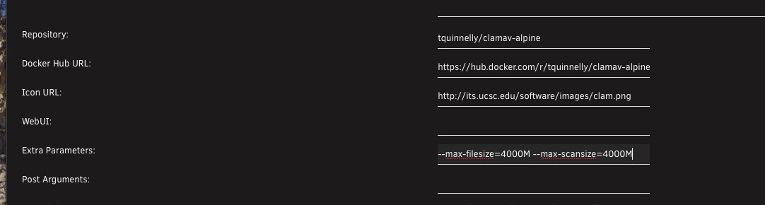

Is it just a space to separate multiple configurations?
Realized that i had the arguments in the wrong field after taking the screenshot. Already fixed. Just want to be sure they are correctly formatted?
Edited by wgstarks
add screenshot
Yep, space delimited.
Your ss looks good to me. (Since you moved it to post arguments)

Hi, thx for the docker!
I tri3ed -after install- to add:
--max-scansize=4000N --max-filesize=4000N
but as soon as I press save, the docker disappears. Anyone expiriencieng the same?
Rgds
45 minutes ago, Squid said:
Where are you adding this?
advanced view> extra parameters
