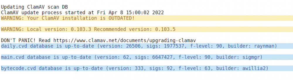

but i cant update to 104.2 , or how can i ?
Thanks for cool container , also updated to lasted release but its still 103.3 ...
Edited by Masterwishx
