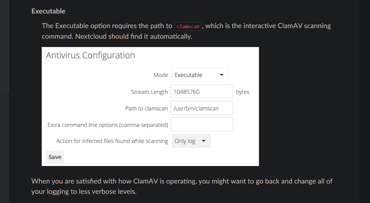

@TQ is it possible to make this container to use with nextcloud ?
It should be quite possible, yes.
I do not use Nextcloud so bit of a challenge for me.
in Nextcloud there are 3 options: daemon,daemon (socket),Executable .
in this container is no daemon right? so we can use only executable, but how to get to Nextcloud path of executable ?

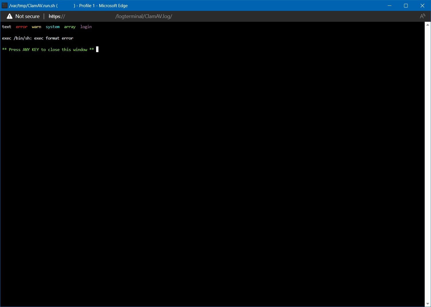

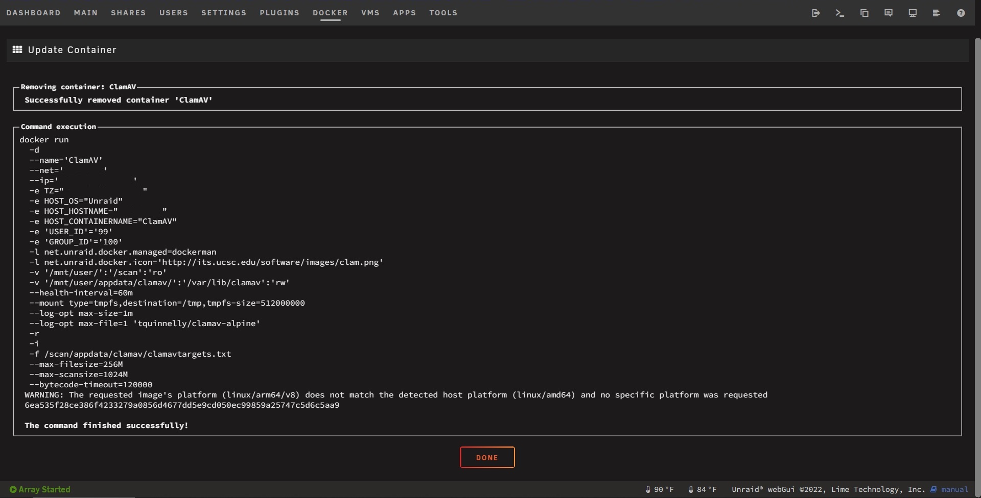

When installing the latest update from 4/22/2023 on Unraid 6.11.5 I saw the error below during installation:
The docker starts but immediately stops.  When looking at the log I get the following error:
Is there something I need to adjust in the template for the new build?  Thank you.
I got exactly the same issue. Same error 6.11.5 as well.
I can confirm I experience the same error using Unraid 6.11.5.  The other ClamAV docker available requires an active console or tmux session to run a scan command explicitly.  I prefer this automated one and check the logs.  Hopefully the developers see this and can correct.
I will check on it tonight. Not sure how the arch changed.
Latest branch updated. Please re-pull and LMK.
Thanks for the quick fix!
Seems to work again (as well in combination with the user scrip for different shared).
I can confirm mine is working now too.  Thank you for the quick turnaround on the fix!
