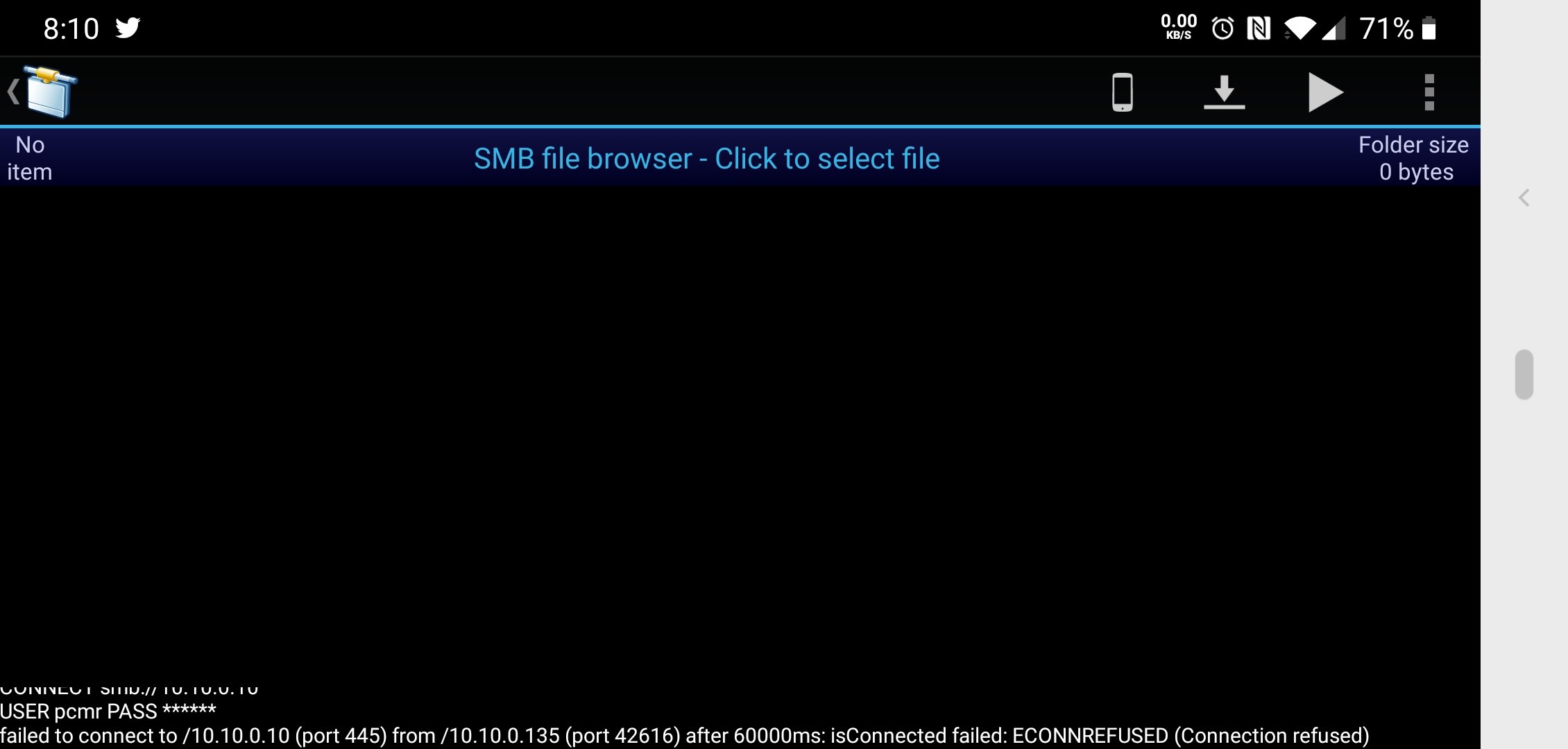

It looks like the unraid server is refusing SMB connections. See picture of my android phone using AndSMB and getting a refused message.
Can this help with trying to pin down the issue?

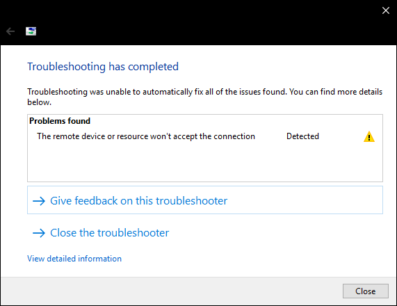

Anyone able to help? Tried renaming network.cfg, passd, shadow files on the flash an d also trying to see if any issue with sectors on the flash drive with no luck! Unraid is still refusing SMB connects SMB v1 or SMB v2/3. This is from both Windows and Android phone, so that rules out the windows smb v1 issue.
