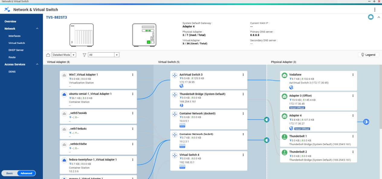

Basically I'm just trying to say, in this day and age, and with Unraid having so much reliance around docker and VM's networking we can probably do better (and probably should do better), via GUI.  Unraid is awesome, it would be more awesome with some semi-recent GUI network config tool.   Right now it's very very basic.  Attached the QNAP one below, just cause it's what I know about, being that QNAP is on linux, basic and based around open source community.  Good to think about, in terms of where we could be in the future, not where we must be, just where we could aim.  Amongst the NAS's QNAP does have an edge when it comes to customer oriented features so I tend to look toward them and ask how and why.  Why should we suppress thinking forward?
Edited by Marshalleq
Clarity.
The big difference I can see is that QNAP NAS's are hardware with defined and clear cut w/ regards to the hardware like the number of network interfaces and possible roles of the interfaces. Also, I think most commercial NAS have a small reset button in case you bugger up the network config.
We don't have that in Unraid, which leads to the WebUI having to figure out just what is on the machine and work with it seems to get from the OS, and if it makes a mistake, there's no magic reset network config button. You either reconfigure locally (Console or GUI mode), or you unplug the USB, pop in another PC and fix/reset the config files.
Unraid has to make some general assumptions that would work for everybody out of the box, hence the initial bond all network interfaces together upon startup so that the network would work out of the box regardless of how many devices there are or which one is eth0 and if that interface has an actual cable plugged in. Unraid has no idea which of your on-board or addon nic would become eth0 and neither would you unless you've used the PC/server on a similar generation Linux OS before already. The fact that it works for a lot of people out of the box or with minimal difficulty is already a great step forward and it will probably get better, but lets face it we are not there yet. Last I checked the similar competition FreeNAS, or OMV do not have such a sparkling network configuration UI either.
One should also remember that QNAP spends a lot for the development and support, and makes a user pay for it, by being way more expensive than a similarly specced NAS made out of off the shelf consumer or even server parts.
I'm not knocking on the way you think, just pointing out that features tend to cost money due to development and testing, and you would have been shocked at how we got to the current networking configuration in the last 3 - 4 years - we only got custom docker IPs around 2 years ago, and we had back and forth with the community and the devs on which way to go and how to go. The current system is amazing and flexible, though not super user friendly.
