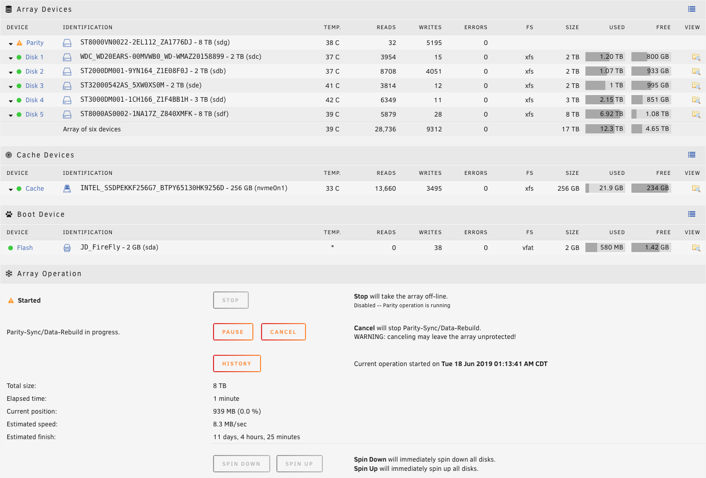

Ok, I have done so, but maybe too much has happened in the Array in the past 8 hours since it happened where it is not as close.  It does say Parity Invalid now, and it is rebuilding.
Is it normal for it to be going at ~10MB/sec?
10MB/sec sounds very slow but your screen shot suggests something may be writing to disk2 which could easily slow it down to that sort of speed.   Writes during a parity check severely degrade its speed.  Provide the diagnostics if you want to see if anyone can suggest anything else.
