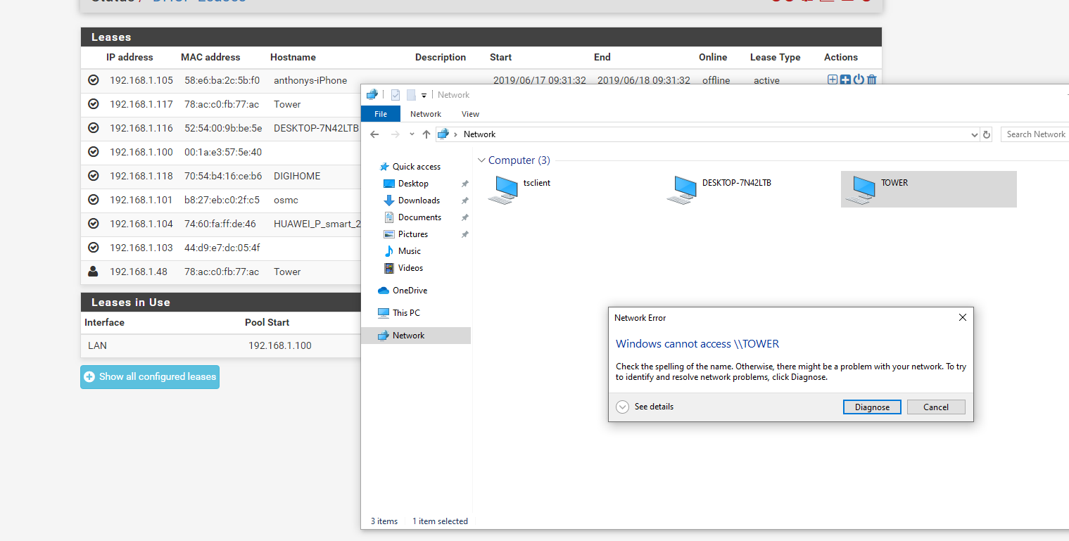

I have an issue accessing the shares from my windows 10 VM hosted in unraid and get the following error.
My system is currently unraid running PFsense and Windows 10 vm that i use to RDP into.
It's no major issue as i can use winscp but the feature would be noce to get working :)
I have enabled SMB settings on the windows 10 VM but still no luck
Any help appreciated
Can anyone advise on this please :)
Did you turn on network discovery?
What happens if you type in \\192.168.1.117 (i.e. use the IP instead of TOWER)?
Sure did, same error everytime
Unable to connect
Have you got any other Windows devices on the network? Do the other Windows devices access Tower fine?
Try installing the Dynamix Local Master plugin (go to the Apps tab and search for it) to see if it helps.
SMB is a messy beast to diagnose when things fail because problems can be client side, server side or router side. I have had to go as far as reinstalling Windows on my VM for the problem to go away.
