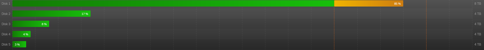

unraid newbie here so please forgive any faux pas. My Google fu has failed me on this occasion and if I am the only one having this problem then the likelihood is I have done something uniquely wrong.
I have a 5 disk setup + cache drive. 1 8tb parity, 1 8tb data + 4 4tb data. The two 8tb disks were new and used to create the array (1 parity + 1 data). Shares from my old freenas server where then mounted and the data copied over to a ‘transfer’ share on the unraid server. I then created a temporary Plex docker to test the mainly media files that had been copied over. So far I am happy.
Next I add the disks from the old freenas server and the cache drive. Great, so now I have a 91% 8tb data disk and 16tb of empty disk.
I want to distribute my media files because of the possible number of Plex connections, so my idea was to create shares for movies, tv and music including all disks, most free, split level 2. When I created the shares I noted that the folders for the shares where only created on two of the disks. Puzzled I attempted to copy all tv shows (using Krusader) from transfer share into the new tv share and notes that data was copied only to the 2 disks with the folders created and very unevenly towards the first disk.

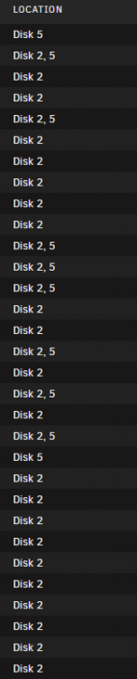

Thanks for sticking with me but I am not sure this solves my problem. My understanding of Split level 2, Most Free, All disks is that the first 2 levels of the folder structure are split across All disks and the 3rd level is placed on a disk with the Most free space. For the example above that should result in each season folder and its contents on 1 disk but the next season could be on any of the other disks. For this to happen surely when I create the share in the first place each disk should have a folder for that share? For me only 2 disks had the tv folder. Even if the folder is not create on every disk I would expect it to be when the copy of all tv shows starts or when the next disk meets the 'Most Free' criteria.
In my case this did not happen. Only the original 2 disks actually received any data and the distribution was nowhere near even. As can be seen by the stats and the disk locations of the share.

Sorry that was confusing. Spread is a much better word. My tv shows are not being spread across all my disks as specified. Only 2 disks have any data and that isn't evenly distributed.

as far as the distribution of data is concerned its possible.... i suppose. New to unraid so don't know how it deals with this. If it is the case it doesn't explain why only 2 disks are listed as locations for the share and why second disk gets any data at all.

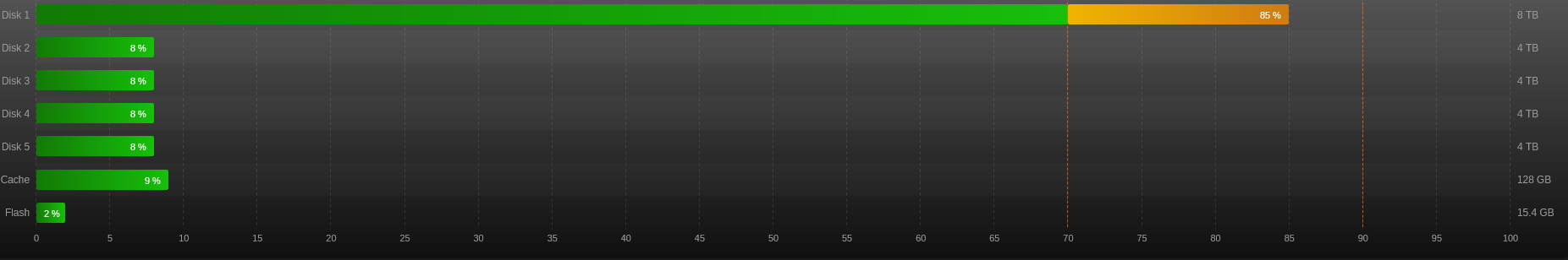

Scripting would have taken too long unfortunately so i used an unBalance dryrun to get the commands required. They obviously weren't right being disk to disk but some quick find an replace later and i have the rclone copy commands to run in a batch. I ran the copy of my tv shows overnight and thie result is attached. Perfect! Much quicker than krusader for this type of operation.
