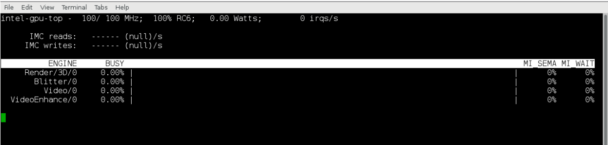

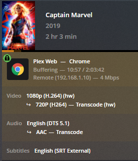

So far all looks good but when I force trasncoding by lowering the stream quality I get no video. It just seems to be buffering endlessly, yet in the dashboard, I can see HW transcoding is ongoing:
I have also checked the Plex logs quite extensively and it appears that the transcoder is working fine and is actually using HW acceleration as well.

Just an excerpt, full logs attached if anyone is interested in taking a look at them.
Any ideas as to why I am not getting any video even though the transcoder appears to be working fine will be much appreciated :)

However, as mentioned above, even though all seems to indicate that the transcoder sees the iGPU and is trying to use it, looking at the iGPU utilization through intel-igpu-tools, the device is idle :(
EDIT2: Just tried the official plexinc docker image instead of linuxserver's and it behaves the same.
