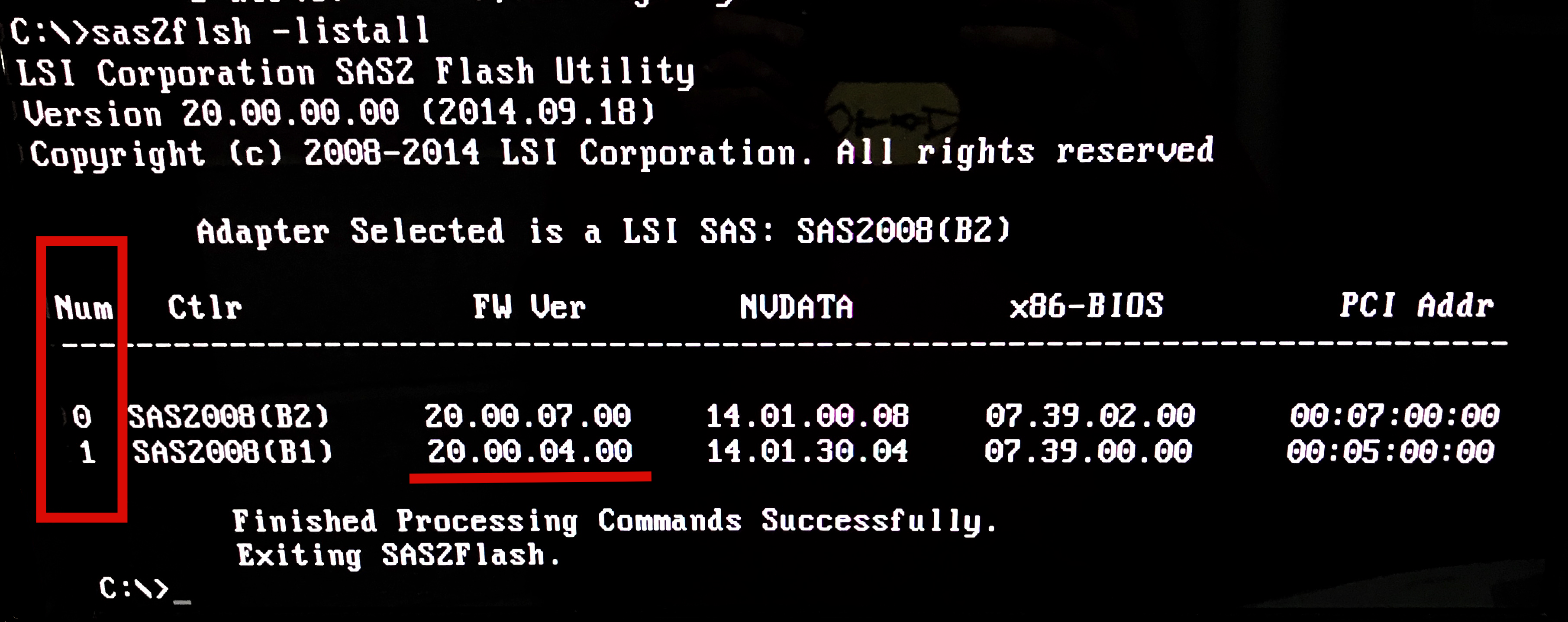

For anyone with multiple SAS controllers/HBA's installed in their system and you want to update controllers individually, you'll need to use the -c command to choose the specific controller/HBA that you want to flash, or otherwise execute on.  If you're unfamiliar with this command, here's how it works.  After booting into your DOS USB drive on the host machine, at the DOS thumb drive C:/ prompt, run the command:
sas2flsh -listall
This will list all your SAS 2008 controllers, showing columns for firmware version, NVData, BIOS, and PCI address.  Additionally, there is a first column labelled "Num".
So, in the above screen shot, you notice there are two SAS 2008 controllers showing, after executing the -listall command.  The controller named SAS2008(B1), designated with a "1" in the "Num" column has the older version, 20.00.04.00.
Use the number from the "Num" column, that is next to the SAS controller you are interested in flashing or otherwise executing commands on, along with the -c command, telling the flash utility to which controller you're referring.

The "-c 1" tells the sas2flsh utility to execute the commands on the SAS2008(B1) controller.  Since this controller happens to be a motherboard, there is one more thing that needs to happen.  We need to find out the address of the motherboard SAS 2008 controller BEFORE any actual flashing.
We need to know the motherboard SAS address in case we erase the SAS address from the motherboard SAS controller.  Then we can just write the SAS address back to the controller and it will match the SAS address on the sticker adhered to the motherboard.  Being consistent is helpful to avoid confusion or if we sell the motherboard.  And this only applies to flashing the motherboard SAS controller.  You don't need to do this to flash a SAS 2008 controller card (HBA).
