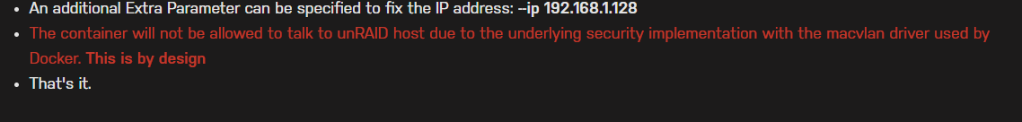

Solved by Mainfrezzer
Ok it is by design.
