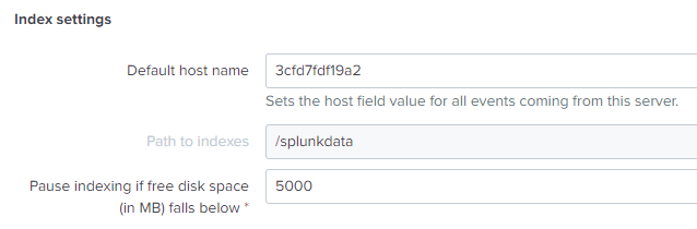

> Splunk index data location / splitting hotwarm and cold
You can't split hot and warm, but you can split hot/warm and cold. With Splunk there are a lot of ways to split cold data off into its own location, I'd use "volumes". Here's a link to the spec for the config file we'll be editing: https://docs.splunk.com/Documentation/Splunk/8.0.4/Admin/Indexesconf
In my docker startup script I run code to change the default SPLUNK_DB location to the /splunkdata mount the container uses. SPLUNK_DB contains both hot/warm and cold. OPTIMISTIC_ABOUT_FILE_LOCKING fixes an unrelated bug. We set this in splunk-launch.conf meaning the SPLUNK_DB variable is set at startup and is persistent through the whole Splunk ecosystem. As you correctly identified from Splunk docs, SPLUNK_DB is used as the storage location for all indexes data and all buckets by default, this config was made to split it off into a volume.
printf "\nOPTIMISTIC_ABOUT_FILE_LOCKING = 1\nSPLUNK_DB=/splunkdata" >> $SPLUNK_HOME/etc/splunk-launch.conf
1. Create a new volume in your docker config to store your cold data (e.g. /mynewcoldlocation)
2. Create an indexes.conf file, preferebly in a persistent location such as $SPLUNK_HOME/etc/apps/<app>/default/indexes.conf
3. Define hotwarm / cold volumes in your new indexes.conf, here's an example:
[volume:hotwarm]
path = /splunkdata
# Roughly 3GB in MB
maxVolumeDataSizeMB = 3072
[volume:cold]
path = /mynewcoldlocation
# Roughly 50GB in MB
maxVolumeDataSizeMB = 51200
It would be up to you to ensure /splunkdata is stored on your cache disk and /mynewcoldlocation is in your array as defined in your docker config for this container.

I tried to follow these instructions to the letter... unfortunately, every time I restart the container or just restart splunkd, all of my indexed data seems to no longer be searchable on restart.  The index data can still be seen in the persistant shares (ie. /splunkdata and /splunkcold).  If I stop splunk and delete everything in /splunkdata and /splunkcold, then splunk start. Everything will re-index again.  If I don't delete the data, I cannot search the data whether I restart or not. So some record of the files being indexed remains persistant in fishbucket db.
I have not idea why my other data seems to disappear on restart. I was doing some Splunk Labs for an Sales Engineer 2 accreditation and I spent half my time wondering why my files weren't being indexed... turned out that they had been indexed but on restart they disappeared and because there was data still in fishbucket they wouldn't be re-parsed with any changes I made and re-indexed.
Here are my docker volume mappings:
/splunkcold <> /mnt/user/splunk-warm-cold/  #this is a unraid cached array share for cold buckets
/opt/splunk/etc/licenses <> /mnt/user/appdata/splunkenterprise/license #I persist a developer license here
/test <> /mnt/user/appdata/splunkenterprise/test/  #ingesting test files from here
/opt/splunk/etc/system/local <> /mnt/user/appdata/splunkenterprise/etc/system/local   #indexes.conf lives here
/splunkdata <> /mnt/user/appdata/splunkenterprise/splunkdata #hot-warm data is persisted here on ssd cache
/opt/splunk/etc/apps <> /mnt/user/appdata/splunkenterprise/etc/apps
/opt/splunk/etc/auth <> /mnt/user/appdata/splunkenterprise/etc/auth
Here is my indexes.conf stored in /opt/splunk/etc/system/local which is persisted to a share (/mnt/user/appdata/splunkenterprise/etc/system/local):
