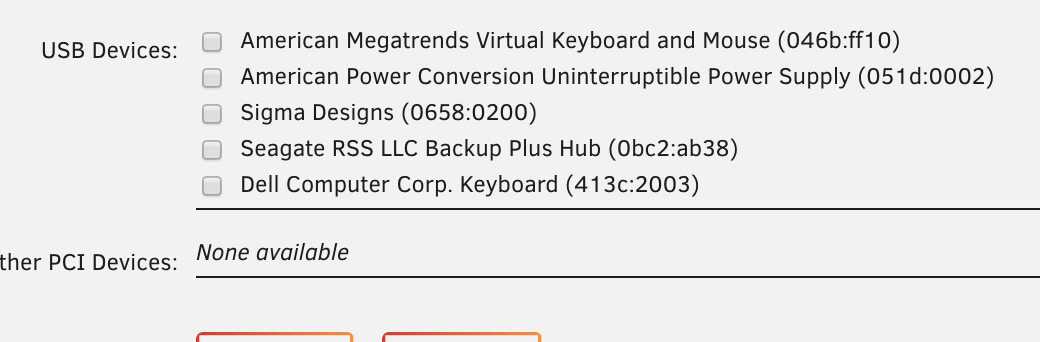

I have a "Aeotec Z-Stick Series 5" Z-WAve USB Key plugged into my unraid machine.  I've been using it with Home Assistant in a docker for over year without issue.
I have recently moved to use Home Assistant with the "HASSIO" variant in a VM. Everything is great with Home Assistant as I get this new setup configured.  I'm not at the stage where I want to setup my ZWAve devices, but then I noticed I can't see the USB stick in Home Assistant in the VM.
In the VM configuration page, I don't even see the stick listed in the available devices to passthrough, but I don't see other devices:
Is the issue something to do specifically with inability for this particular ZWave USB stick to be passed through to the VM? Is it a port issue?  SInce  I see other USB devices, it seems like it should be possible.
Turns out the stick was the “sigma designs” one already in the list. Doh.
