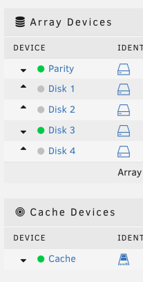

hi there,
some of my disks will not spinning down.. actually they just come up a couple of seconds after pressing the spin down button.
> Parity Disk
> Disk 3
Folders on this disk as listed as shown on the screenshot:

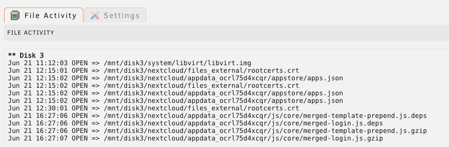

- installed the File Activity plugin (just found some activity on cache, not on disk3)

On the File Activity log there is no activity between 12:30 and 16:27 - but the disk is still spinup on the gui.
Does anybody have a clue why?

But what about the file activity log?
There is no Nextcloud activity on disk3, I just have writing's on cache.
