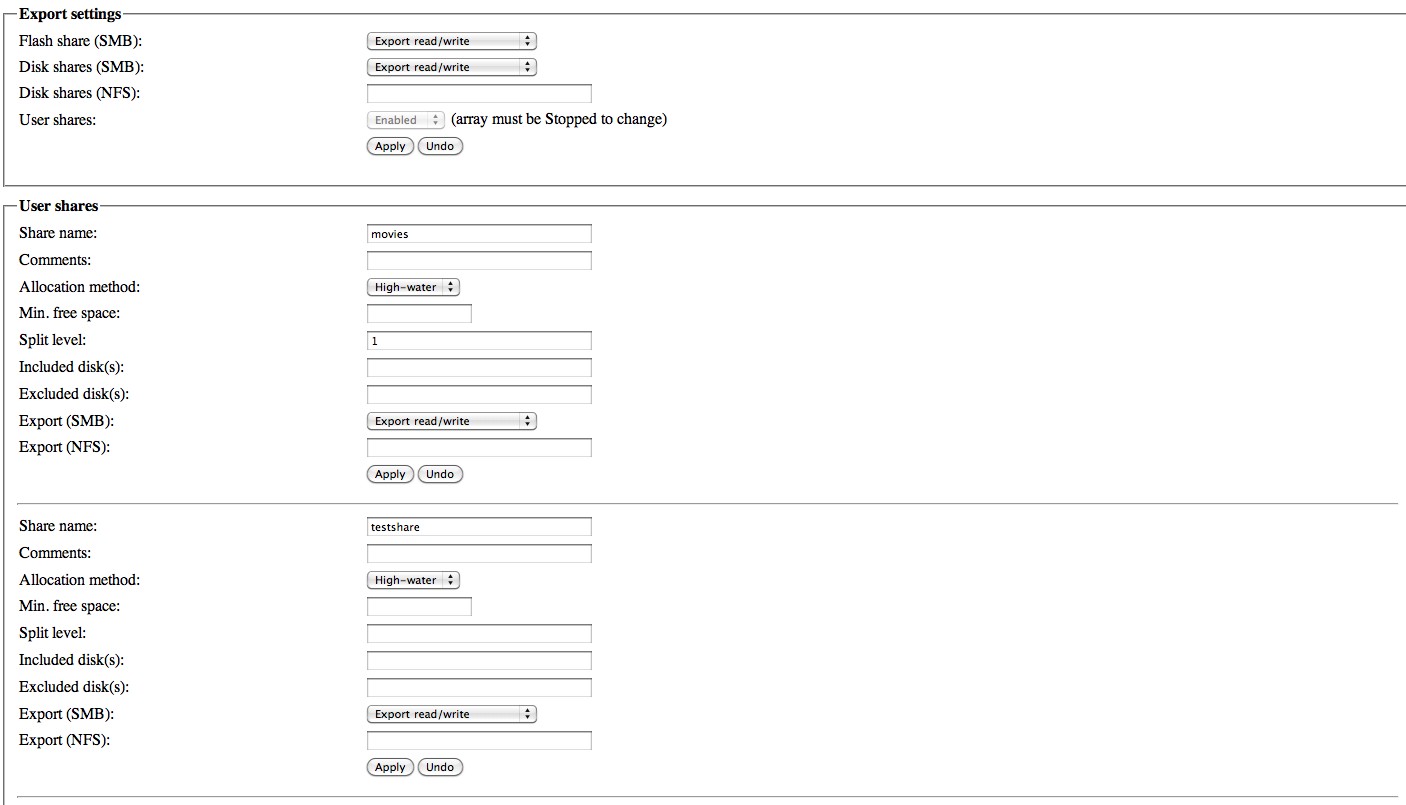

This is a picture of me share setup:

Can it be possible that user shares are not accessible in general using FTP?
I get access to the user share using SMB without problems:
smb://xxx.xxx.x.xxx/movies
Using FTP I don't find the share folder under
/disk1
/user
Bye.
