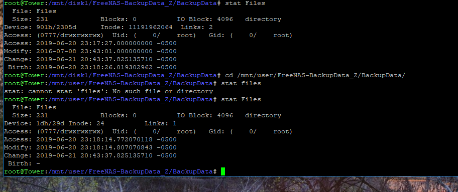

  I used rsync to copy some files over from a FreeNAS server to my UnRAID server.  Once done, I noticed the directory timestamps were incorrect on the UnRAID share.  I tried to change them via the 'touch' command -- no change.  I tried to change them via a Windows program called 'Directory Report' -- no change.  I stopped the array and restarted it, still no change.
  I then decided to look at the directory on the individual disk and noticed that it's info looked correct (stat command).
  Why can't I change the directory modified (mtime) time of a directory via SMB.  I can do this on FreeNAS.  I have scoured the Internet and have looked through all the UnRAID settings - can't find anything.  Also, why is the info different between the share mount and the actual disk info?
Any help would be greatly appreciated.  Thanks!

  Thank you for your response.  Yes, timezone is set correctly for the server.  Again, the information appears to be correct on the individual data disk, just not on the Samba (SMB) share.  I'm wondering if something more needs to be set/configured with the share settings, since most of the stuff is out of the box default.

  I am only running SMB at the time.  My issue is primarily focused on Windows clients connecting to the UnRAID box.  I have thought about setting up an NFS client on Windows 10 and also setting up the corresponding NFS share on UnRAID, but haven't messed with that yet.
  I also ran the Docker permissions settings change and still same results.  I am unable to change the directory on the Share.  However, like I stated previously, the changes do make it to the actual folder structure where the files are physically stored (individual disks).

Abzstrak,
  I took your advice and enabled the macOS setting in SMB settings.  Doing some testing, it seems to be working and retaining the original folder dates once it's copied over to UnRAID.  I'll keep testing, but the results so far look promising.
