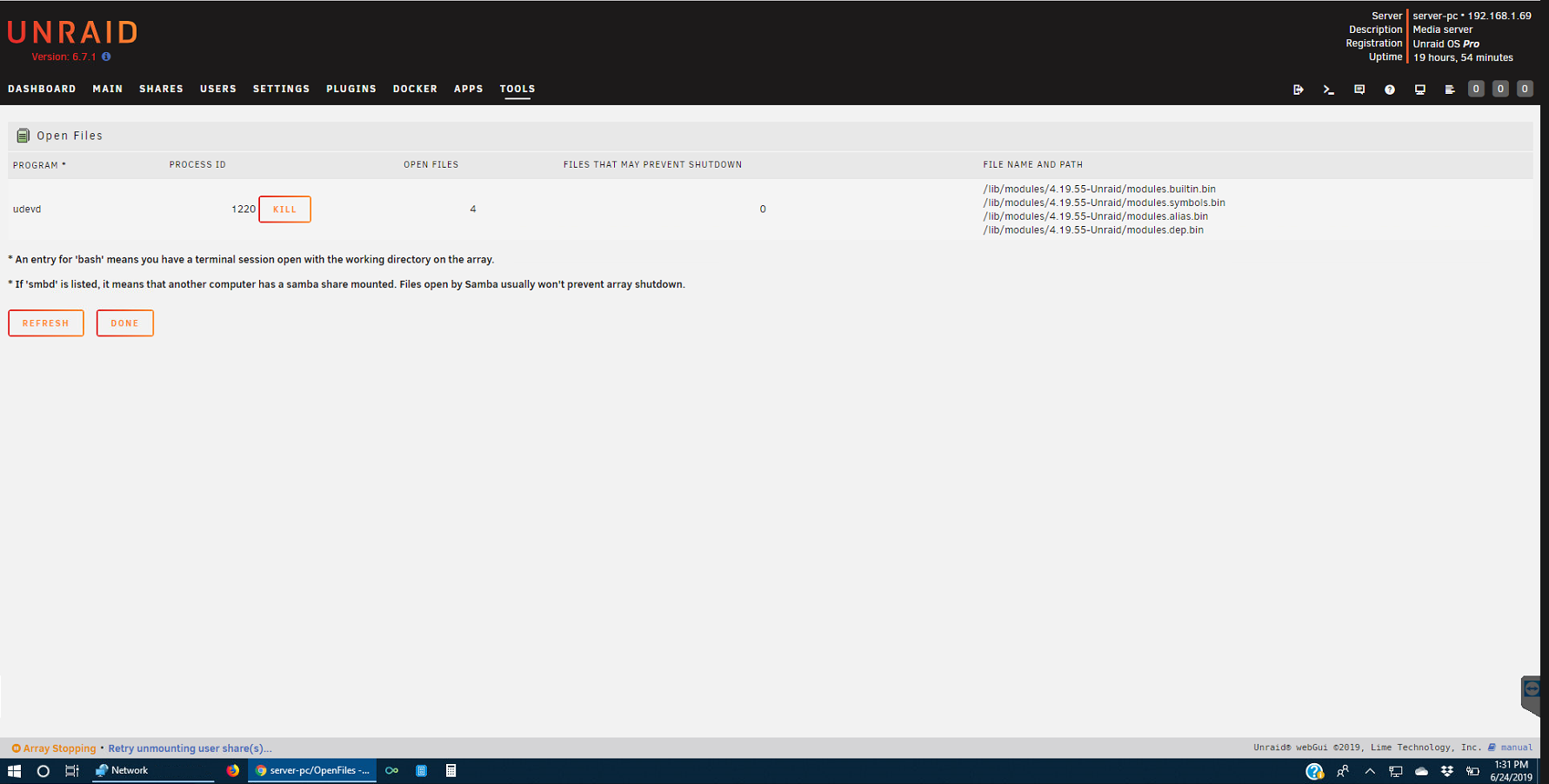

Some plugin or Docker has some files open on the array and the unmounting process can't close them.  A simplistic answer-- but I would suggest that you Google this:  Unraid: finding Open files
There's a tool called Open Files. When I checked it as the system was hung up, this is what it showed.
This is one that I have not run into before.  I tried to see if I could create it on my servers but could not.  However, I have my SMB shares set up as read-only.  I also suspect that you have an SMB shared file that is opened for read-write operation.   I could easily see how that type of access could cause a problem if the file was closed arbitrarily before the using application had finished with its file writing operation.   I see that you are running WIN10.  Are you mapping any user shares as Windows drives?
