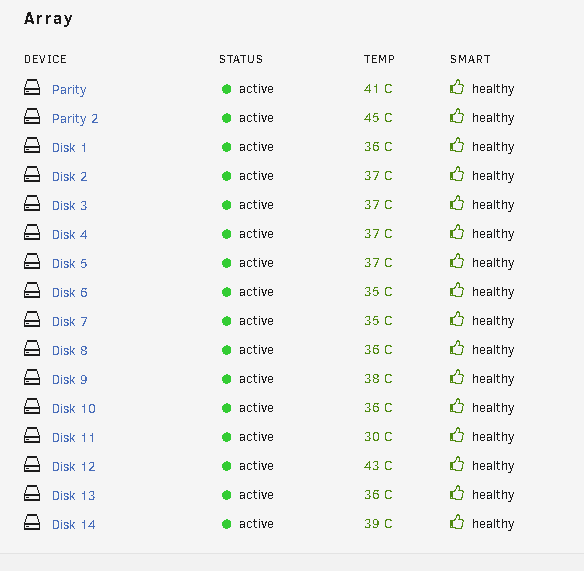

Hmm, I do not see that error.
Would I see that as  Smart error??
Or would that be a cable issue?
For now they are not reported as pending sectors, so not the usual monitored attributes, but you should be getting an "array has errors" system notification, also the problem can be seen on the SMART report, this attribute should be 0 on a healthy WD drive
