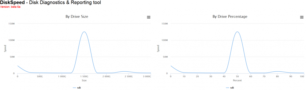

This is what I got for my drive
From your SMART, writeback cache in disable !?
It shouldn't affect read speedtest, but you got a problem curve.
I"m, obviously, a noob at this stuff. So, yeah I don't know what that means
May be ref below post to confirm SAS drive writeback cache status or how to enable it.
Thank you, though it is not clear to me what that setting does
