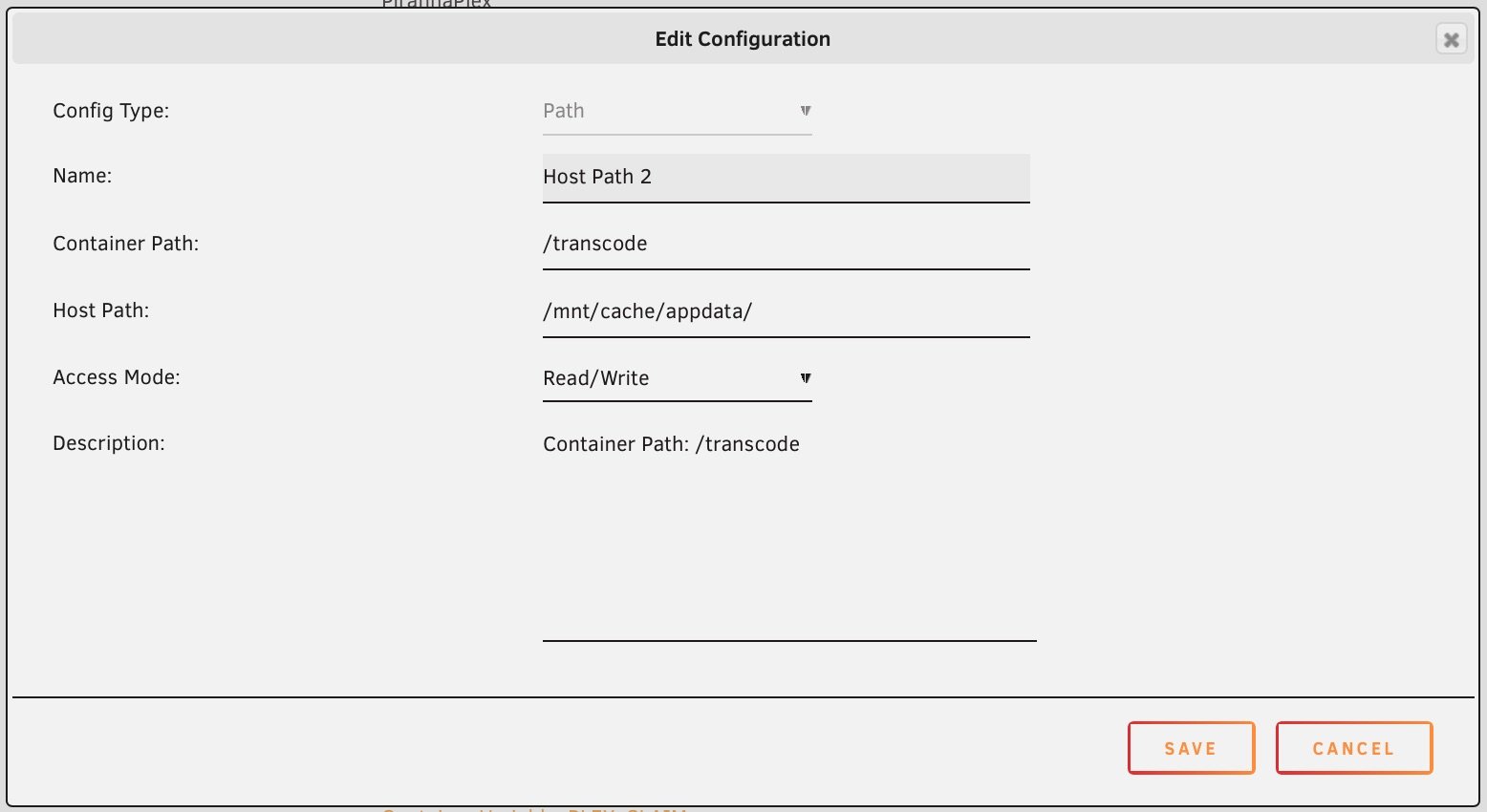

So I just threw a URL in for Transcode and this time the reinstall appears to have worked. Will actually have to test it later though. Also... can I use a disk mount for an unassigned disk for the transcode path? How do I export an unassigned disk as a share so I can access it to actually create the directory I specified in that path again?

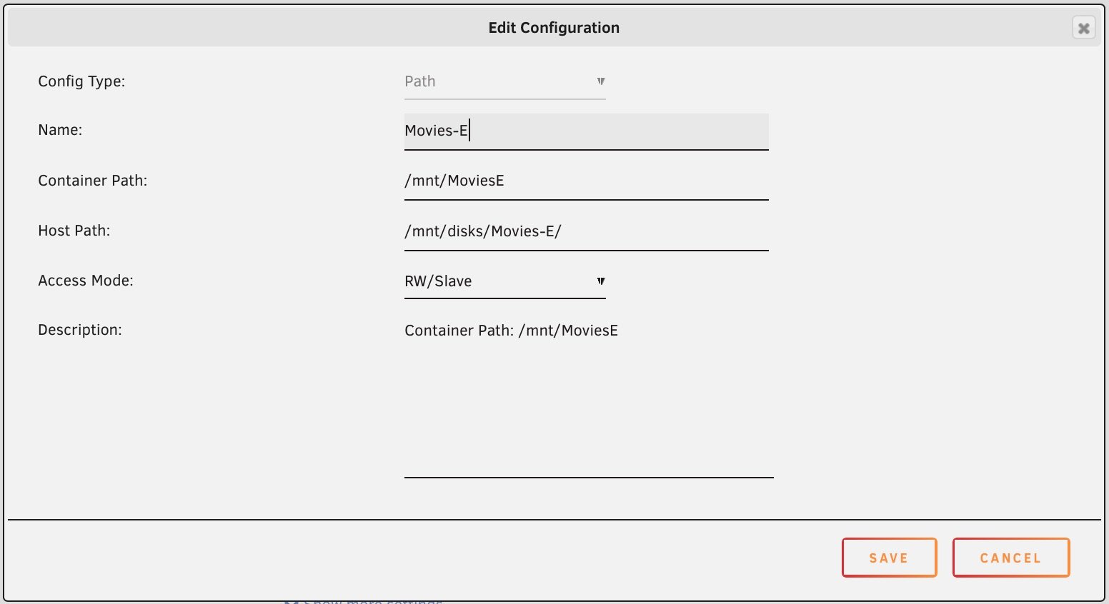

Yes - you can use a UD device.   You do not need it to be a share as you give the Linux level path name (it will be something like /mnt/disks/XXXXXX) at the Unraid level when setting up the mapping.   If using a UD mapped device with a docker container then you want to use either Slave:R/W or Slave:RO access modes.
As @Squid said, the UD mounted drive can be mapped directly, but you can also enable sharing for that drive by enabling the Share switch for that drive in the UD section of the Main tab. But the better method is to map the UD drive to a mountpoint in your Plex container. The image attached shows one of my 10TB drives mapped to the mountpoint /mnt/MoviesE. The Name field isn't crucial, but the Container Path Host Path and Access Mode should be set. Choose the 'Add another Path, Variable, etc' option to create this mountpoint path in your Plex Docker container. When you click in the Host Path field, you navigate to /mnt/disks and choose the UD mounted disk that you want available in the Plex container. Save your new path and then Apply it to the docker container and you'll have access to it in Plex. I chose RW/Slave for the Access Mode as I want to be able to delete media from my UD mounted drives from within the Plex interface.
Edited by AgentXXL
@TyantA As you want your /transcode path to be on a UD mounted disk, you just need to edit the default path for /transcode that's already in the Plex docker container. The attached image shows my /transcode mapped to my 1TB cache SSD, but in your case you want to change the Host Path to /mnt/disk/{yourUD-disk} and change the Access Mode to RW/Slave. It needs to be RW for /transcode, not RO.
