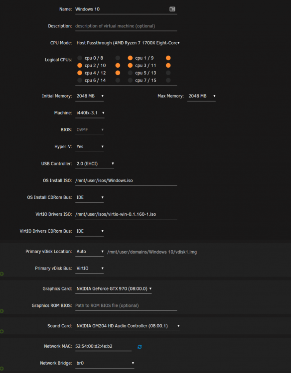

Unfortunately I don't know how to get the xml for the VM so I've included a picture ( no usb devices are currently passed through ). I have also included my diagnostics.zip
