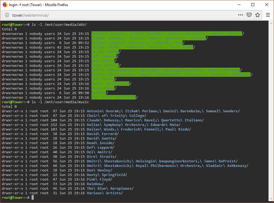

Open up the Terminal Window (on the Tool Bar of the GUI--   it has the icon   >_   )  and use the following command
ls -al /mnt/user/
Now hit the up-arrow key and add the name of the Share that you are interested in after the last /
Repeat until you get to the directory/files you are interested in.

Thankyou, that solves it, I was not aware of the Terminal option.

So this was done with my own SongKong app, Im looking to improve it to avoid this issue but first of all I need to better understand how unRAID permissions worked in the first place.
Terminal matches Windows

The files are moved to a different location, and I have just realized the issues is not with the file themselves they preserve their original owership and permissions, the problem is that the directory structure that was created to move the files to is owned by root with only rx permission for everyone. so this means the files contents can be edited but the files cannot be deleted or renamed, and new files cannot be added to these directories.
Setting umask to 000 will provide permissions to everyone, but Ideally I want to work out in my docker ap how to create the folders as the correct user.
