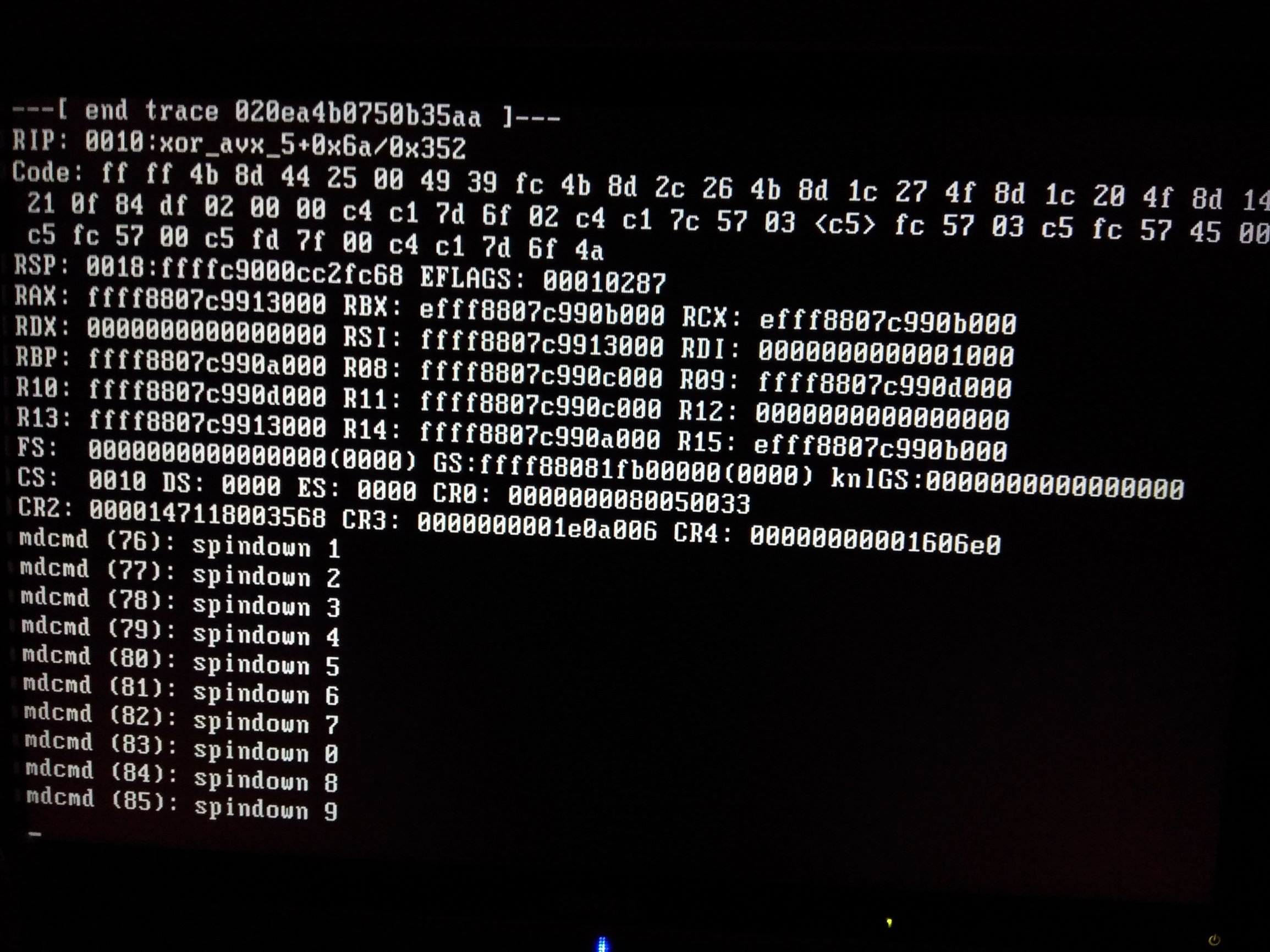

Hello All,
     I'm kind of at a loss here. Please help if you are able to offer any possible fix for my server. Thank you

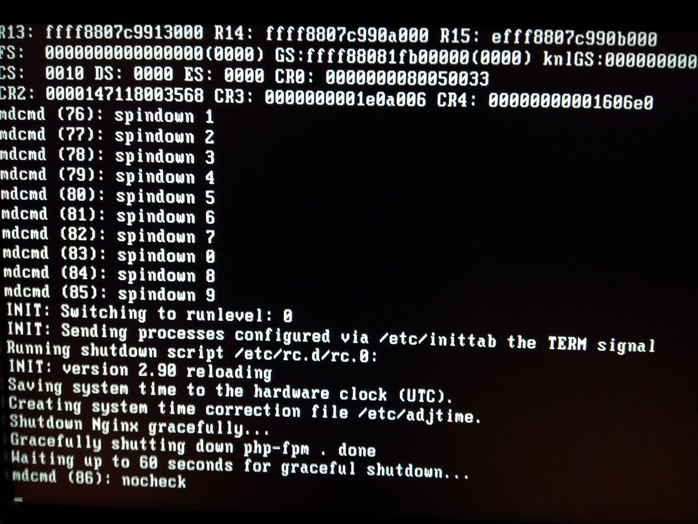

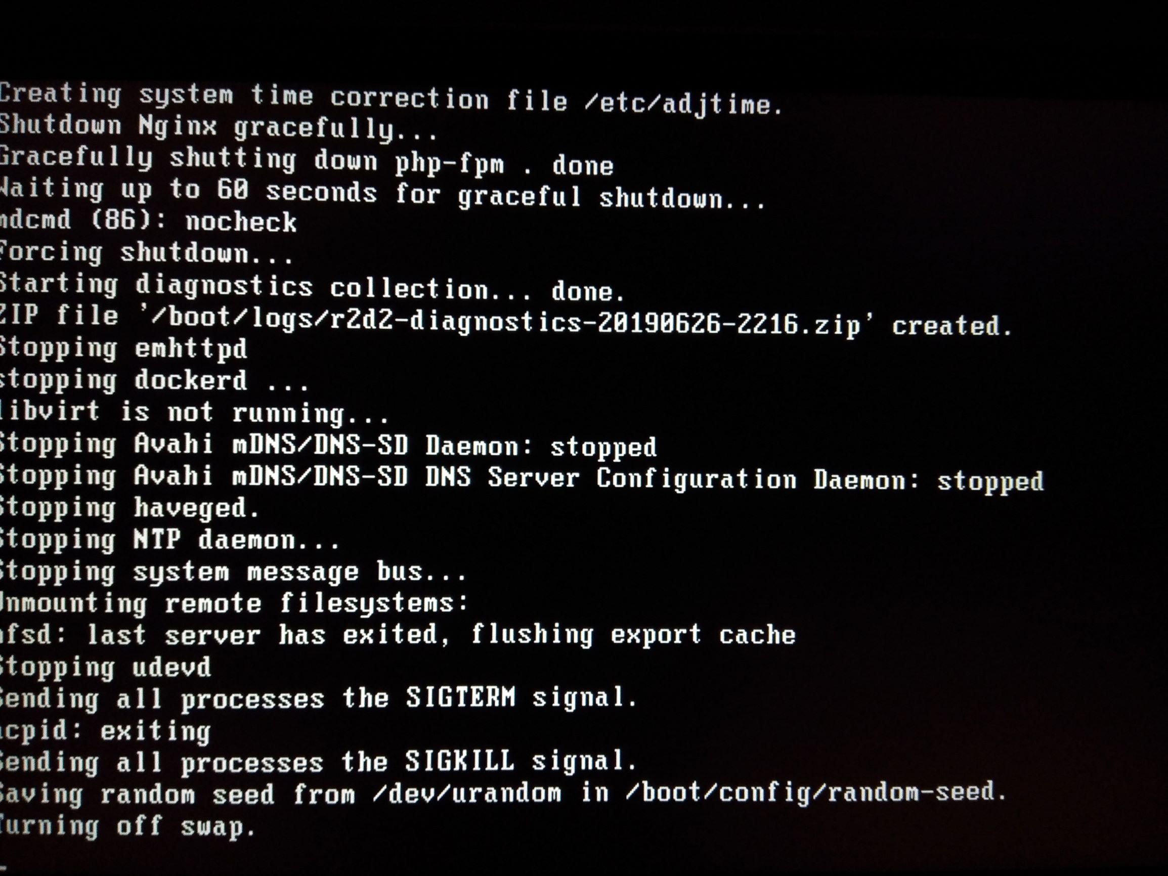

I have  2 logs I have to hopefully show whats going on inside my server from today.
I have included monitor screen shots of what was on the screen when I walked to it and then having to press the power button on the tower to force a shut down which never came to be only did what is displayed on the screen.
The log ending in 2226 I believe to be the log I created just after turning the server back on and saving it.
Thank you for your time and help,
C

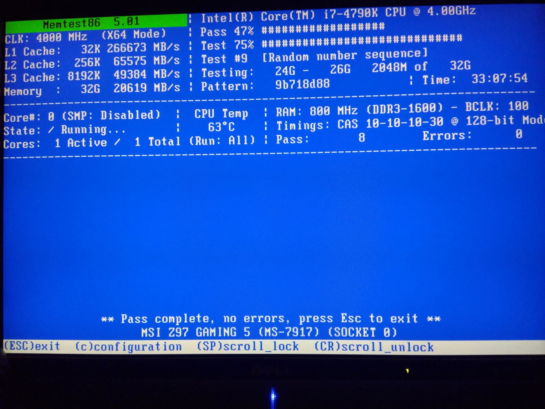

You should start by running memtest
So I ran and I'm still running MemTest but thankfully no errors as simple as that could be I'm still stuck. Anything else I need to be looking at?

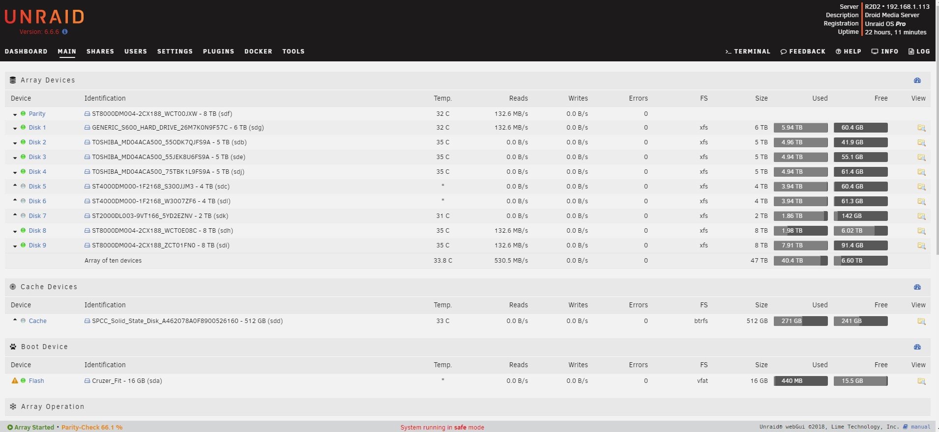

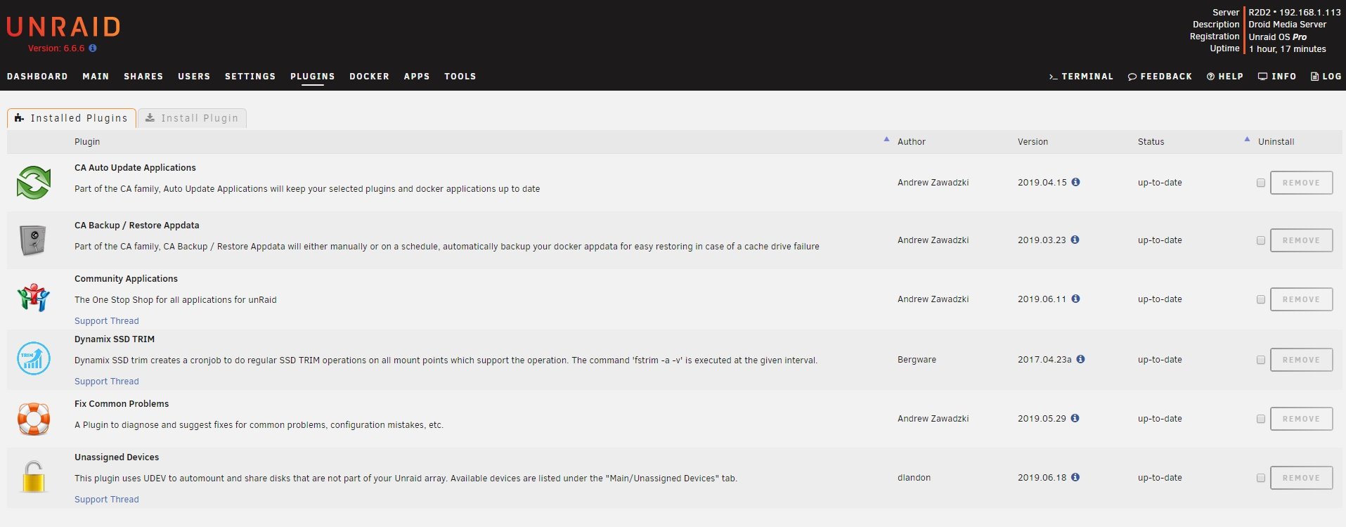

Okay Started it in safe mode with no plugins and dockers off

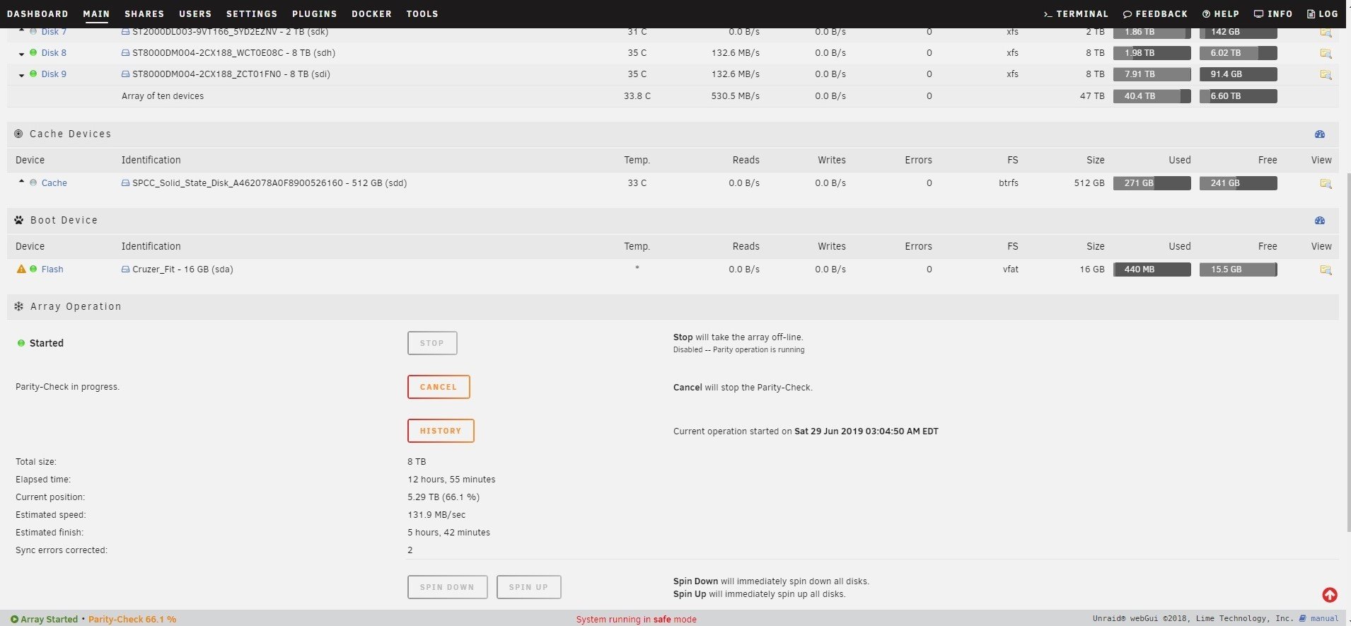

Parity Check is running. I assume I let that run and try to finish?
Please advise.
Thank you again.
Yep
