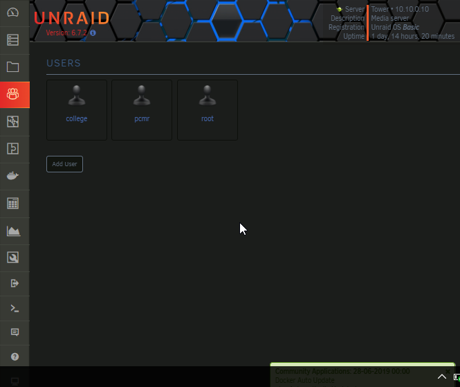

3--  Are you trying to logon as root?   (root is not allowed as SMB client user!)
I know have user with the same as my PC logins.

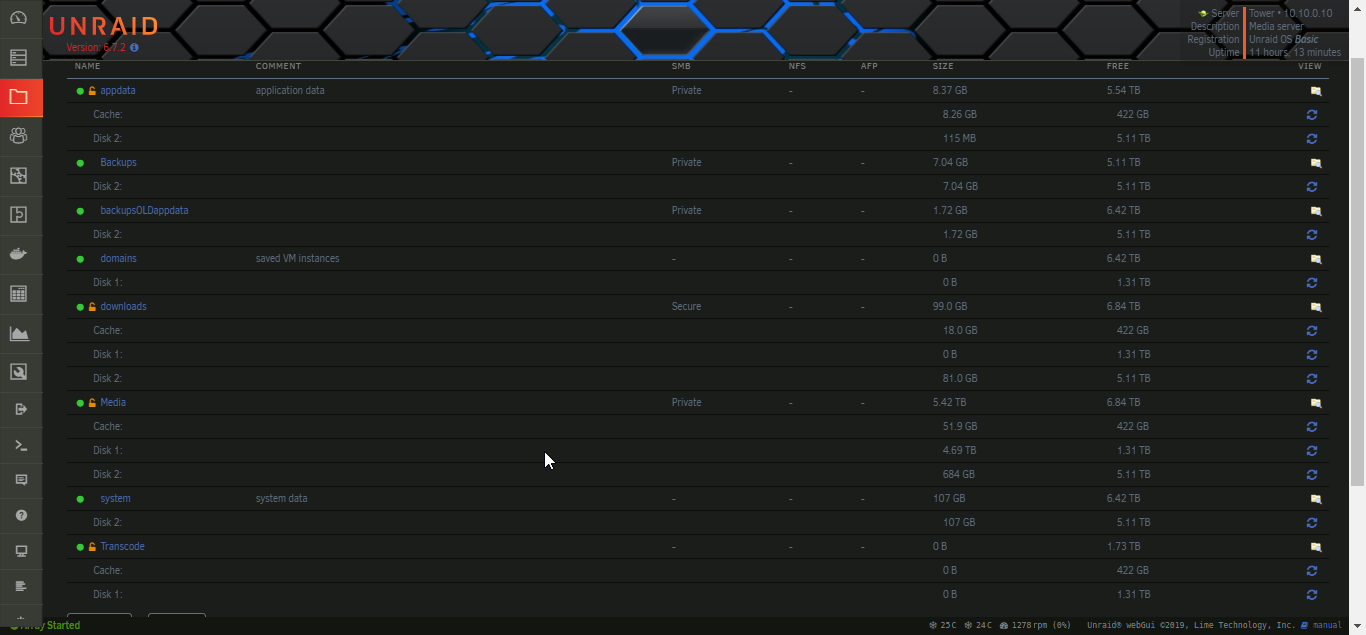

Add screenshot
Your Diagnostics file is showing 148 shares!!!  (Because the diagnostics file is automanized for your privacy protection, I can't tell what the Share names actually are.) When I look at your screen capture, I see eight!  Something is going on.
Look at Share Tab/page again.  See the Compute All button-- Use it to run a Sanity Test.
See the folder icon under the View Column for each share-- Use it to browse each share to make sure everything looks right.
Be sure to actually take a look at your Diagnostics file to see if you can figure what is being shown.  You know what is in your shares, I don't...

It is showing a lot in the shares folder in diagnostics/flash drive folders as when I was rebuilding my dockers I accidentally set the Radarr movie path to the share folder somehow and it created folder aka shares. Fixed the path issue with radarr and deleted the shares in the gui, which left the .cfg files in the shares folder with 148 folders.
I shutdown removed the flash drive and deleted all the blank movie folders from the shares folder and now they aren't there.
Can I send you a non sanitized diagnostic privately?  Or is it safe here?

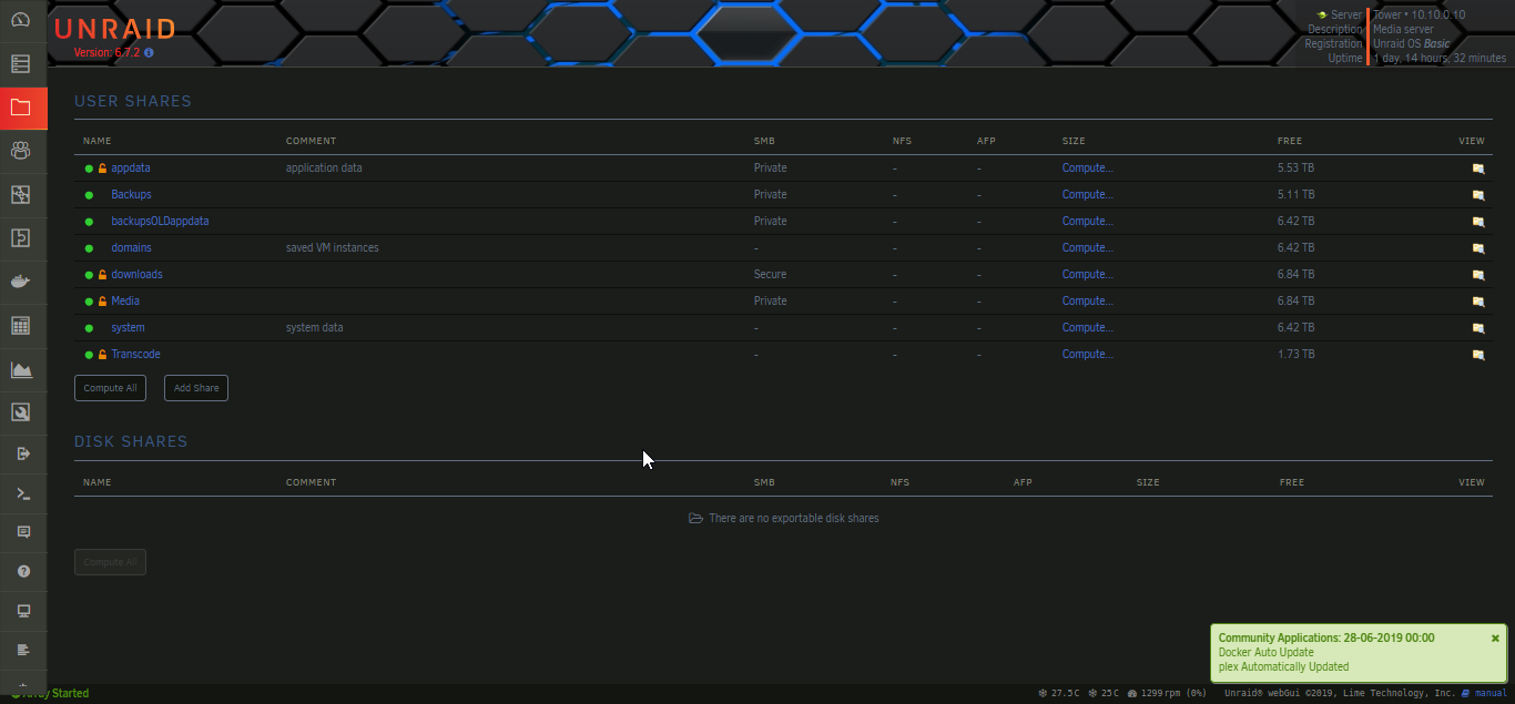

Screenshot is after the compute all.

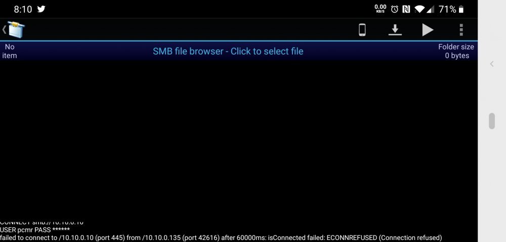

Correctly SMBv1 is enabled, I turned it off while troubleshooting.
I have tested public/secure shares also and tried file explorer with the server IP and \\tower.
I am a IT networking professional and have attempted all these troubleshooting before posting.
I believe at the moment the unraid server isn't accepting any SMB connections. Which is the root of my issues. I don't see any SMB logs at all in syslogs or anywhere in the diagnostic files. You happen to know where these would be logged, if logged?
Notice that there is a share 'downloads'.  Yet, in the latest syslog there is a notation that it does not exist.  The share is later created.  The entire sequence is quoted below.  Do you have any idea what is happening?

I deleted the downloads share and rebuilt it as the syslogs previous seem to point to an error while trying to link downloads to SMB.
This seem to fix that error but still no luck.

5 hours ago, Frank1940 said:
You will see that these files in the shares folder will be regenerated with the default settings if they are deleted.  You indicated that this folder had a lot of extra entries in it and I am thinking that may be misconfiguration/syntax errors in some of them.  I am wondering if deleting all of the entries in the shares folder might be a way to fix the problem.  OF course, you will have to reset the security on all the shares after you did this but few screenshots of the present settings should make it easy to set them up again.  IF you decide to do this, make a complete backup copy of the flash drive before you start!  You can do this from  Main   >>>   Boot Device    Click on 'Flash'  under the "Device" column, then look for the 'FLASH BACKUP' button under the   "Flash Device Settings" section.
Wiped out the Share folder and reset the permissions. In the logs getting the
