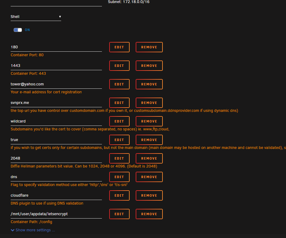

this is my letsencrypt settings lets.thumb.png.6d215040e3b674d24b9cc05128f16525.png
i have change subdomain now to nexcloud only and same error

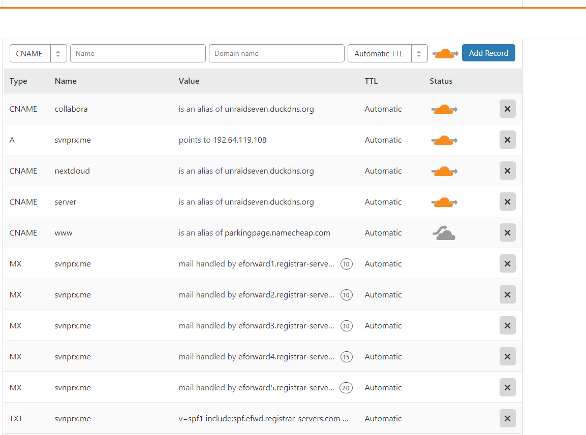

this is what i have in cloudflare CloudflareDNS.thumb.png.ccd1c5dd4c6fc6277779d0f1c4c1a583.png

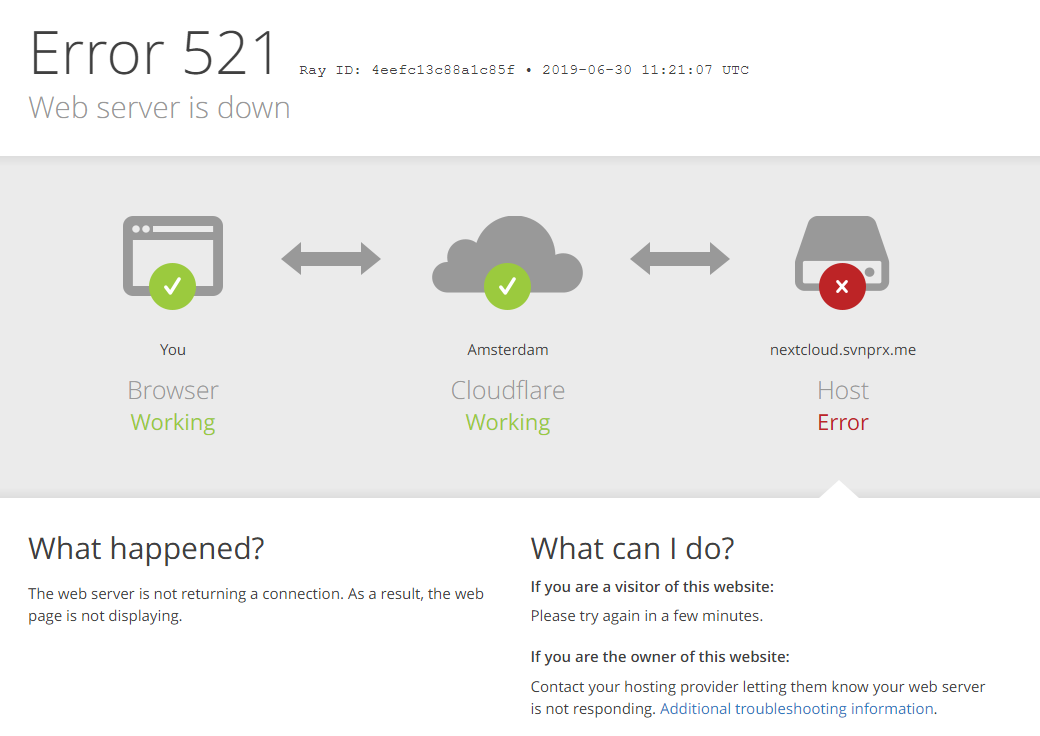

and i get this errors (521 or 522) 1406432894_err521.thumb.png.676ebc521e62f4ce78dd69688491952e.png

The basics to me would be that you can ping (from an externally connected device), unraidseven.duckdns.org.  Bear in mind you've got cloudlfares security on in the screenshot which hides your real IP.  You might like to turn it off for testing purposes (click on the orange cloud once) and maybe give it some time to reflect the change.
I'm not actually sure what svnprx.me is, it doesn't seem related to anything you've got in cloudlflare, so perhaps have a look at that.

Have you forwarded your firewall ports from 443 to 1443 and 80 to 180?  The way you have configured it above will need that.  Alternatively, you can change the ports that unraid is on (make sure you write them down otherwise you may lock yourself out).  I chose to change the ports unraid is on as it meant that I could access the letsencrypt hosted platforms inside and outside my network in the same way.

You gotta disable Cloudflare proxy (the cloud next to your domain).  And don't use cnames.

It does take a little while for that change to take affect.  Basically with the cloud on it proxy's a Cloudflare IP to your real IP, so if you ping your domain, it will come up with a Cloudflare address, vs if you turn the cloud off, a ping will come back with your real IP address.  It would pay to test that on your client before confirming it doesn't work.  I assume that it's working internally OK?  And also, I strongly recommend changing unpaid's 80 and 443 ports so that lets encrypt can use them.  Things just work better / and are more consistent, particularly when you're internal.  Failing that, I'd suggest you share a little more of your config.

If anyone comes to this post, the information provided by @Marshalleq worked as a solution to getting Cloudflare to work with my Nextcloud instance.
1) Don't use the Cloudflare proxy, use them just for DNS
2) Use A records rather than CNAMES in Cloudflare
3) Changing Unraid ports to something other than 80 and 443 (Settings ---> Management Access in Unraid)
4) Make sure to have correct forwarding ports in router/firewall rules
