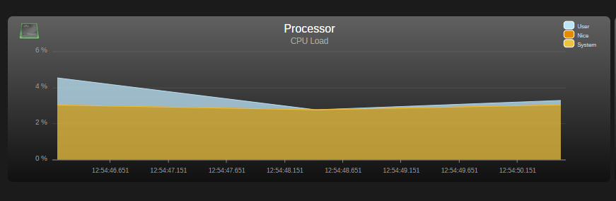

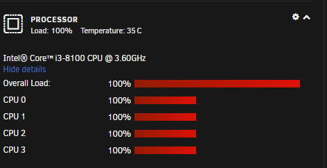

Edited by proud_noob
Added CPU usage pictures.
