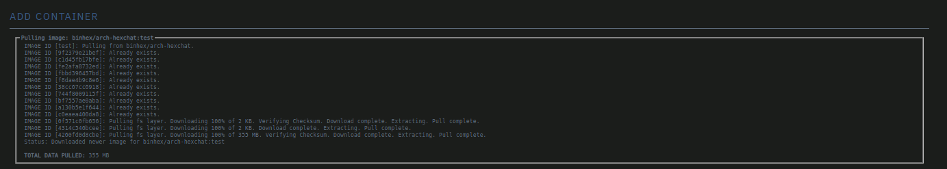

But - im using 3 of your docker images (at this point, thanks for the work) and they are all a bit "huge"
So, is there a way to optimize this or this already optimised as written above?
the size of the container does not take into account layers shared, for instance if you re-downloaded krusader you would see the amount of data pulled down from docker hub would not be 2.47 GB, it would probably be more something in the range of 300 MB. plus when looking at sizes you should be looking at the image size not the container size, unless you of course have an issue with balloning containers (nearly always due to misconfiguration of the app).
in short, nope there is nothing you can do to optimise this.
to prove im really not telling porkies :-), check the pull size of hexchat for me, this is due to me having the intermediate image already, which you should also have:-

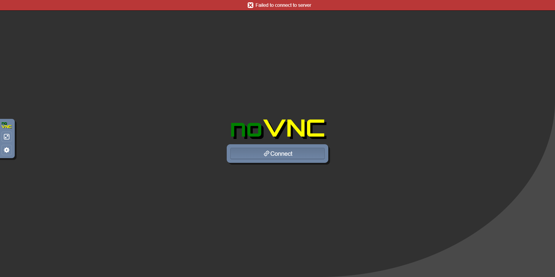

20 minutes ago, Danuel said:
now the app is starting but i get `failed to connect to server` to VNCserver
try clearing down cookies and/or trying a different browser, also post a screenshot of what you are seeing.
logs + screenshot
if i roll back to 2.16.1-3-01 is working
binhex-hexchat-2023-05-10T11-53-02.log
1 hour ago, binhex said:
it looks to me like you aren't running the latest image, go to unraid/docker then toggle basic view to advanced view, then click on 'force update' for the container, this will then force download the latest image.
 i can confirm, that  foce update fix the problem
