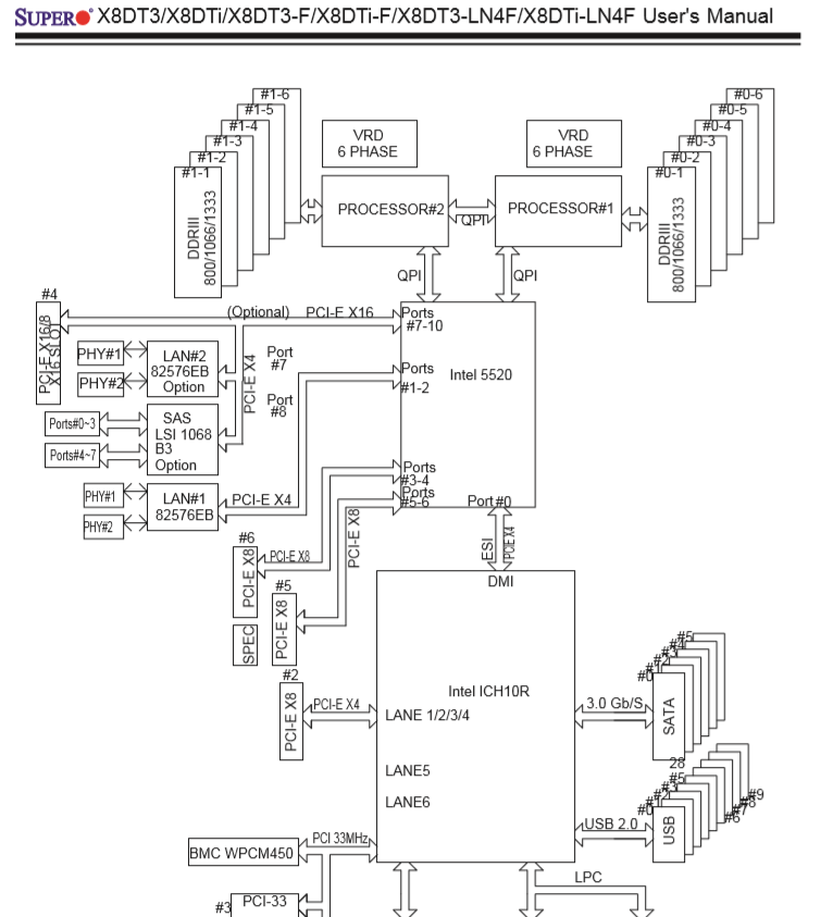

Don't buy it, it use LSI 1068 for connect HDDs ( if search correct ), it only support max 2TB.
