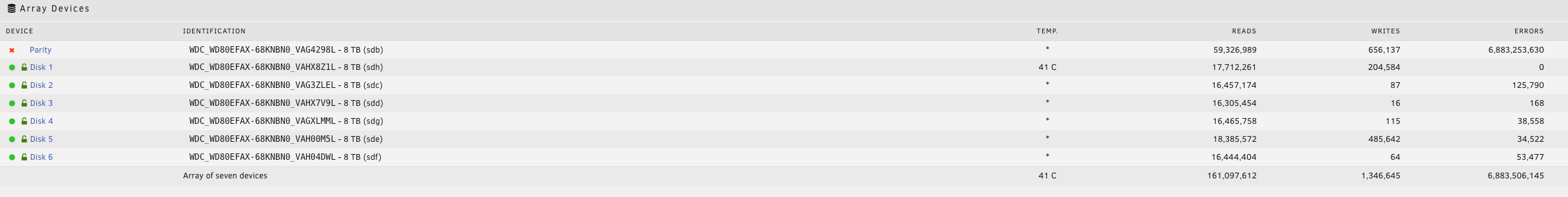

I woke up this morning to my log directory full and hundreds of read/write errors across all of my disks.
846492016_ScreenShot2019-07-03at12_58_33PM.thumb.png.f7466cfb09a8305e08a3262b106c3146.png

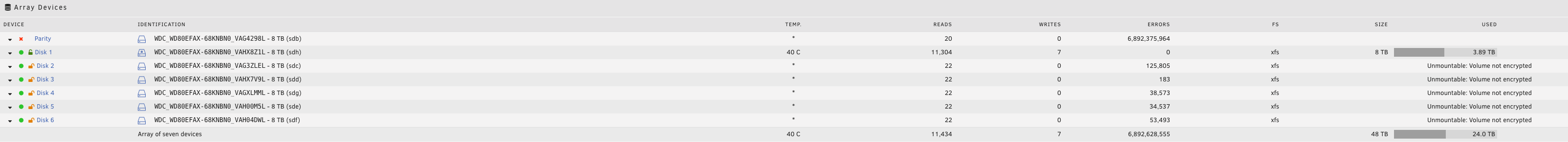

I immediately stopped all of my docker containers. What would be my next best course of action? I stopped the array and restarted it and now I'm seeing all of the disks are unmountable:
1347178061_ScreenShot2019-07-03at1_01_10PM.thumb.png.030dae86a0947defb4625951f03d4ff3.png

I suspect that all drives dropped offline for some reason and that the data may be fine.      Provide the system diagnostics zip file (obtained  via Tools >> Diagnostics) to get more informed feedback.
I rebooted into my bios to see if the drives were detected there. Thankfully, they were. After that I rebooted back into the OS. Started the array in maintaincence mode and all of my disks were detected properly. The parity disk was showing that it was disabled so I followed the steps at https://wiki.unraid.net/Troubleshooting#Re-enable_the_drive to re-enable & re-build the parity. Currently the re-build is occurring but it looks like all of my data is still intact.
Is there anything else I should be doing in the mean time? Perhaps this was related to the onboard controller of the motherboard. I've exported the diagnostics file (after rebooting) though I suspect they are useless now. I should have thought of that before..
