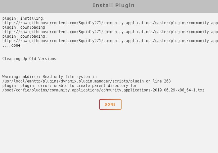

Hi there everyone! I am relatively new to Unraid, and have just started getting it setup. However, when trying to install my first plugin, I get this error. Any recommendations to solve this issue?
Thank you!

It appears that key /boot/config/* files are set to read-only  That is the USB flash drive.  Try removing your boot flash from the server and running a chkdsk on it in a Windows machine.  It will likely find and correct file system errors and then the server should boot properly and you should be able to install plugins.

In any case, the diagnostics show what I already suspected. Your flash drive is corrupt. Shut down, put the flash drive in your PC and let it checkdisk.
Are you using a USB2 port on your server to boot from? USB3 ports aren't as reliable for the boot drive, so USB2 is recommended.

Okay thank you for the help, I will try that!
