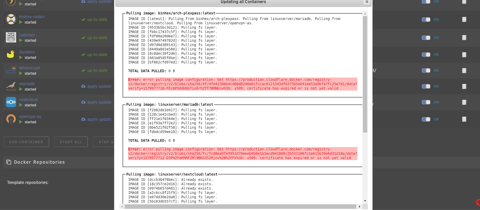

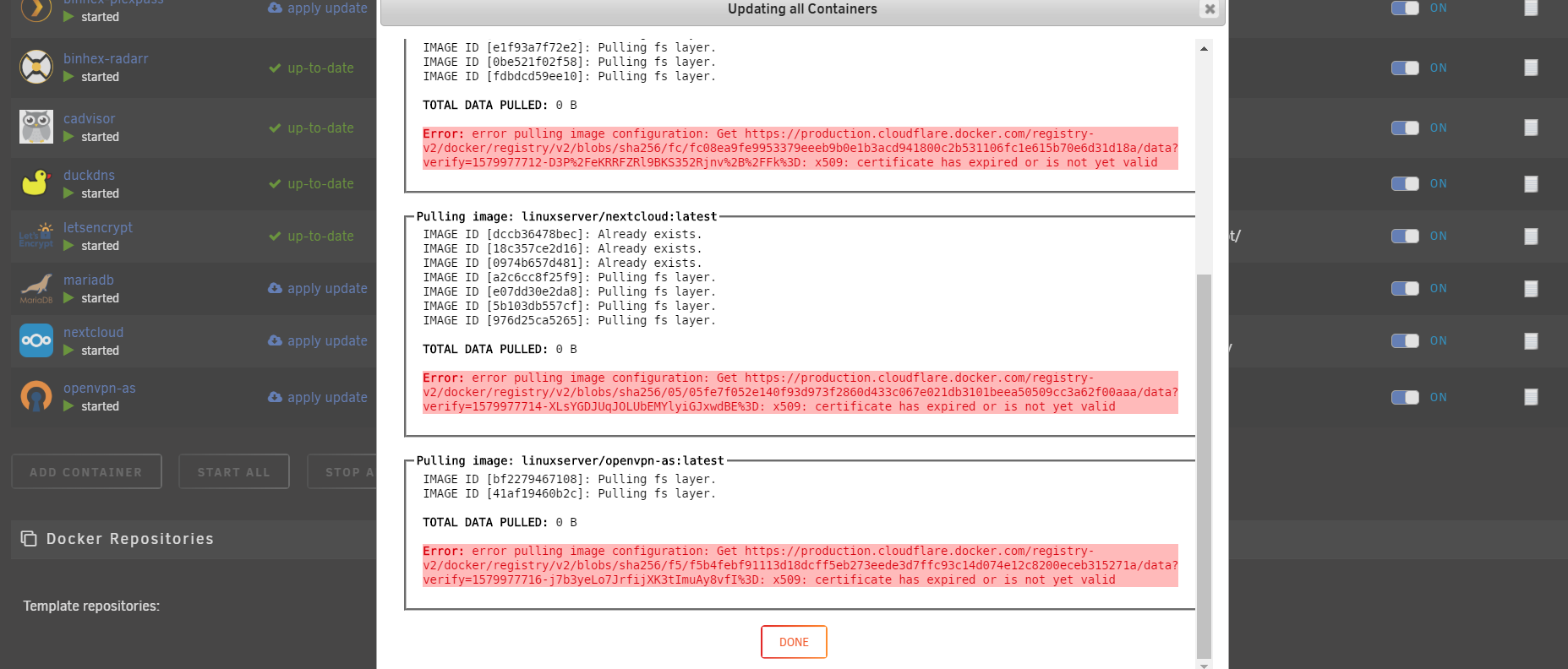

I am having the same issue. It first started after I updated to 6.8.1, I even reverted back to 6.7.2 with no success. I am new to UNRAID and have been looking for a solution on the forums and this thread is the closest I found. I had 3 dockers that won't update and now another joined the list for a total of 4 containers that won't update. Here is what it's spitting up after a failed update, any help will be greatly appreciated.
On 7/4/2019 at 7:10 AM, Squid said:
Is your date and time out to lunch?
I read that in the previous response and have no idea what that means. How do I check if my date and time are out to lunch? Sorry....total newbie here.

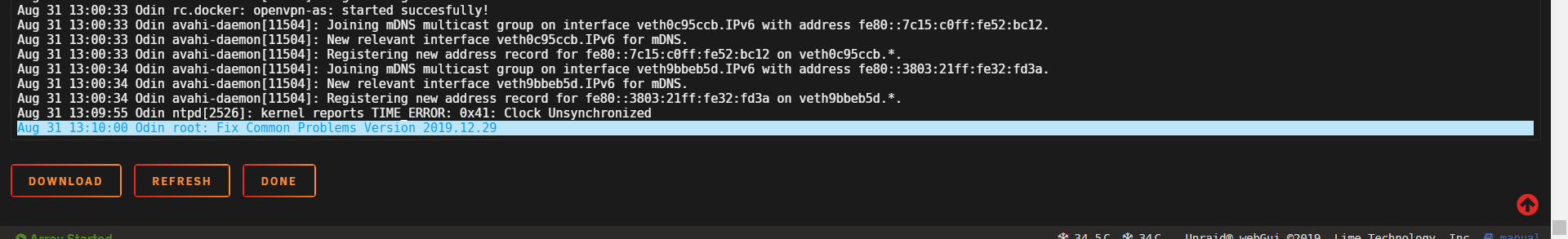

What is the time on your server? Post the last line in your syslog.
Wow? Talk about Clock Unsynchronized! How do I synchronize or fix?
Settings - Date and Time
You should go ahead and enable NTP so it gets its time from the internet.
Done and Done, it worked like a charm. You guys are the best, thank you!
