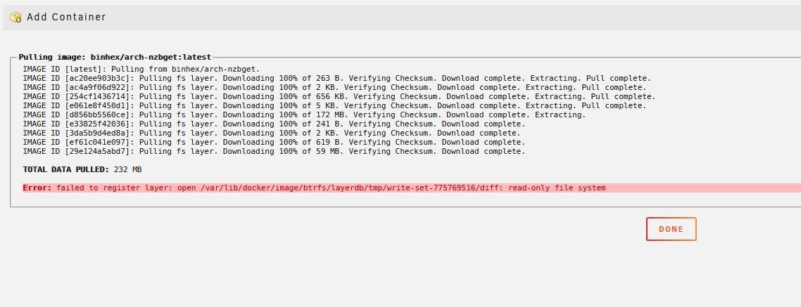

Another update....
If I reboot the PC I get about 10 minutes of use before FCP alerts me to the fact the cache drive has gone read only.
I was trying to rebuild my dockers after deleting and recreating the image but the install failed when the drive flipped to read only (see attached image)
This is bizarre
Edited by elnevera
added image
