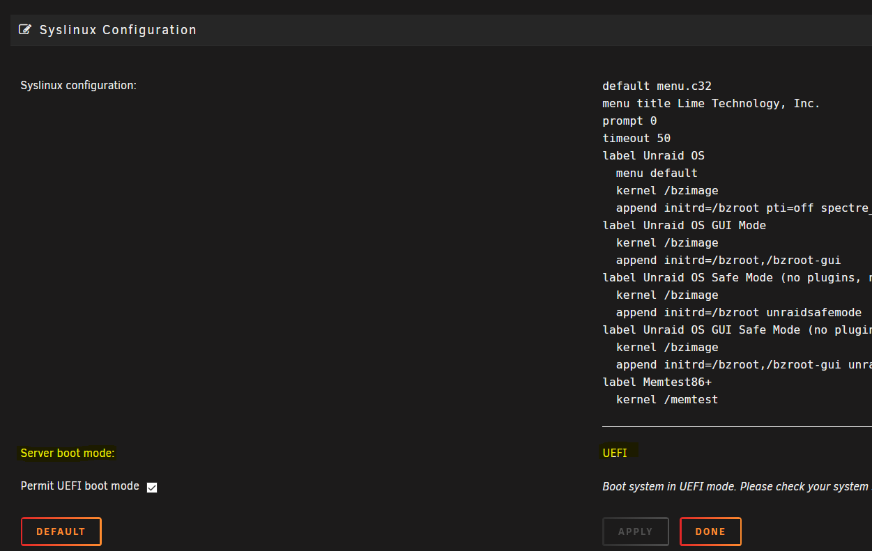

You can check in Main -> Flash -> Scroll down... (If you have a window where you can get into the GUI)

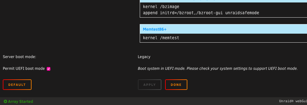

@1812 I managed to get into BIOS by connecting a physical keyboard/mouse/screen. Initially it wouldn't accept any input - so I did a complete power off (forced) and removed the power cable. Pressed power button to force a complete discharge and then powered on again and this time I could use keyboard... so I looked in BIOS and there is no mention of UEFI boot - I remember reading somewhere that UEFI support is only available in G9+.
So as the machine has started again (with USB key plugged into mainboard) I looked in syslinux and it is set to legacy boot, but the "allow UEFI boot" box is ticked... so I will untick this... screenshot below.
I don't think this will be the final fix... but will reboot and see whether I get ILO keyboard/mouse back and indeed if it will reboot without going into a boot failure cycle.

If the system can't find the USB device to boot from, it doesn't have anything to do with unraid. Then it's something with your system. The bios is looking for a device that has the correct boot files/flags, but can't find any.
Looking at the screenshot of your UEFI setting in unraid you have it set to boot in UEFI, but as you say, your system doesn't support UEFI. Even though it might seem like it's a problem with unraid, the reason it doesn't boot then is that your system doesn't support UEFI.
