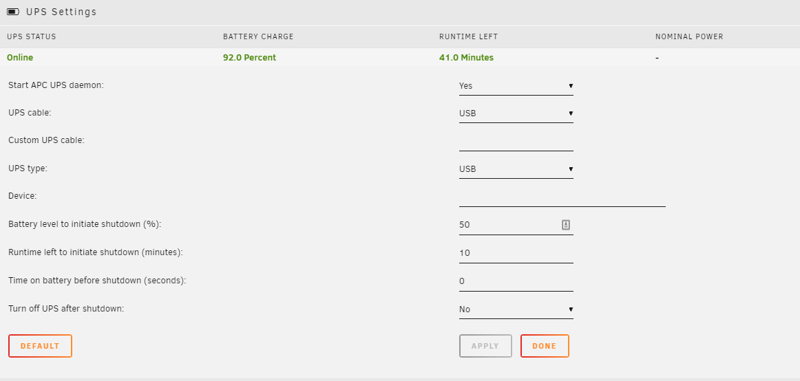

July 8, 20197 yr Author 2 minutes ago, Frank1940 said: First, I would suggest a test to see if that UPS/apcupsd work together. Set the 'Time on battery before shutdown (seconds)' to 30 and pull the plug and see if the server gets shutdown. Second, does Unraid actually send out e-mail? You can test this: Settings >>>> Notifications >>>> SMPT Settings and click on the 'TEST' button. Now in an actual power failure situation, you will have to have your network stay up and running until after the server has shutdown! You might be surprised at how many folks don't have the modem (or the router, or the switch) on a UPS! I have it set to 50% of ups or 10 minutes left. These notifications only send when the server shuts down? the SMTP works fine and sends email. I double checked my internet and it stays home when unplugged.
July 8, 20197 yr Community Expert I suggested that setting so you can see if it sends the notification on a power outage. (With your current settings, you could take a half-hour on battery before the shutdown started. ) I am pretty sure it only sends the message as a part of the actual shutdown sequence. So to check you will have to simulate a power outage, shutdown and let it finish. (By the way, this is the only way, you can be certain that it is actually going to work properly when the REAL thing happens!)

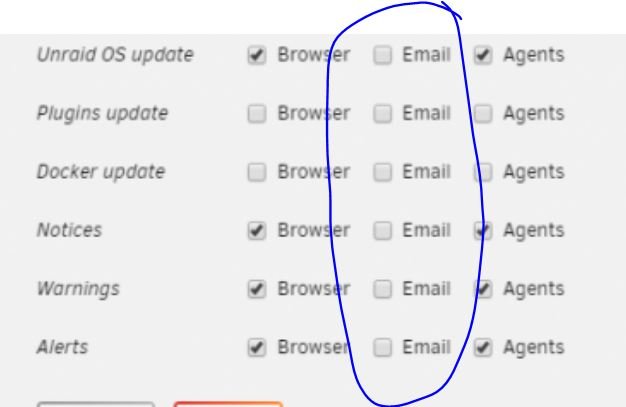

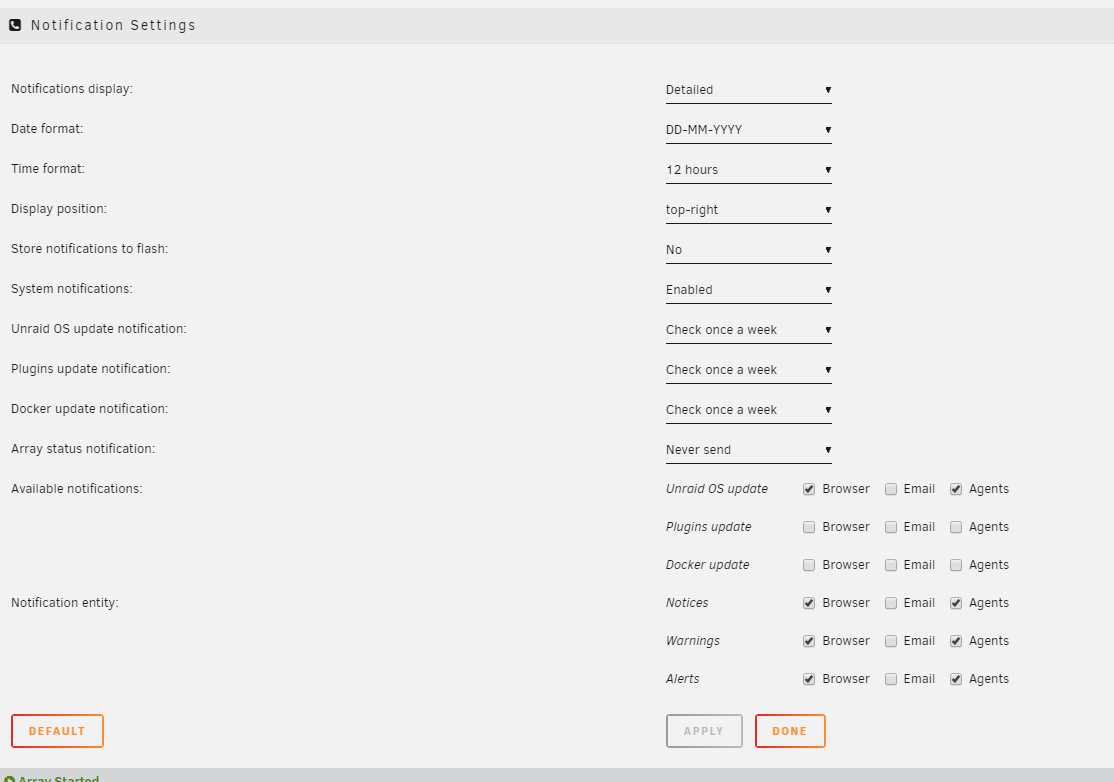

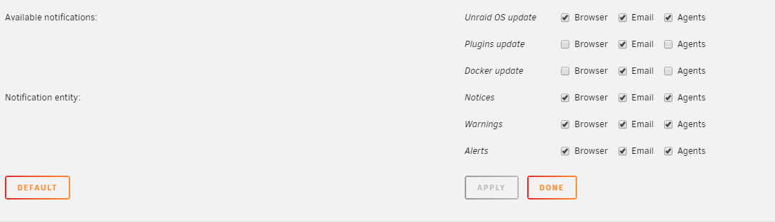

July 9, 20197 yr Community Expert 4 hours ago, scubieman said: Can you compare your settings to mine? I really would love this to work! Well, you don't have any of the email notification boxes checked - I'd start there

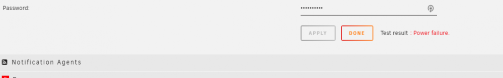

July 10, 20197 yr Author I enabled still not working sadly. I can send test email but after wards it shows below..

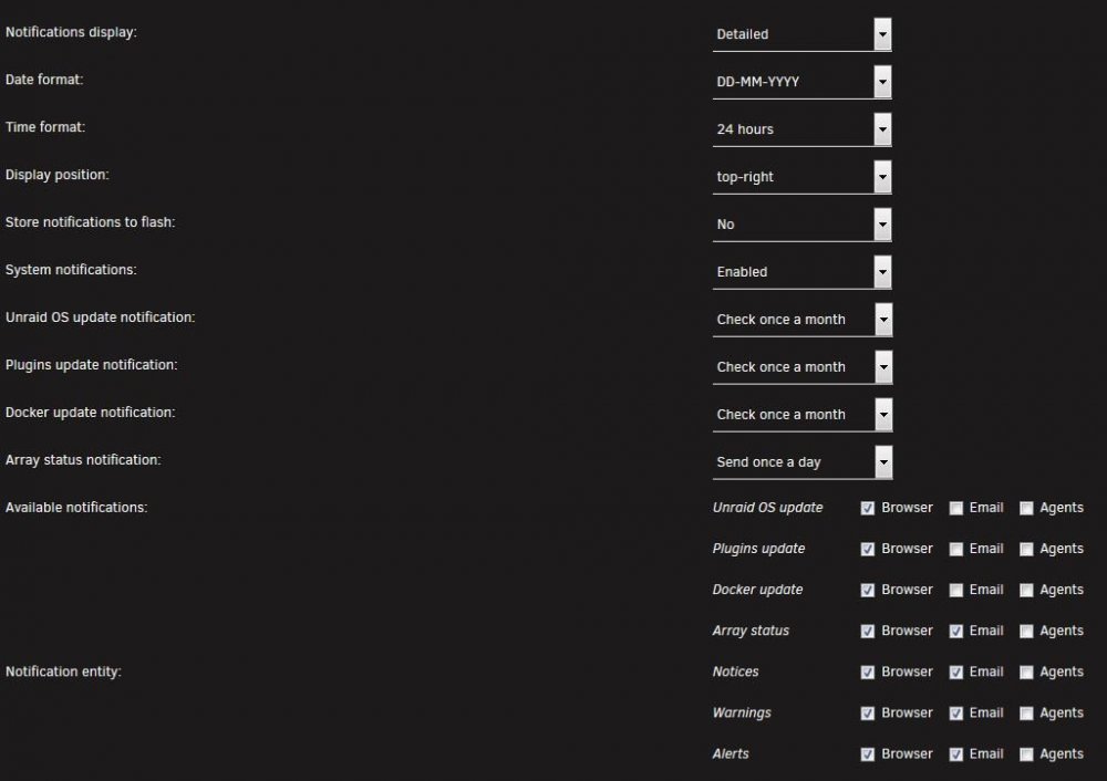

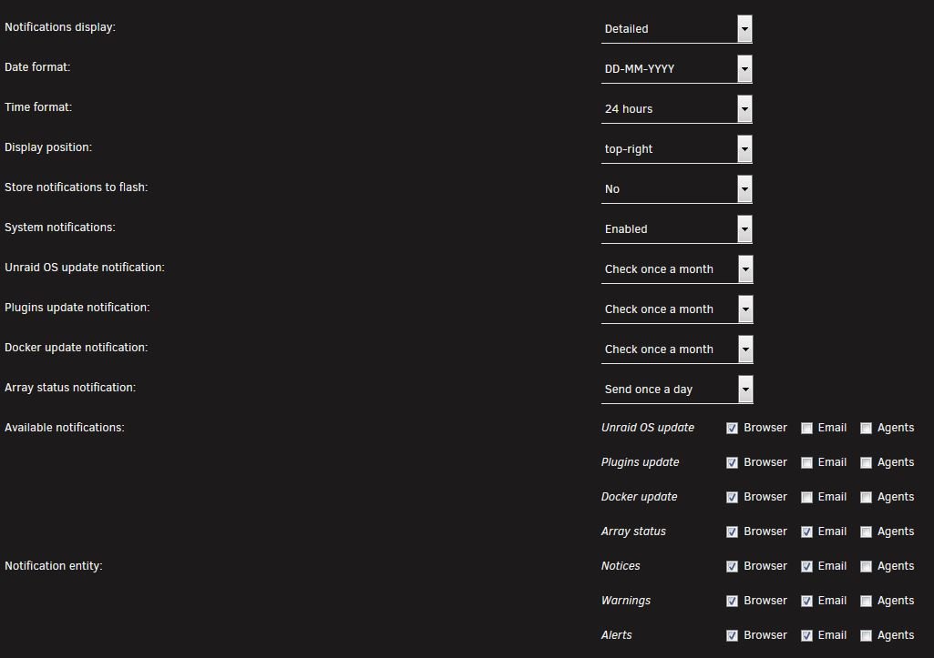

July 10, 20197 yr Community Expert The UPS is communicating its status You need to verify you're getting Unraid's notifications (like the array status when you log in) Here's how I have mine:
July 13, 20233 yr For anyone else that stumbles on here, I was not getting any agent alerts for power failures until I setup and enabled the email settings and checked those for notification as well. Now I get email and agent alerts (PushOver) when UPS goes on battery.
