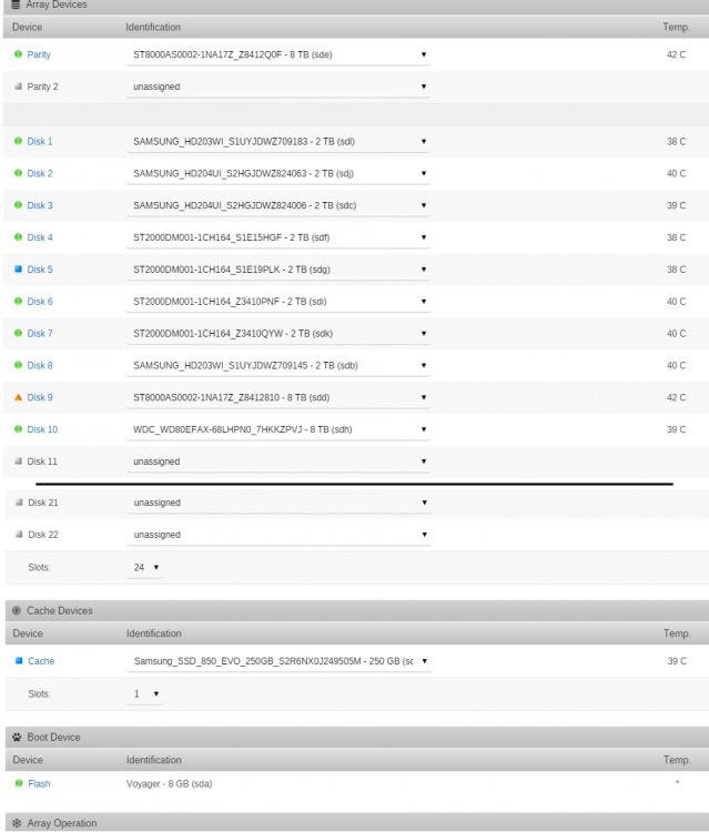

Now, I have all my drive OK exept 2 (disk 5 + cache) which is seen as "New Device". I think I can recover lot of data with utils.
And another one which is emulated (disk 9) (But the parity is broken, so... I don't know what to say.)
I think disk data are 99% okay (sysfile are certainly broken). But I don't know if I can explore them, because I cannot start the array.
What can I do to recover the most of data ?

Or, I can do following steps :
- remove failing disks from array, and remove parity disk (which don't work now.) => (1) I'm not sure how to do this. Just putting them "unassigned", then start the array ?
- Add the current parity disk like a new free disk, then copy a failed disk into it. => (2) using Unassigned Devices plugin ? Or putting the drive to copy like a Cache drive ? I don't know which works.
- Add this failed disk to array, formatting it.
- Copy the second failing disk into the array.
- Use this second failed disk like the new parity disk.
It sounds good ? [I know it's a bit risky because I won't have parity during operation, but I'm stuck.]
Another question => (3) : cache drive is seen like "New Device". It contains some important data. Will it be reset if I start the array like that ?

Yes, new config with parity sync is the option to use, assuming all data disks are OK.
Screenshot omits that part but as long as there no "data on this drive will be deleted" warning on the right of the cache device you can start, and there won't be one after a new config.
