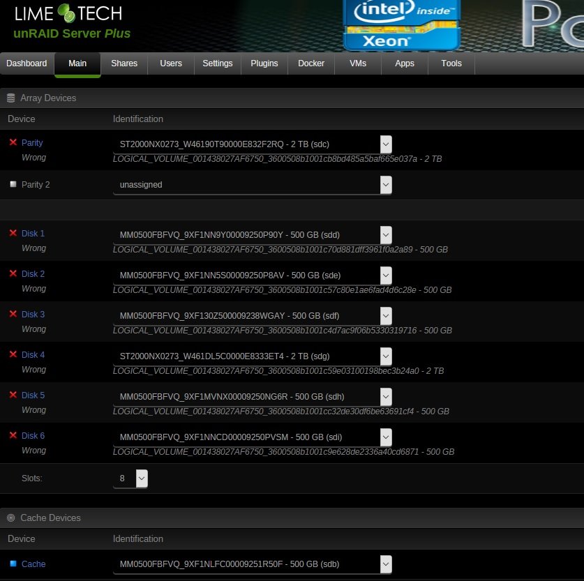

July 9, 20197 yr Community Expert Hi All I'm sure this is simple... but would just like some advice on getting My UnRAID server to recognise my existing disks. My server was using a hardware RAID card, which presented the disks to UnRAID as logical volumes and so each disk had a 'logical' serial number. I have connected my disks using an HBA, so UnRAID now sees the actual disk - but of course all the serial numbers have changed and so it wont start as there are too many errors. I have made sure that the correct disks are in the correct order (lots of photographs of disk serial numbers & screen shots 😉). To overcome this can I erase the old disk config and assign the right disks in the right positions so the UnRAID array will be accessible again? If so, how? Attached is a screenshot of the disks in the correct assignments. Many thanks in advance. Edited July 9, 20197 yr by SliMat Added screenshot

July 9, 20197 yr Author Community Expert I might have just answered my own question... just looking at the screenshot I spotted that the cache drive is not showing as wrong. When I fitted this I only inserted one disk (the cache), changed the assignment to the 'new' serial number and then powered off - inserted ALL the other disks in one go powered it on and assigned them. Thats where I am now... do I need to do them all one at a time and power cycle the machine?

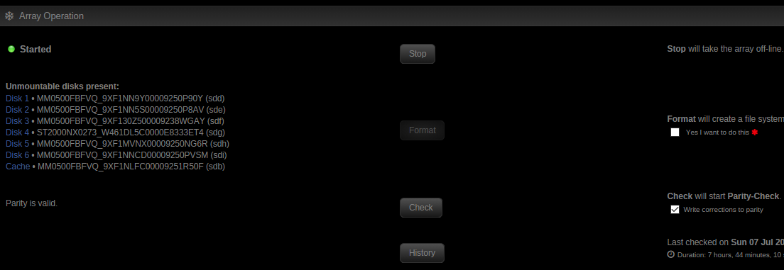

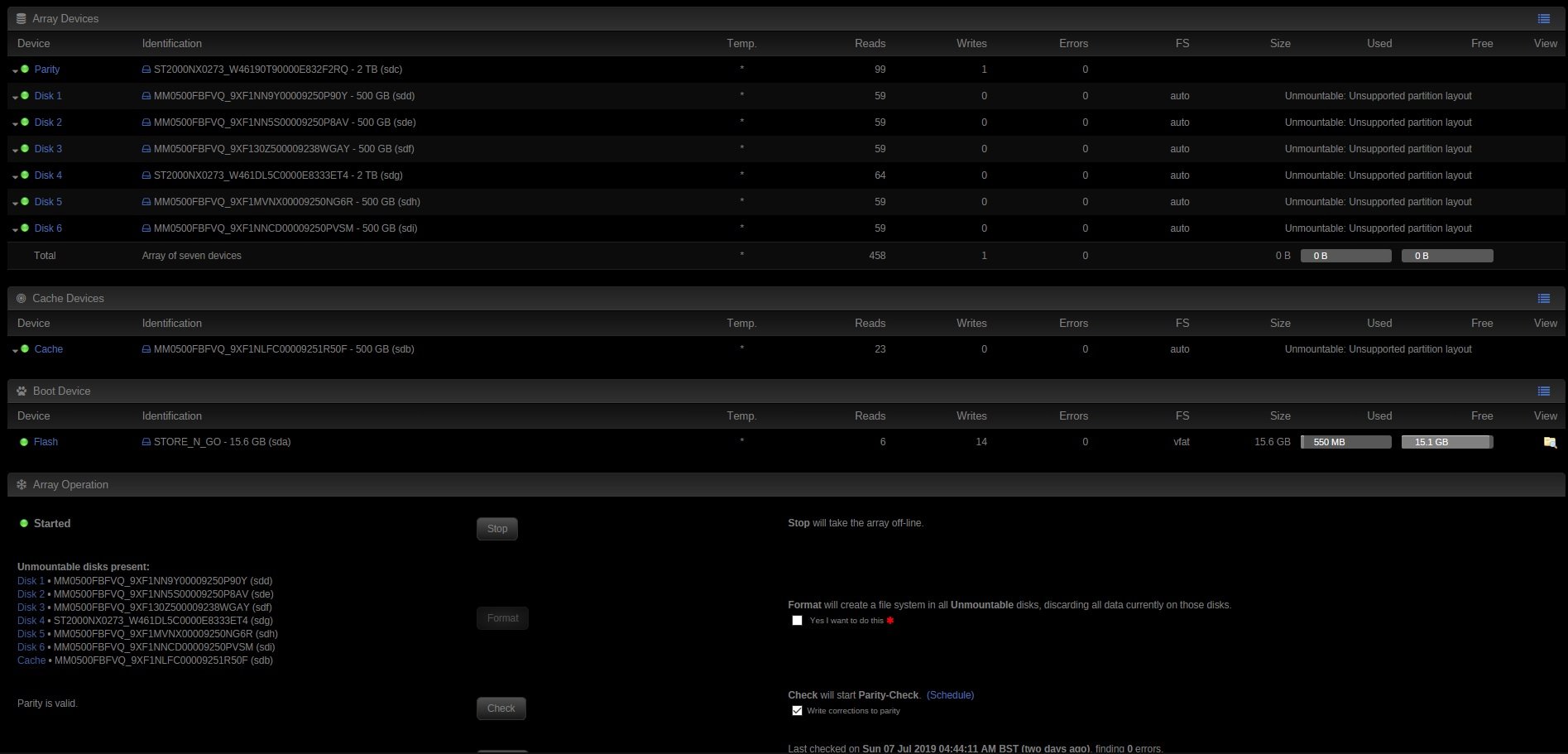

July 9, 20197 yr Author Community Expert 30 minutes ago, johnnie.black said: You need to start the array after the new config, if the disks are unmountable (invalid partition) don't format. OK - assigned and started... got this;
July 9, 20197 yr Author Community Expert Just now, johnnie.black said: Also don't forget to check "parity is already valid" before starting the array. Did remember that 🙂

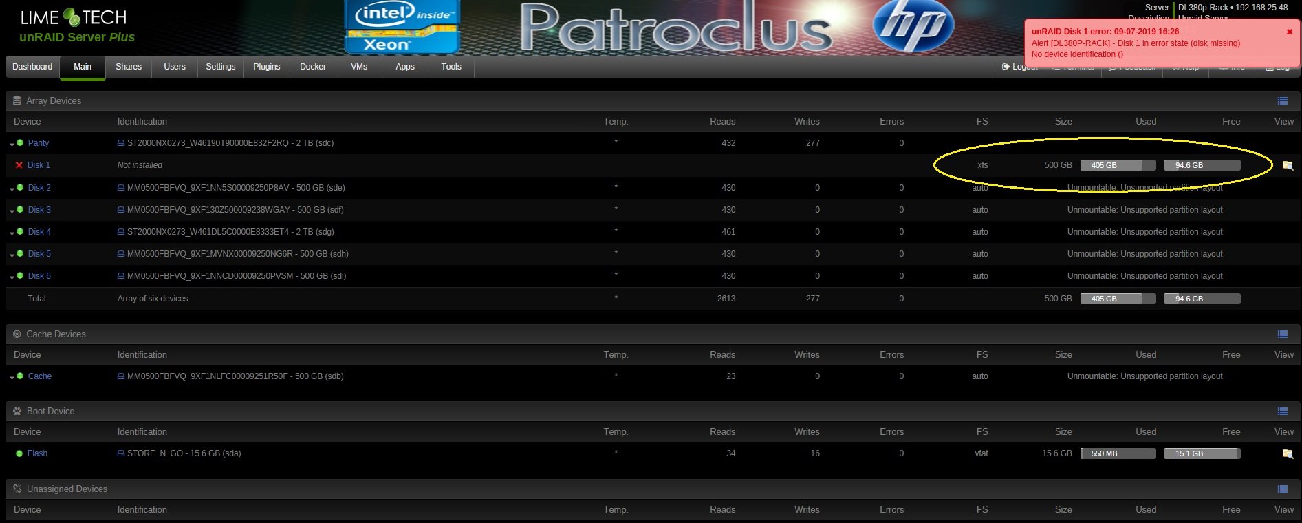

July 9, 20197 yr Community Expert Stop the array, unassign one of the data disks (set to none), start array, see if that disk mounts, if yes you can rebuild on top of the old one, then repeat for the other ones. For the cache drive you can unassign it, then mount with UD to copy any important data elswehre, it will need to be formatted.
July 9, 20197 yr Author Community Expert 34 minutes ago, johnnie.black said: You need to start the array after the new config, if the disks are unmountable (invalid partition) don't format. So... if I dont format, what now... I think I've got empty disks and have to format 😞
July 9, 20197 yr Author Community Expert 2 minutes ago, johnnie.black said: Stop the array, unassign one of the data disks (set to none), start array, see if that disk mounts, if yes you can rebuild on top of the old one, then repeat for the other ones. For the cache drive you can unassign it, then mount with UD to copy any important data elswehre, it will need to be formatted. OK - will try now... thannks
July 9, 20197 yr Author Community Expert 5 minutes ago, johnnie.black said: Stop the array, unassign one of the data disks (set to none), start array, see if that disk mounts, if yes you can rebuild on top of the old one, then repeat for the other ones. For the cache drive you can unassign it, then mount with UD to copy any important data elswehre, it will need to be formatted. OK, when I unassign and restart it shows as disk missing... stop, re-assign & start? Or will I have to format the whole lot?
July 9, 20197 yr Author Community Expert Interestingly I just noticed that considering it says all the disks are unmountable... its managed to retrieve disk 1's data usage... so is there a way to rebuild from this state?
July 9, 20197 yr Community Expert 2 minutes ago, SliMat said: Or will I have to format the whole lot? Formatting will delete all the data, since the emulated disk mount you can re-assign disk and rebuild, after it finishes repeat for the other disks one at a time.

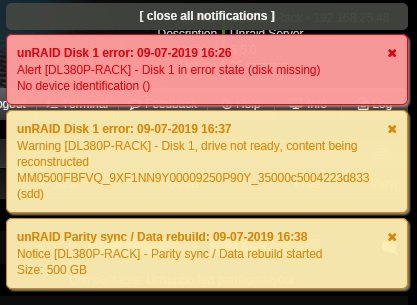

July 9, 20197 yr Community Expert Just now, SliMat said: so is there a way to rebuild from this state? Yes, that's the point of doing this, as already mentioned above.
July 9, 20197 yr Author Community Expert Wow - thanks thats great - I'll mount disk 1, rebuild and repeat... fingers crossed. The cache drive only had my active VMs on which I have backed up - so that should be OK. Many thanks for the help and as lond as the rebuild starts I'll come back and let everyone know that this works! Thanks
