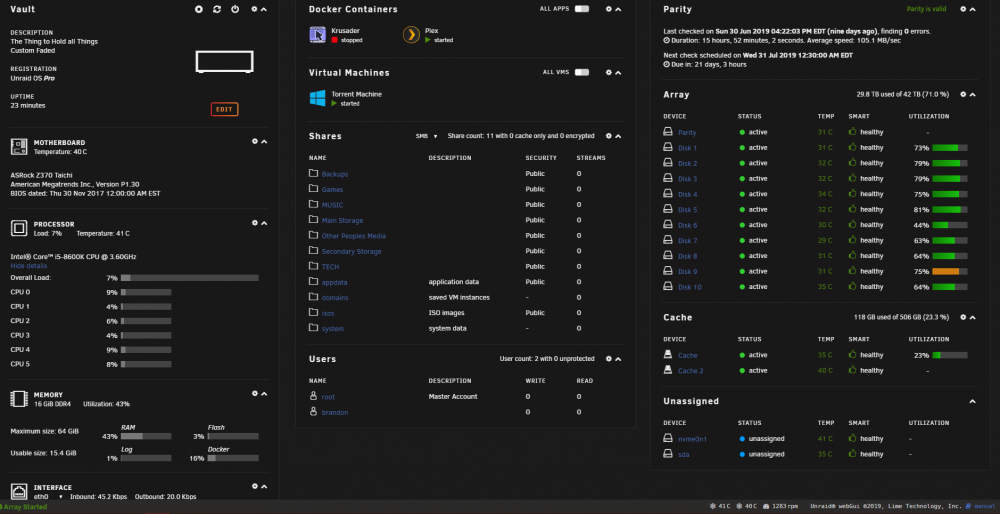

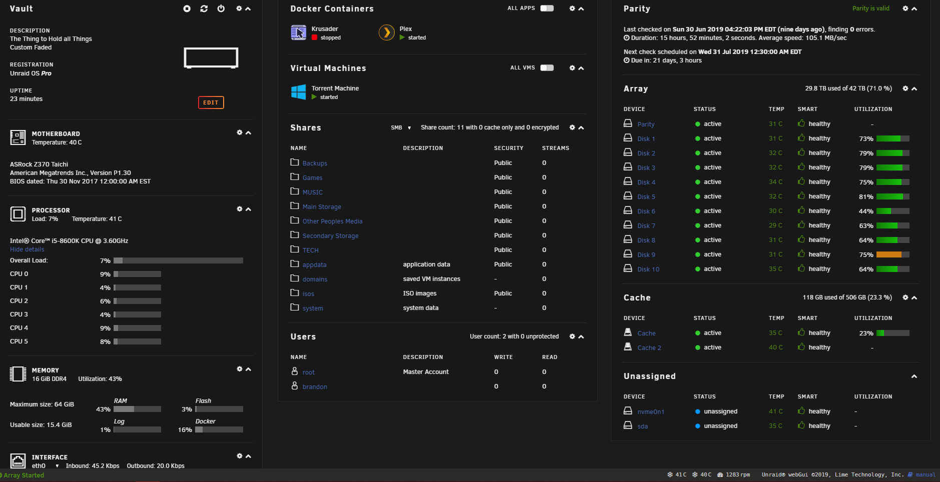

July 10, 20197 yr Hello, upgraded from 6.7.0 to 6.7.2 and I am experiencing higher than normal disk latency. a few things have happened since I upgraded. - spin up time of all drives seems to have increased - Plex (newest build) sometimes media just stops playing - Kodi on PC (17.6) there is a noticeable longer delay on starting media from a cold Unraid array (spun down) - I have seen latency in just moving around the directory structure also via SMB shares - also noticed a GUI delay also, just seems slower any feed back would be great. System Specs: see picture
