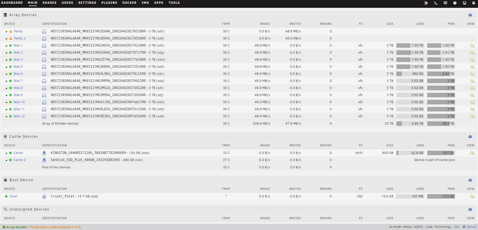

Post a full screenshot of the Main GUI page with the array started.
Hey J. Thanks for the fast reply. ss attached. I question this step as the drive is gone. Even raid card bios is coming up with something connected but blank SN. I don't have the option for including or excluding this disk 3 anymore which made me question that step. Perhaps it can be ignored if I'm removing a failed drive and I do the rest of the steps and rebuild the data from parity instead? Just want the clarification that my steps above will work or am I missing something? Cheers. BiGs.
Edited by BiGs
Your screenshot shows that data slot 3 is mounted and readable, you need to copy that data to another location before rebuilding parity. Look at the FS, Size, Used and free columns.

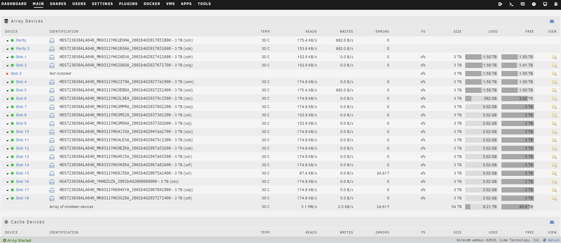

Actually you can!   When a disk fails Unraid will emulate it using the combination of the remaining disks plus parity.   Your screenshot shows that Unraid is still showing a disk3 with 1.5 TB used despite the fact the physical disk is no longer present.   You will find that you can access the contents of this emulated dirk.   If you were going to simply replace the disk then Unraid would rebuild the emulated contents onto the replacement disk so no other action would be required.
However you want to shrink the array and the New Config that is part of that process invalidates parity and thus the ability to rebuild a disk with its content intact.    You therefore first need to get the data off the 'emulated' disk before doing anything else or you will lose the current contents of disk3.   Once you have done that you can continue with the array shrink process.

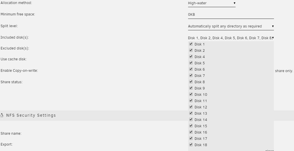

p.s Im confirming I did set global share settings to include all disks but 3 as per all the shares (as the emulated disk3 doesn't show up in include or exclude)

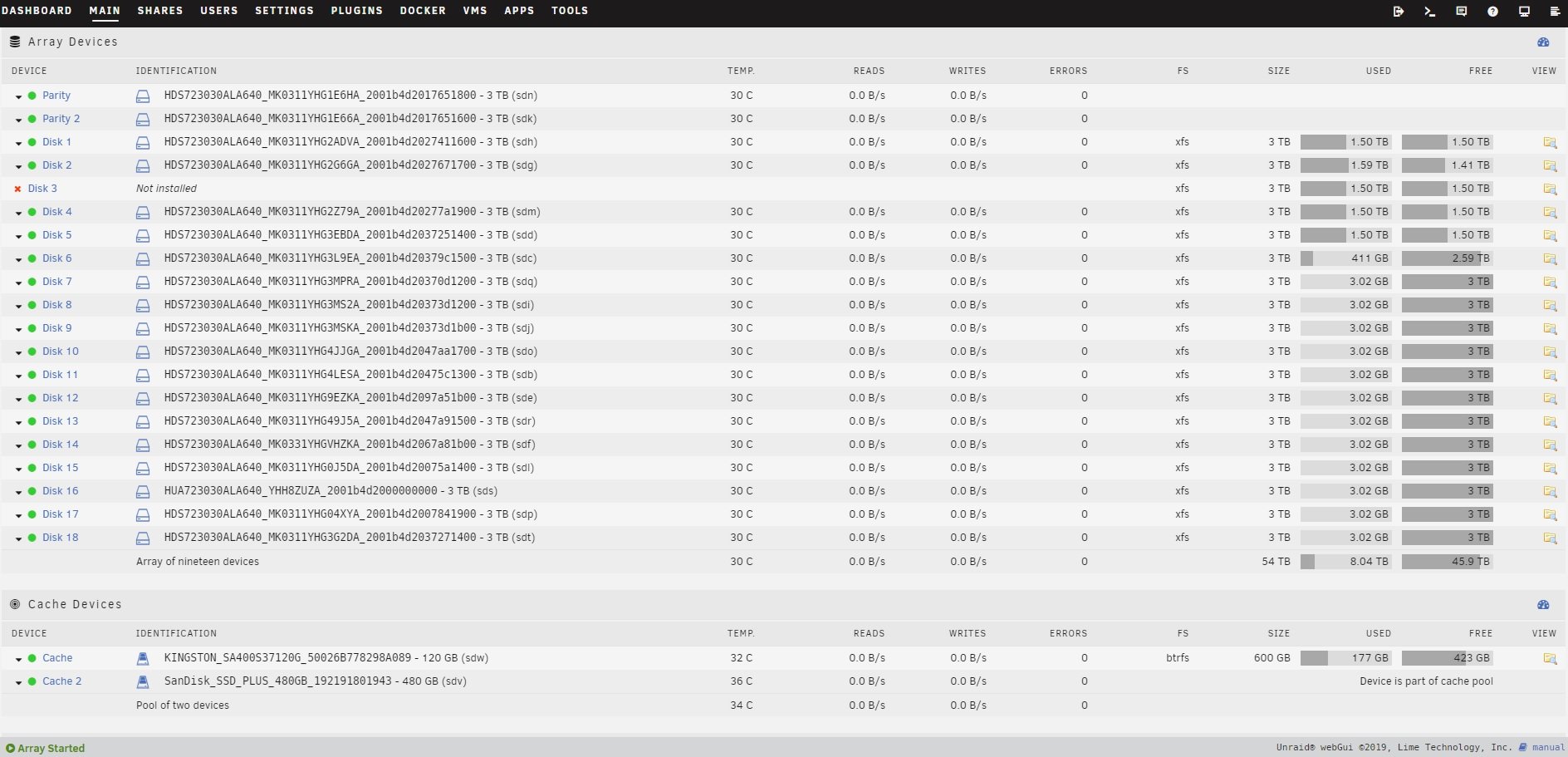

So I've xfered 1TB since. It is dragging parity from the empties too so yeah prob good to remove most of them. I've got read errors on disk 16 now too. So ill pull most of the empties out after removing them and test them on my desktop.
