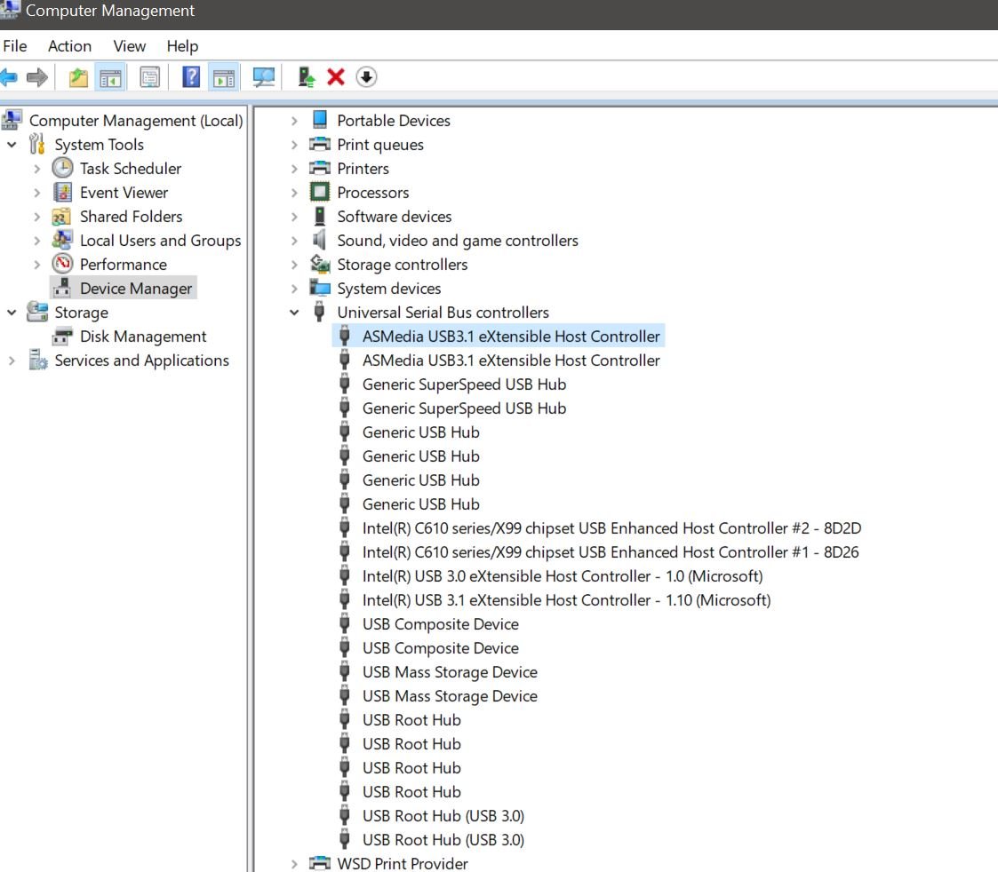

x99 deluxe 2 mobo, with 2 usb controllers. (shows in device manager as separate controllers, and I have a thunderbolt card if needed)

OK ...talking to myself a little here... but I just loaded Unraid onto a flash drive and booted it up.  it appears that I DO have multiple USB controllers and they are in seperate IOMMU groups. Im not exactly sure how they map out, so I am going to start moving things around and figure out what usb port goes where.
