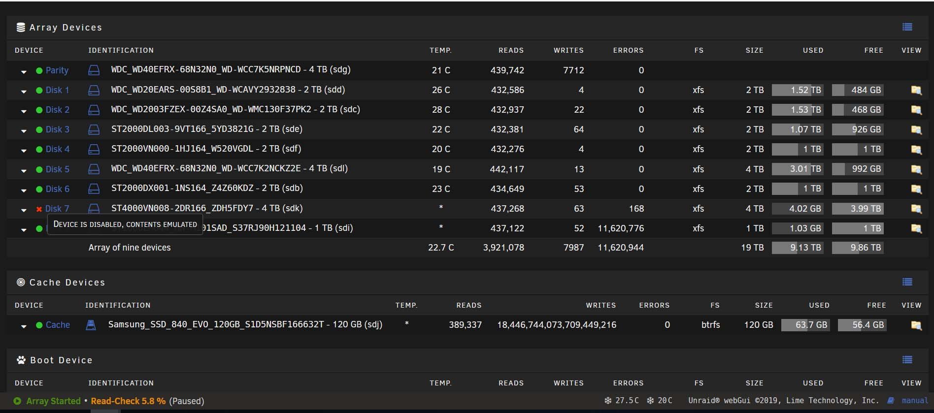

July 11, 20197 yr Hi, I'm hoping to get some help on a corrupted(?) drive array... My server setup is as follows: - 4TB Parity Disk - 8 Disk array (ranging from 4TB to 1TB, total of 19TB) - 120GB SSD cache drive - 250GB SSD unassigned array The cause of the problem: While I was at work, my kids unintentionally turned off power to my unRaid Server (I know :)). They turned the power back on but things were not good... The problem: The drive array came back online, but one of the disks (Disk 7) was showing as unmountable (I think that was the term). After a few reboots, Disk 7 was shown up in the array with an Orange triangle symbol and the description "Contents Emulated". I tried a parity check but once it reached about 20% I got ALOT or errors. When I say alot, I mean > 15,000,000. But they are coming from 'Disk 8' which is listed with a green light. Needless to say I canceled the parity check. I thought maybe Disk 7 was damaged during the power interruption, so I swapped in a new drive I'd bought, stopped the array, loaded the new drive into the Disk 7 position, started the array, formatted the new disk and a parity check began automatically. Unfortunately, the same thing happened... after about 4% of the parity check, the errors started coming thick and fast (>1,000,000 when I stopped it) - again from Disk 8 (listed with a green light). I have attached a screenshot or my array Main page. Disk 7 is still listed in the array as "Contents Emulated" with a red cross next to it, and all the other disks have green lights next to them. All the dockers seem to load ok, but I'm a little unsure as to whether all my data (movies, tvshows, music, etc) in intact. My array is obviously listed as "Unprotected" due to the missing drive. Is my array hosed? Can anyone offer advice on how/if I can get a new drive into the Disk 7 slot? Can I swap out Disk 8 and rebuild the array (i.e. with 2 new disks in)? Do I need to just start from scratch again? What diagnositics can I provide? Any advice would be much appreciated. Cheers, Rich
July 11, 20197 yr Community Expert Go to Tools - Diagnostics and attach the complete diagnostics zip file to your next post. You really should have asked before attempting anything, since everything you did was wrong. Parity check won't really do anything but a read check when you have a disabled, emulated disk. Is that the latest screenshot? From what you said here 2 hours ago, rich110 said: formatted the new disk and a parity check began automatically. probably not. 2 hours ago, rich110 said: Is my array hosed? Most likely, it was not doing a parity check after you replaced and formatted, it was doing a rebuild onto the replacement disk. But since you formatted it, it is going to rebuild a formatted disk. Your only hope is if the original disk is still good. Maybe it will be possible to recover the data from it. We will wait for the diagnostics and probably some additional questions and answers before making any recommendations.

July 11, 20197 yr Community Expert Disks 7 and 8 have dropped offline. Check all connections, power and SATA, both ends. If you have a free port, you could also put the original disk7 back in unassigned so we can take a look at it too. After that, post new diagnostics.
