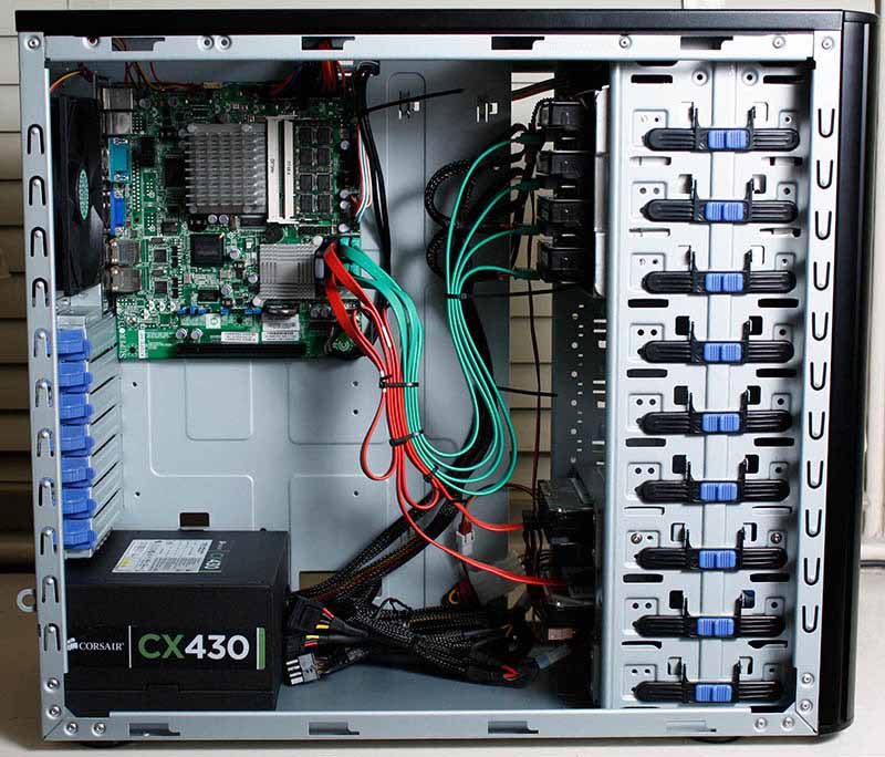

I just finished putting together my new build.  It's a Supermicro X7SPE-HF with 2GB of RAM.  So far I have 3 WD20EARS (2TB) drives in the array with no parity.  Pins 7-8 are jumpered on all drives.  I mounted a 1TB drive that has a bunch of stuff to populate the array and am in the process of copying files over.  Using mc I'm seeing on average about 30MB/s.  Copying to the array across the network I am seeing about 40MB/s and reads are around 20MB/s.  Am I just expecting too much out of this Atom or does this seem really low?
Pics or it didn't happen right ;D
