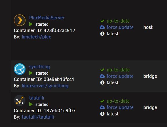

Only run 3 dockers Plex, Syncthing & Tautulli , only ever access server from same desktop and always logout when finished. Mines happens every day at 1am

52 minutes ago, coblck said:
Same here gonnae start disabling dockers 1 at a time and see ( i only run 3)
What containers and repos do you run?
